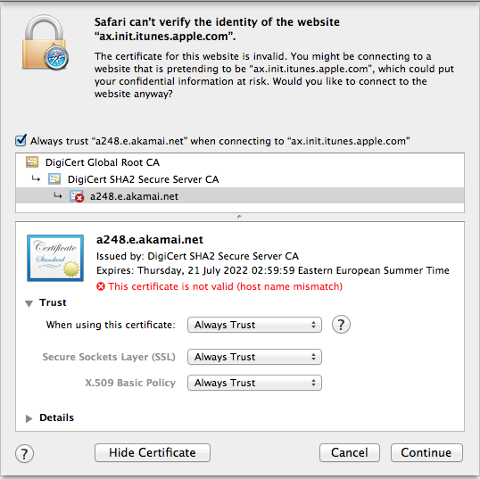

Interestingly, when going to ax.init.itunes.apple.com in Safari via http (which is what's implied by port 80 showing up in all network traffic control and monitor utilities such as Little Snitch and Proxifier) and got
An error occurred while processing your request.
Reference #102.5761645f.1637711593.1571d60d
When trying to open URL as "https" I get the certification trust alert
Upon marking it as always trustable the connection is denied with the wording
Access Denied
You don't have permission to access "http://ax.init.itunes.apple.com/" on this server.
Reference #18.eb30cc3.1637711696.82886b1

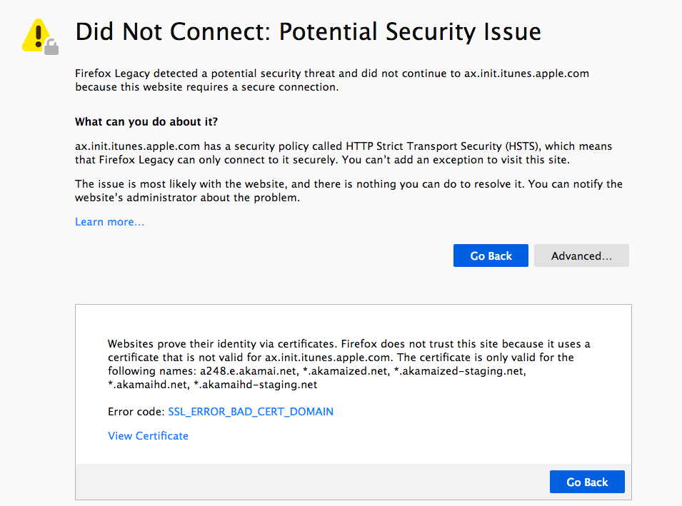

Firefox Legacy
outright blocks the access and won't offer any options to override at my disposal. Even adding the certificate to the list of exceptions in the certificate preferences won't allow it.
If it's all down to revoked certificates can it be hacked around to let the server think the peer uses a valid version of the certificate, I wonder?
