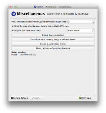

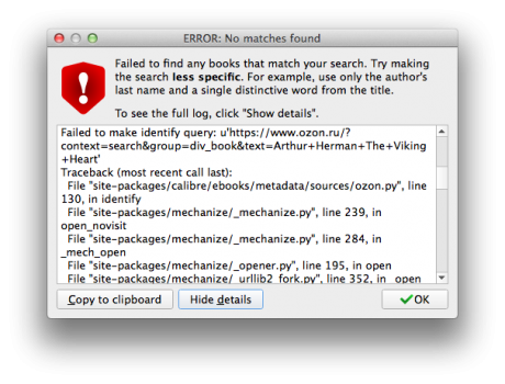

Does anyone know how to make Calibre.app work with this proxy? It's failing all connections when downloading ebook metadata. I've tried excluding it's server from the proxy's System Preferences and pointing it's own SSL cert file to the squid.pem but it's still not working.
I've been perusing the Mobileread Calibre forum for suggestions but can't find any that work. Any ideas would be appreciated!

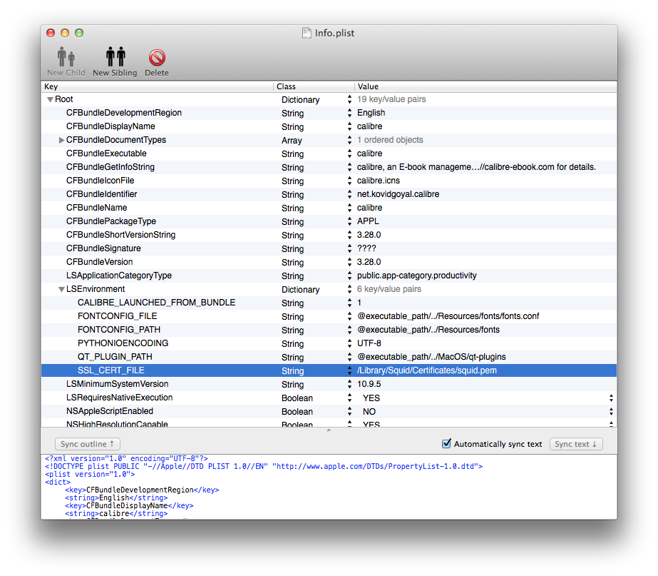

I do not detect anything strange. I have uninstalled and reinstalled. And I keep taking the opportunity to navigate with Chrome 65 ;-). But the websites hosted on Coudflare keep detecting me as "hacked" and asking for capchas ;-). Obviously that doesn't happen with Chromium. He also asks for them with Safari 9
You need to set a --no-proxy-server flag for chrome so it uses the keychain, then install the 'ISRG Root X1' certificate separately.
