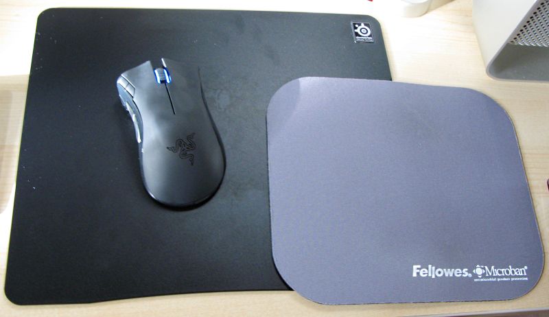

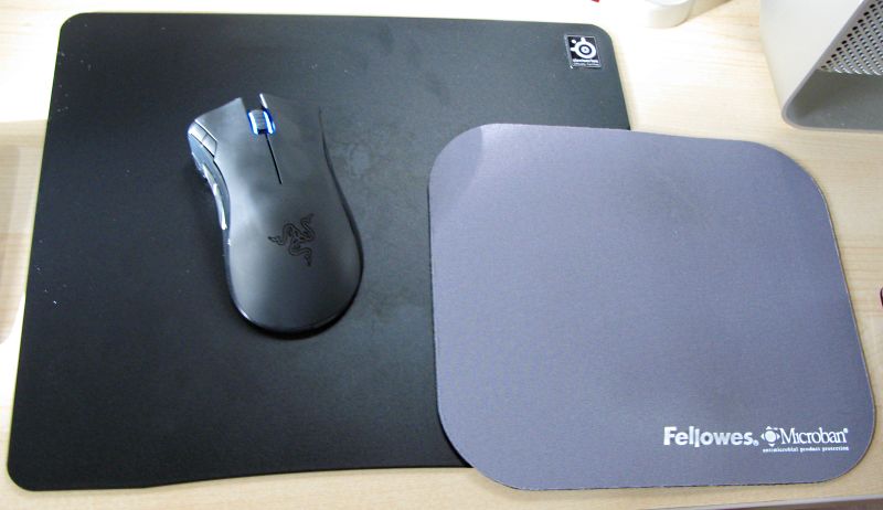

I got my Steelseries SX pad today and it's really nice. It's big. Mouse slides across it with just enough smoothness for me but it comes with some feet you can add just in case. Has a firm grip on the desk with the rubber underside.
Razer talks about this some on their website, regarding the way people like to grip mice and that the Mamba (like the Deathadder) is palm grip type. I already considered myself a palm grip person but the Mamba is even more so. There's a very noticeable difference in the comfort and performance of the mouse when you have a real proper grip on it. With the MX Rev I could never really grip quite wholly. The Mamaba is a better fit. The huge Steelseries pad helps with this because you can make more sweeping, whole hand movements.

My Steelseries came in today - you're right it is BIG. Construction is great, but it doesn't work with my wired MM. Might have to upgrade.😀
