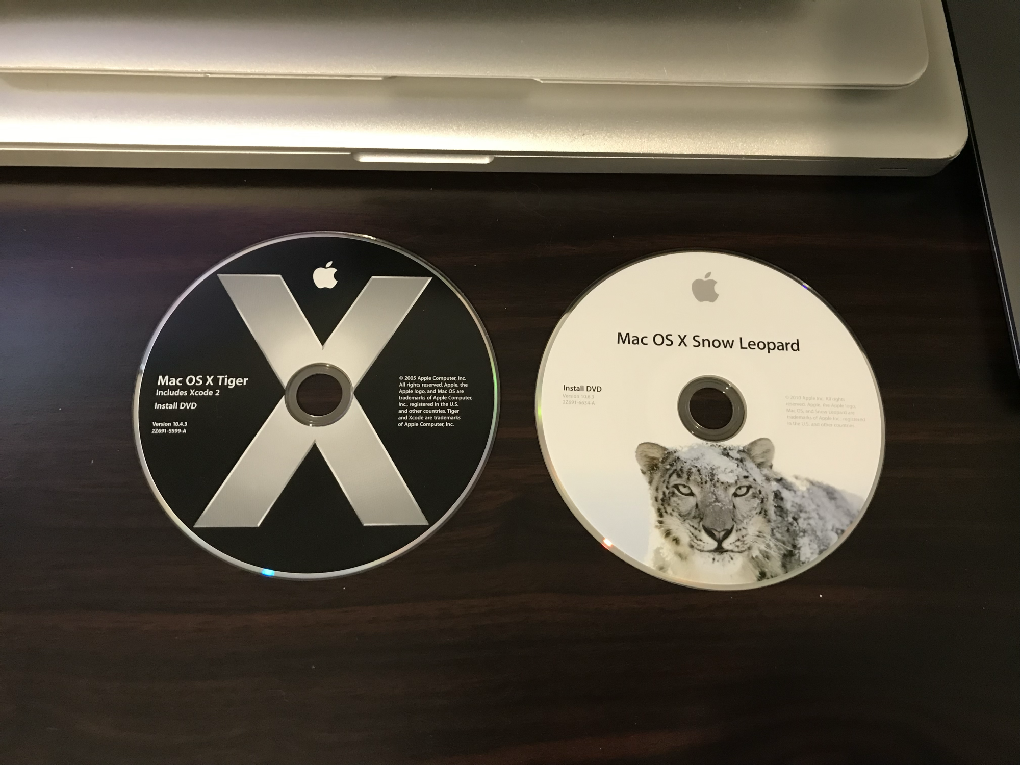

This Mini also came with a genuine pressed Tiger DVD. Now to discover what is stuck inside the drive...

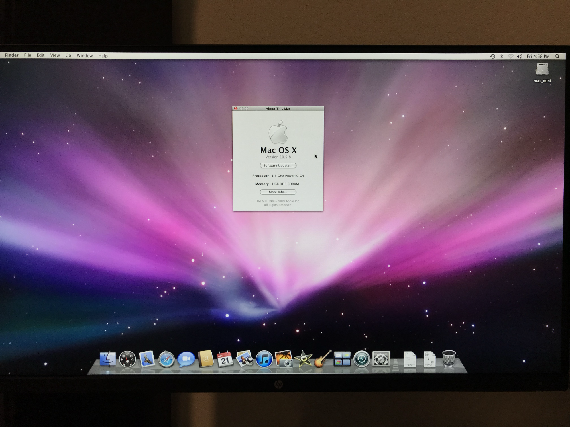

That’s a very happy accident. If you’re collecting rarities, that’s one to have. Enjoy!
I was actually pretty shocked to see 1.5GHz as Apple never distinguished the 1.42GHz from 1.5GHz in the information on the bottom of the Mac or on the box. Besides that, it's somewhat rare so I didn't have any hopes of finding it. I don't think that 800mhz really makes that much difference but this has been full of surprises.

I couldn't eject the CD and it wasn't even detected within the system. I ventured inside again to check the connection and just like the RAM it was not fully seated. I started and heard the disc drive whir. I pressed eject and expected to find an OS disc and what came out was but wasn't what I expected. See below/right.
I think this is the point the last owner just gave up and switched computers.

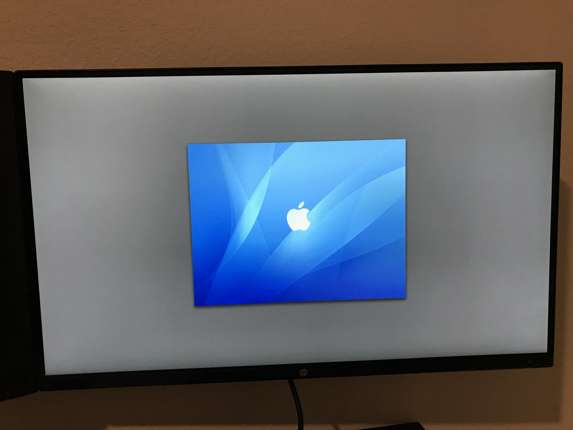

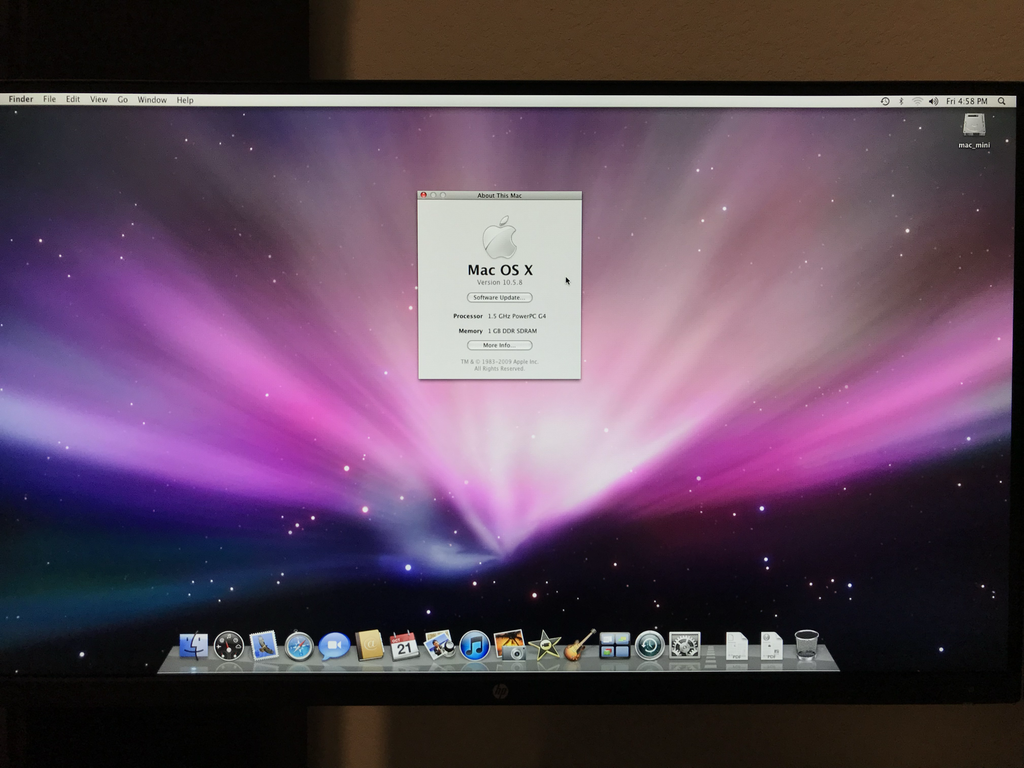

Thanks to our friends at OS9Lives, I have now been able to load OS 9, Tiger, and Leopard on this Mini tonight. I plan to swap Leopard for Sorbet Leopard.
You guys have any more suggestions? My only real goal is to keep the OS' accessible so that I always have "a Mac for that" and to keep the filthy Amiga fans from defiling yet another classic.

I've never cared for Leopard on anything without CoreImage support, but obviously that's not an option on the G4 mini.
It's OK. I already have Sorbet Leopard! That's three OS' on this new work-horse.

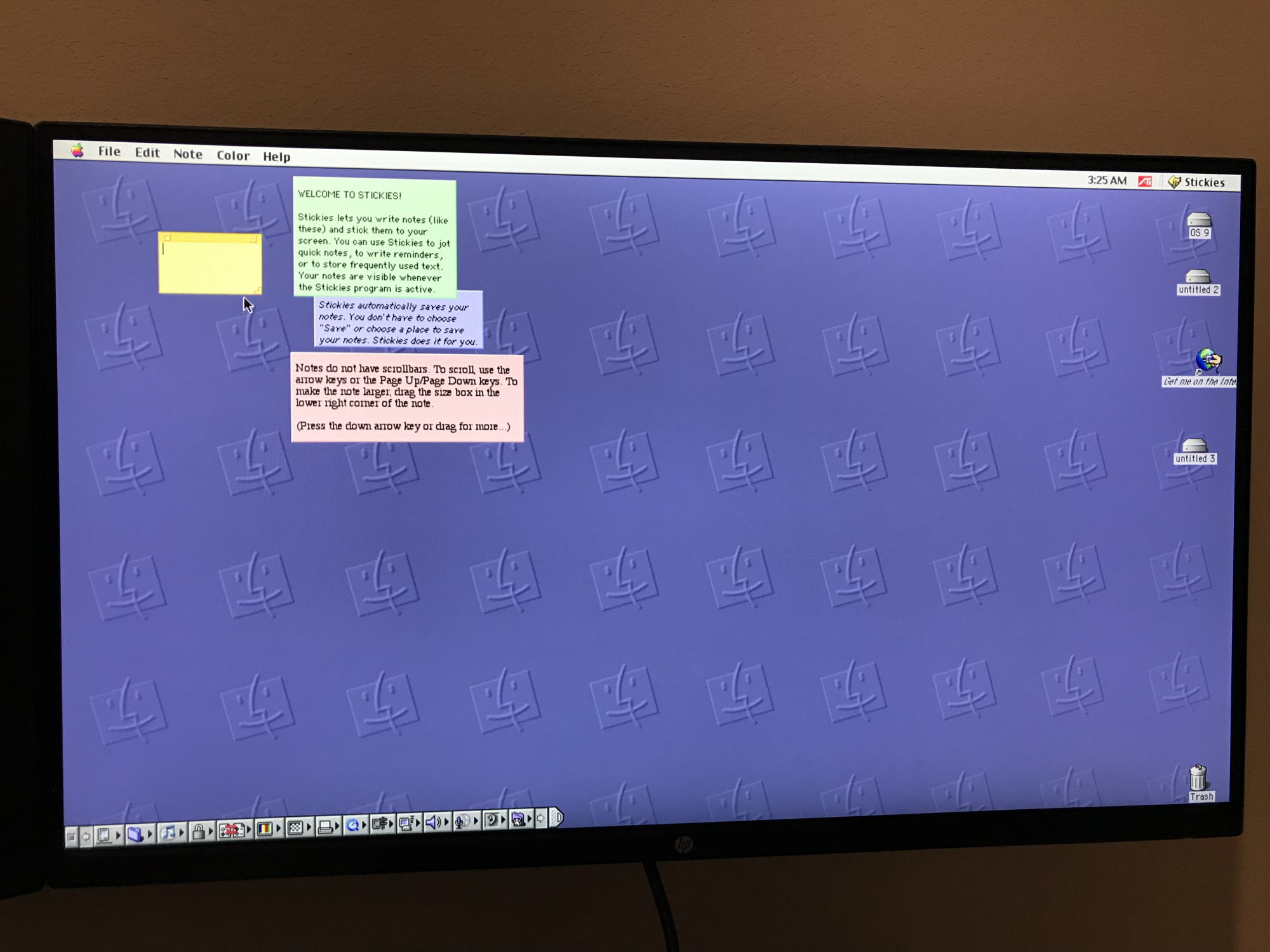

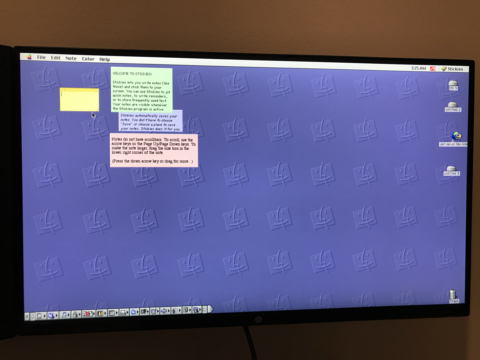

I've got OS 9 booting just fine. A few issues, though, if anybody can help. I can not get any audio out of the AUX. The "Speaker" tab is grayed out and if I adjust the Volume it just snaps back to zero. Secondly, my control strip is in the middle of the display, height-wise. How could I adjust it?
While it us a good find there was no accident involved. By limiting your search to 64MB VRAM you also limited yourself to the 1.5 GHz model as all 1.5s have 64 and vice versa…..
Now install MorphOS and browse the web with Wayfarer to see how useable this toy can still be today😉
Click and drag holding the option key to move the control strip.
I understand that these forced OS9 installs lose audio on some models - you'll need a USB audio dongle - but if you're true to your LED on a motorbike analogy that won't be allowed 😉

Well, we have 10.6 for PPC. The only thing left is backport CoreImage from 10.6.8 🙂
Which won’t help if the GPU, such as the mini’s, doesn’t support Core Image.
…which is still Leopard. 🙂

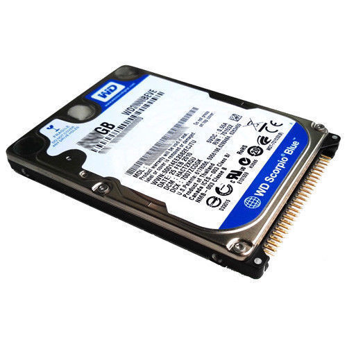

If you’re interested in having a speedy spinner, the 2010 Samsung HM160HC and WD WD2500BEVE are the ticket. 5400rpm but still the fastest 2.5” ATA drives out there.
If you want something period-correct, the 2005 Hitachi 7K60 was the first 7200rpm 2.5” ATA drive to hit the shelves. I had one in my G4 mini and it was much better than the stock 4200rpm thing.
I had both the Samsung and the Hitachi mentioned at different points and can confirm they were both excellent spinners 👍
And if you want the most storage and don't want to go the mSATA +adapter route, this is your best bet
This was the largest capacity IDE 2.5" spinner ever produced. There are still a few sellers left on eBay, mostly from China. Just pick the cheapest one closest to you if that is your priority.
Perfect! I knew it was possible to move the strip but forgot this one simple trick!
Why is USB audio unkosher? They had plenty of adapters in the OS 9 era. Besides, peripherals are not "mods". I don't have to ride my bike on contemporaneous roads to get "the experience".
And I'll come back to this post when I'm ready for the upgrade. I won't wait until the drive fails. I'd rather just know it's going to work.
