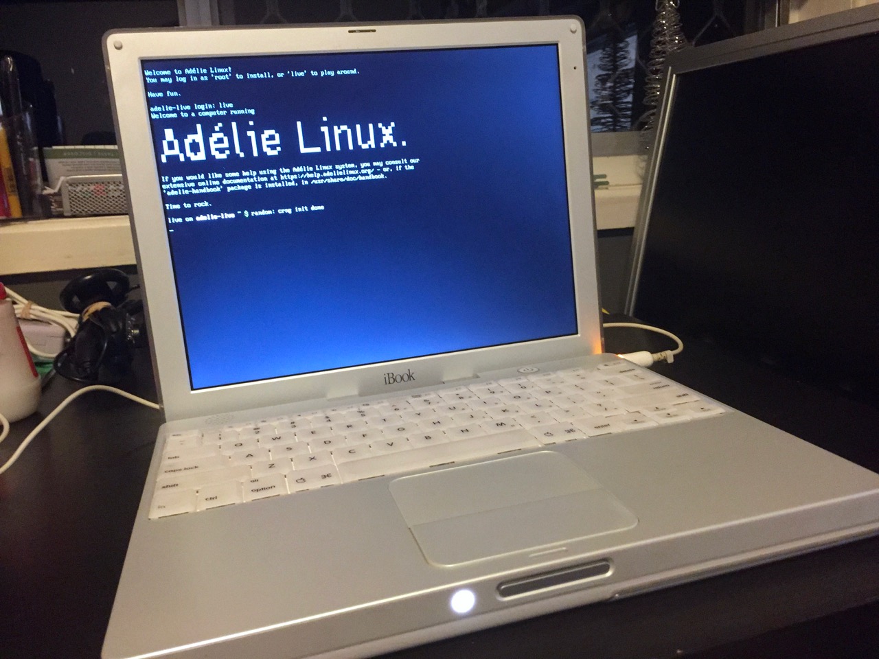

Booting from the Full Alpha6 ppc CD on my iBook G3 500. So far so good.
Something very cool, which I haven't seen before - the sleep light is programmed to flash on drive activity.
Gentoo and SUSE also use the sleep light as a drive-activity indicator, on other Linuxes you can turn it on by writing to the device

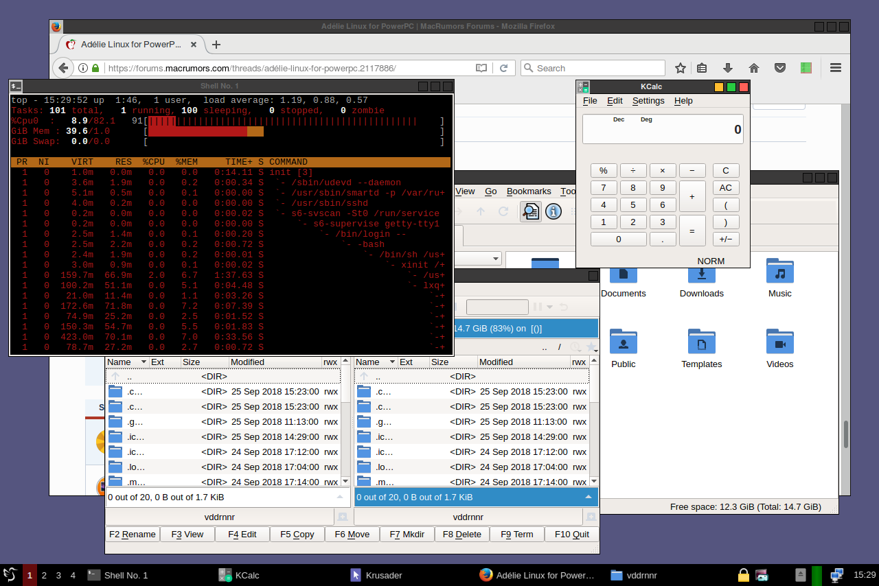

Looks interesting, will take a break from my current Atari 130XE fetish and have a go on it also.
Any interesting current software availability, Firefox ?
Hi Lastic,
For x86 and ppc ( not ppc64 ) you have firefox 52 esr.
From the tests i did with vmware ( 1 cpu, 1Gb RAM ) it's very fast.
The only "desktop" I got running almost perfect is lxqt, but as far as I found
listing the available packages you have: KDE, XFCE and Fluxbox.
You also have openbox ( should be possible to use with KDE and Is a requirement for Lxqt ).
Best regards,
voidRunner
Nice one, that's the same laptop I use for G3 testing!

Hi all,
Finally had some time to work on it ( using beta 1 )
Well it's alive :)
Sort of....
I'm having a few problems:
- getting sddm/xdm working on boot ( doing startx after boot works, I'm using lxqt )
- getting sound working ( it's there but says only headphones and I get no sound )
- hardware sensors not detected
- radeon acceleraion not working ( everything seems to be done in software )
Everything else is working.
I'm typing this message with it.
Best regards,
voidRunner
