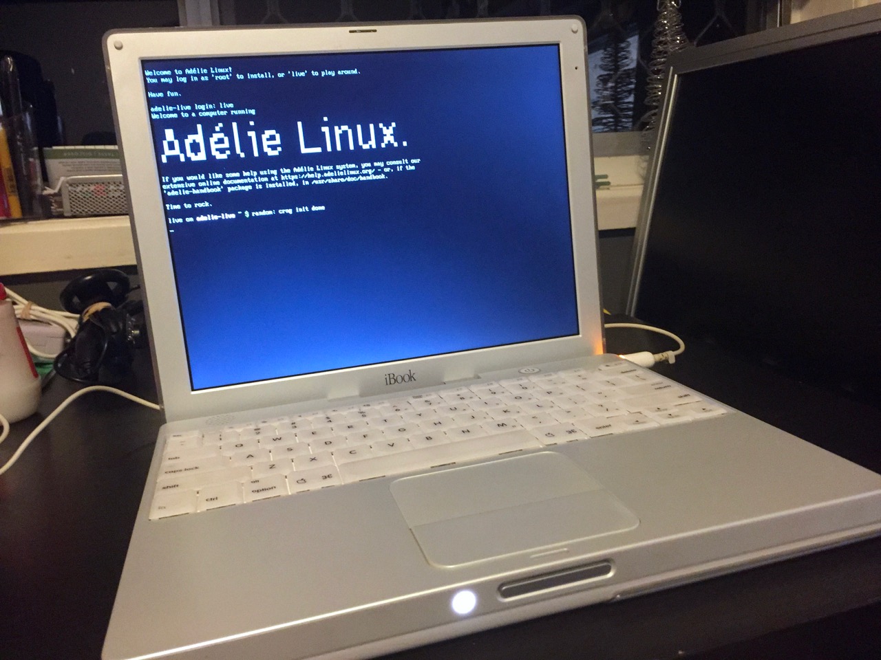

Booting from the Full Alpha6 ppc CD on my iBook G3 500. So far so good.
Something very cool, which I haven't seen before - the sleep light is programmed to flash on drive activity.
This is uhh... completely off-topic, but I don't ever see a sleep light on my iBook. It doesn't have a battery and only runs OS 9 and is the first revision of the new case design. Am I supposed to be seeing one? xD
