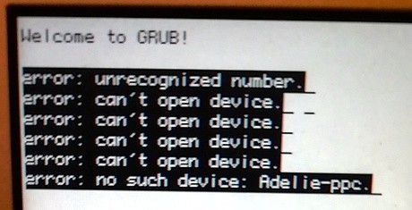

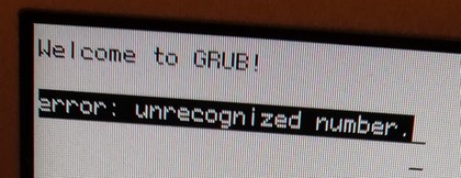

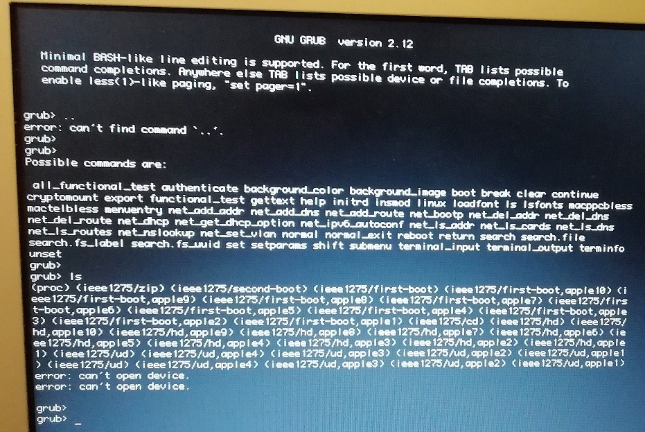

Ok so a little more info on the situation here (see prev posts) :
1- error messages :
2- GRUB screen : (I've done an "ls" out of curiosity)
3- Adelie Linux (KDE) mounted ISO contents + grub.cfg file contents :
I see a discrepancy b/w the mounted ISO folder name "ppc" and the cfg file apparently searching for "Adelie-ppc" (3rd spoiler), incidentally I do get an error message "no such device Adelie-ppc" (1st spoiler)...
Also the "--hint cd,apple2" in the cfg file, wondering whether "cd" stands for compact disk, therefore ignoring the usb thumbdrive as a potential location (but then again no such file or folder with the name "Adelie-ppc" anyhow).
Maybe I should try to rename the "ppc" folder to "Adelie-ppc" and see if it works, but I'd be surprised that the Adelie team could have missed such an obvious mistake.
Update: tried the above mentioned trick but didn't change a thing, still getting same error messages including "no such device Adelie-ppc" (but I expected that).

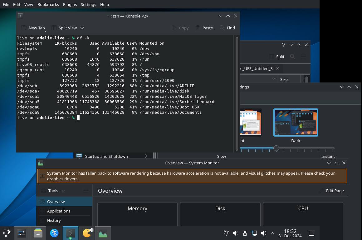

And... finally got Adelie Live (beta5, KDE desktop) to run on my Alubook ! :D
Very thankful to the Adelie team for their efforts to keep the PowerPC platform alive and kicking. 👍 👏
Obviously many issues to sort : wifi chip not recognized, Bluetooth neither (strange since there is "Bluetooth [Ok]" message at bootup), 2nd screen not properly recognized, keyboard mapping not right, no graphics driver installed yet (cf image), etc... and a lot to learn about the KDE desktop of course.
Glad I didn't give up too early, and btw sorry for the occasional ranting (or monologue) here. ☺️
