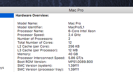

Apple documentation says that you need to install 10.13.6 before upgrading to Mojave. So, you will need to upgrade to High Sierra with your old card. High Sierra EFI flasher needs a Mac EFI GPU to upgrade your BootROM.

• Mac Pro (mid 2010 and mid 2012 models) must first be updated to macOS High Sierra 10.13.6 before updating to macOS Mojave. (41798700)
Mojave installer rejects any non Metal cards, so you will need to remove the HD5770 for the install part.
Thanks tsialex!
So I guess I'm ok then:
That means I could go directly with the upgrade, without having to reinstall my old card right?
...I've already installed HS in the past which is why I have the newer Boot ROM, but reverted back each time because I wasn't fond of the experience. By the way you may be aware of the "slow boot time" issue with HS on APFS, how is it with Mojave so far? Genuinely curious, I've read somewhere on another forum that with HS and APFS, trimming occurs every time during the boot sequence, slowing down the whole process compared to previous OSes...
Yes if you have a Mojave supported Metal GPU. Some Metal supported GPUs like RX480 seems not yet supported for the firmware flash.

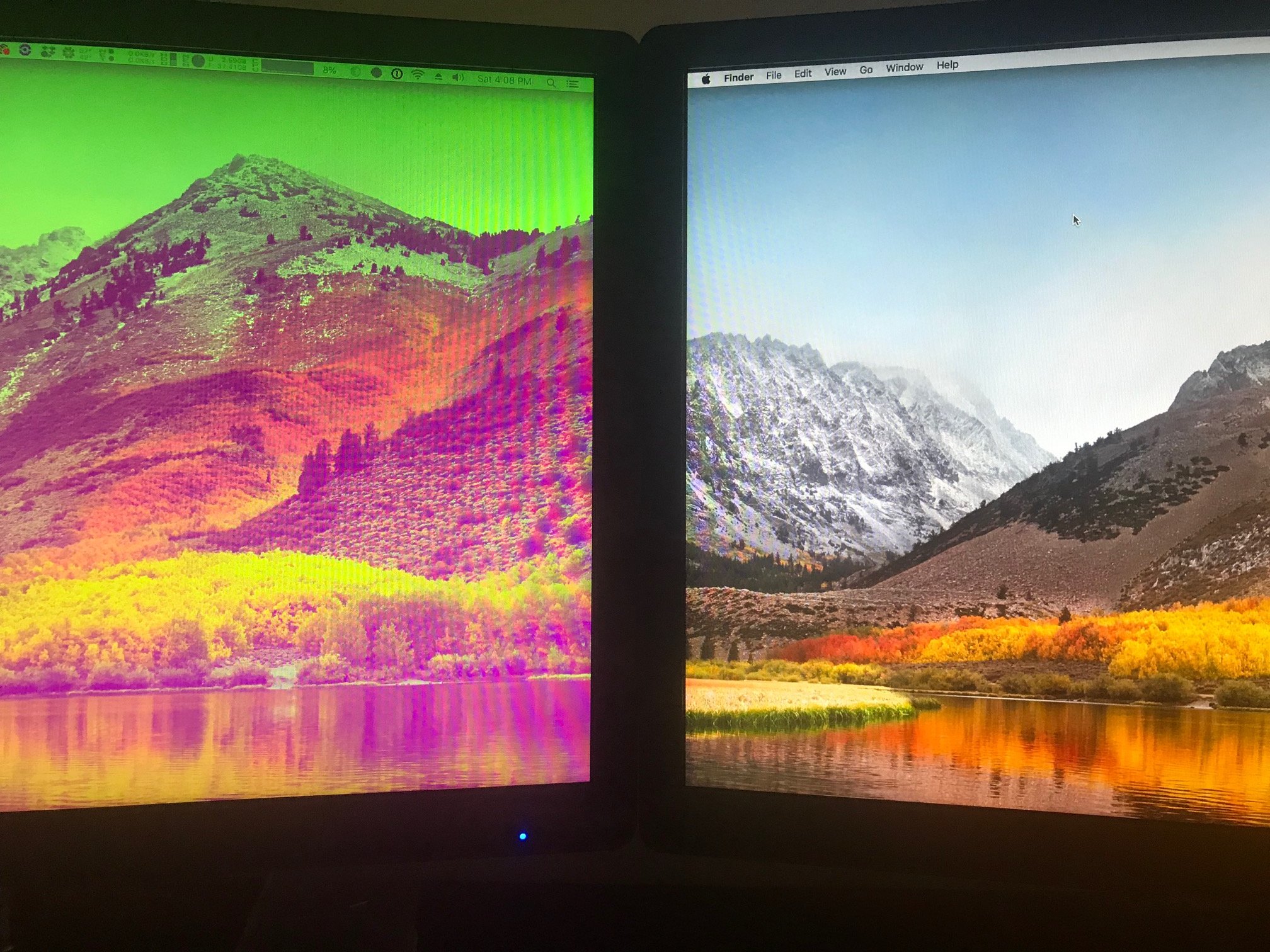

ok here's a weird one: right after installing High Sierra (10.13.6)
monitor on the left is on DVI-to-HDMI
monitor on the right is on HDMI
Left one has gone pink/purple! (I noticed that as soon as the OS installation started as the Apple logo/progress was on the left)
Everything appears to be normal with the card.
I've already swapped my cables, both monitors are fine - if I put the left one on the RX 560's HDMI output the image is perfectly fine, then the right one turns pink with DVI.
This did NOT occur with Sierra obviously.
Since the last few minutes I've read several reports of the same behavior, both on High Sierra and Mojave. Some just say to use the DP port instead. Any solution before I go buy a DP->HDMI cable tomorrow?
