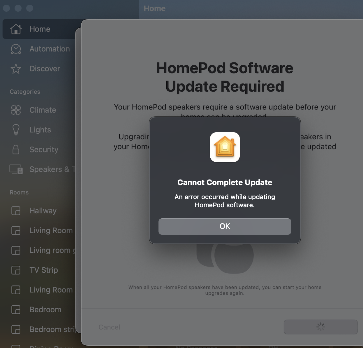

My set up is still saying "Cannot complete Update" "There are no available HomePod updates" even though every single thing I own is now updated

In case anyone runs into similar issues... I reset the HomePod mini and added it back, now im getting a new error:
I'm guessing that the update option is only visible to home owners and not home admins? Can anyone confirm?

I have the same problem.
Everything in the house is updated (all Apple TVs and HomePod minis) and then I still get the error that it can’t upgrade HomeKit until I update my HomePods.
I have screenshots that I would share with Apple but I can’t find anywhere for HomeKit support and the HomePod support wants me to call or visit a tech bar.

I found what I think is *my* problem anyway, and it’s kinda weird but - it worked.
As always, YMMV
I have a second home that was also set up in HomeKit, all that home had was Hue lights.
I had already removed it from my Home app - it didn’t show in the app itself.
However in the “Home settings” the other house still showed up - even though it was not selectable in the app itself.
So I removed the other house from Home Settings and then I was able to do the upgrade.
Also - I had found this earlier, it didn’t seem to fix the problem but I’ll mention it here - I also had a really old AppleTV showing up on my iCloud, but we don’t use it anymore. It’s literally in a box in the closet. But iCloud showed it as on OS 15.4.1 and associated with my account. I removed it from my account. That didn’t fix the problem - but who knows.
Ultimately it sounds like two things:
The “upgrade” is *really* picky.
The error messages erroneously say HomePod updates needed when maybe it’s not actually the HomePod that needs an update.

This was it! I have an app that creates a blank new home every time I open it. Once I deleted it, I was able to upgrade. Hooray for people on the internet! Thanks!

ah! this seems to have allowed me to update. I deleted other “homes” that didn’t have anything in them, once i had just my main home showing, i was able to upgrade
Thank you!!
Same problem. Removed all my homepods. Ran the architecture update. Reinstalled the homepods (stereo pair OGs and one mini), and it all works fine now. Seems like a lot of fuss. This new architecture better be able to fry eggs.
