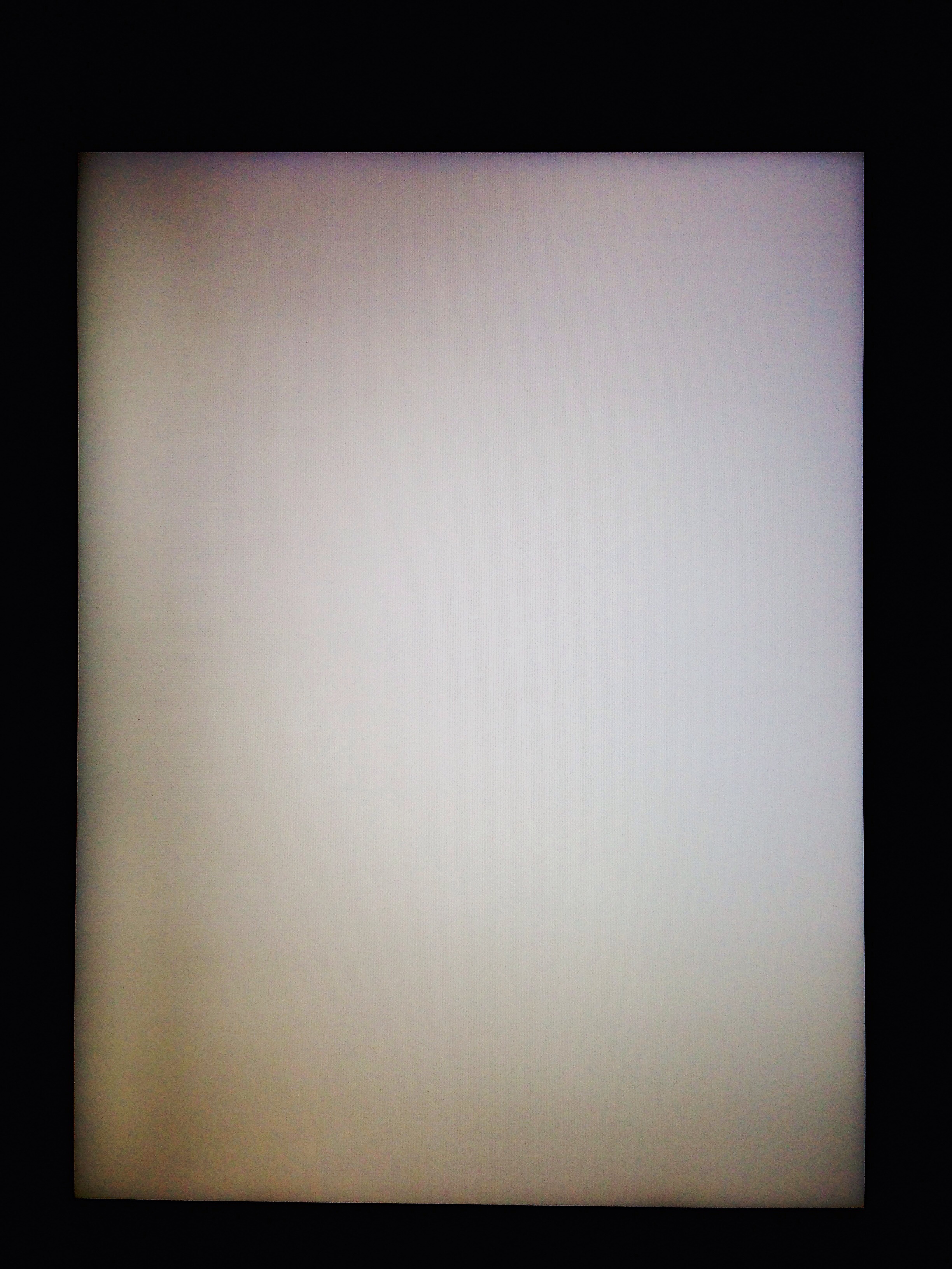

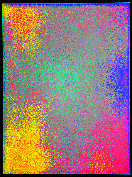

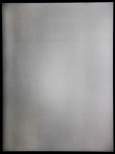

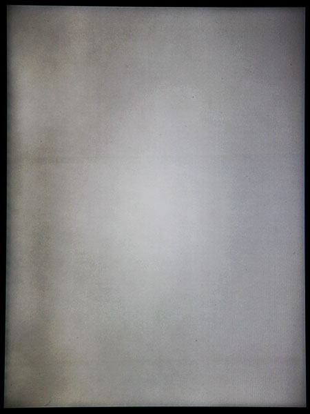

Here are some pictures that illustrate the problem. I took photos of my second and third units in a dark room using a Canon 5D Mark II. Pure white pictures displayed with brightness maxed out. It was immediately apparent from my camera screen that there was a darker stripe on the left. Increase the contrast in Photoshop it is even more obvious. As for color shifts, I max out saturation in Photoshop and the result confirms what I see with my eyes.
iPad Air, my first replacement, increased contrast
iPad Air, my first replacement, increased saturation
iPad Air, my second replacement, increased contrast
iPad Air, my second replacement, increased saturation
What I would suggest is that someone use some professional measuring device (like the one in the AnandTech's review) to measure the dE values of the screen at different positions. Then we will have a better idea of how good or bad the screen really is, compared to other IPS panels used in other places.
WOW, fantastic post mate, you've summed up my issue perfectly. Does your serial number (on all 3, if you remember the other 2) start with DLXL?

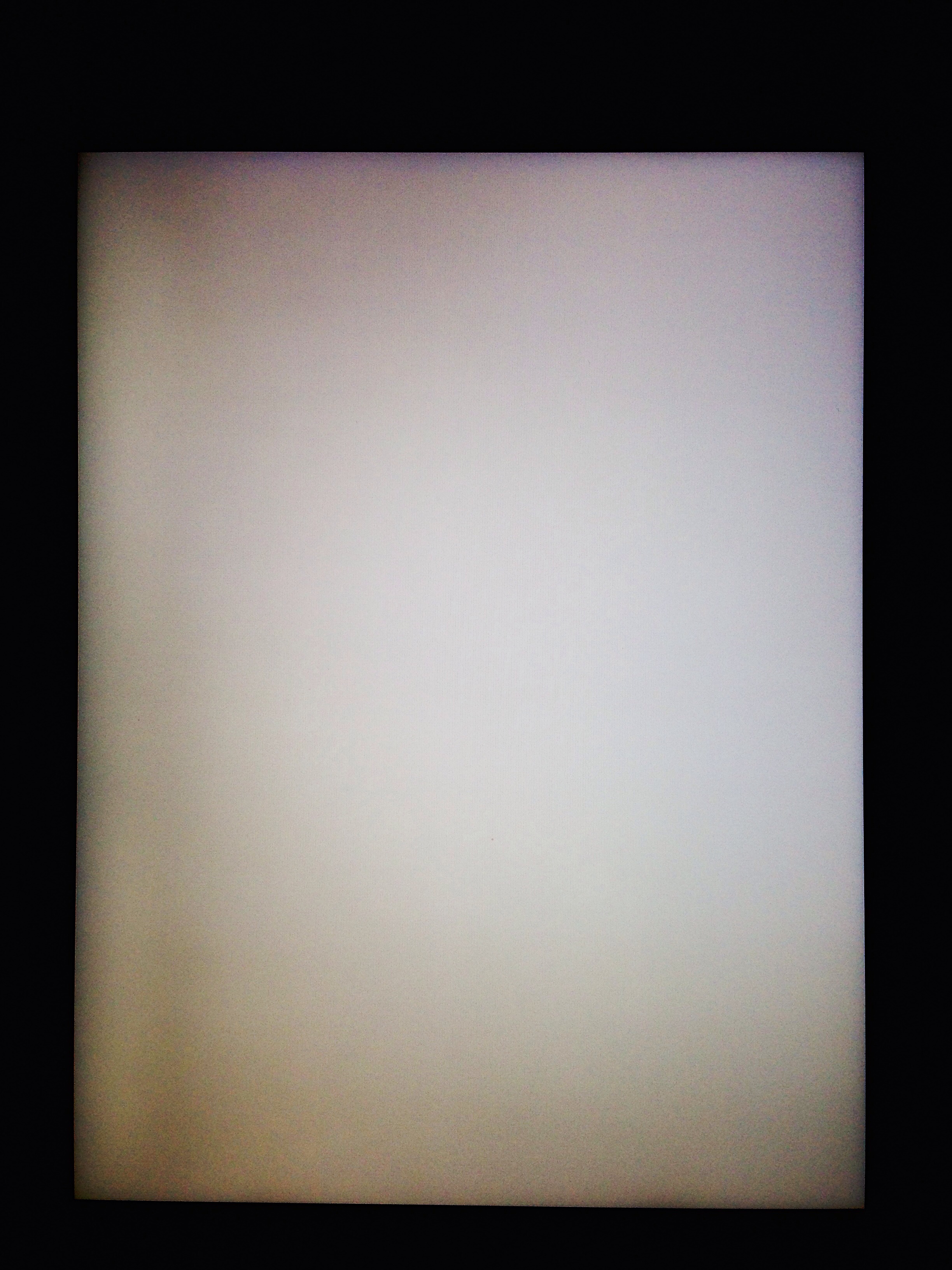

Great post and brilliant idea about upping the contrast to see the issue. I did the same below and while it isn't as bad as others like yours I will probably keep it since I don't really see it under normal situations even in safari. Plus I don't want to return it and end up getting something worse.

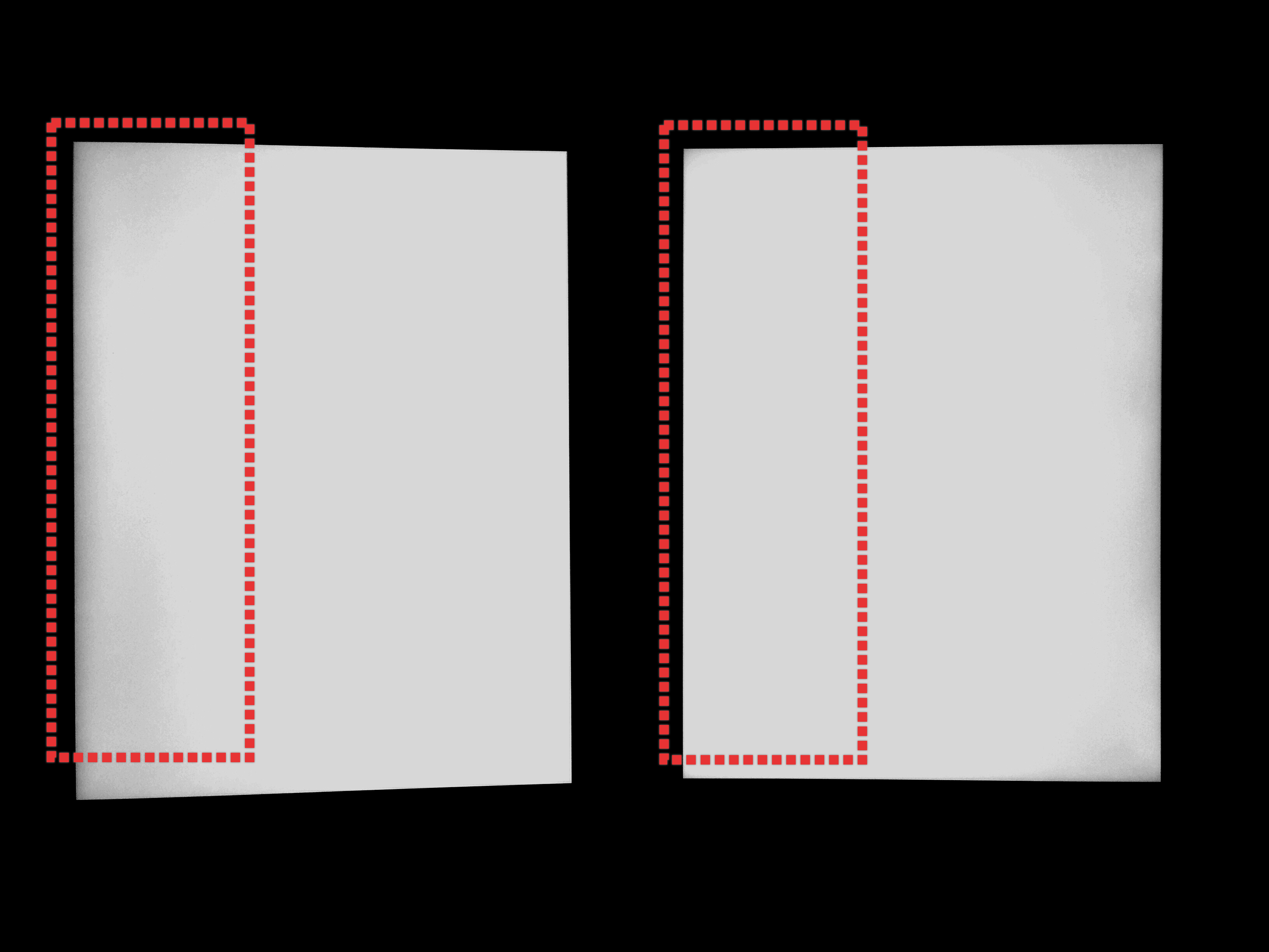

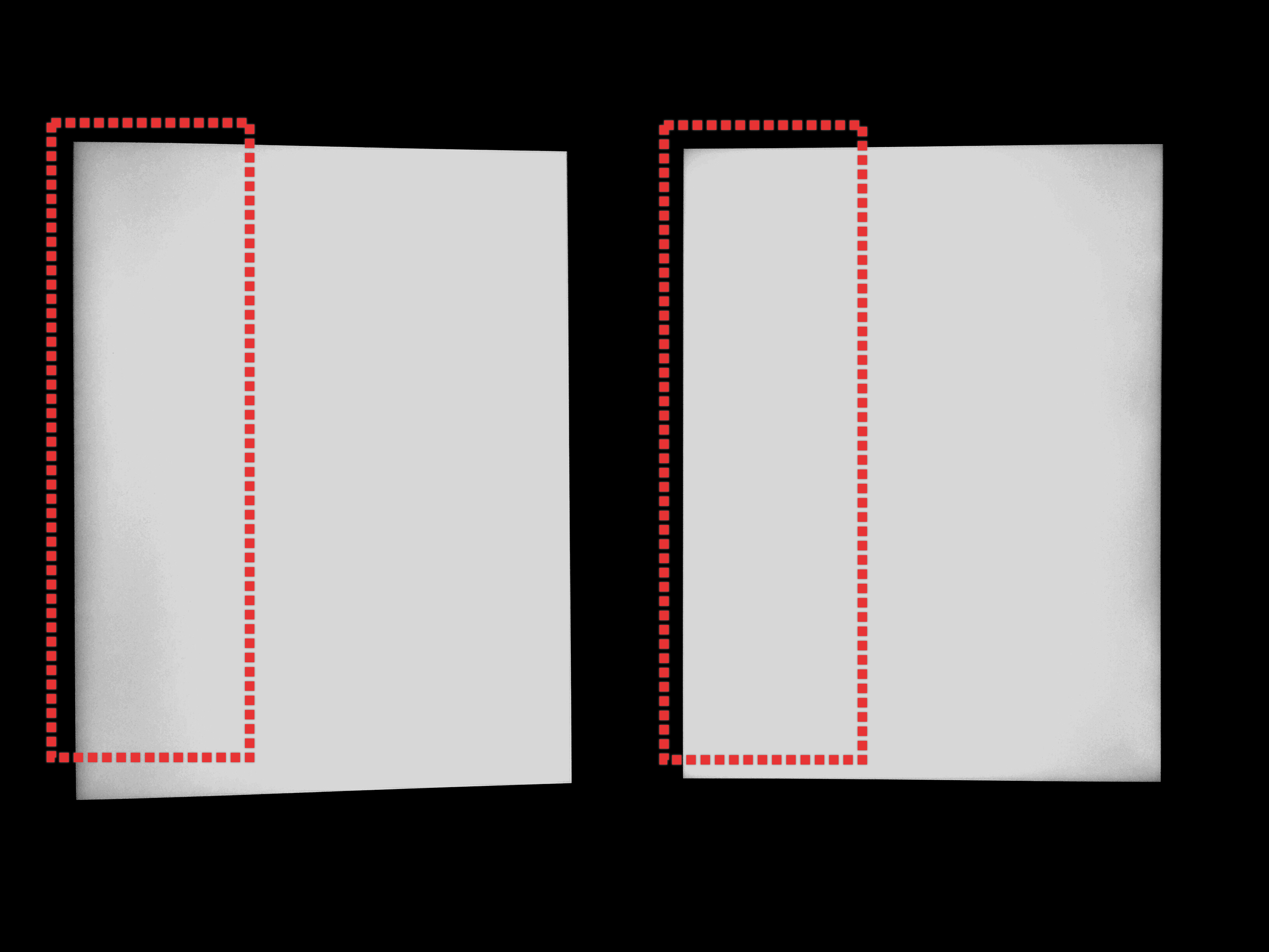

Done a side by side comparison, Air on the left, iPad 3 on the right. Increased contrast and converted to black and white to compensate for different colour temperatures between the two. Screen brightness both at 50%. Red box indicates the region of interest where the iPad Air is affected. Worth returning?
upon closer inspection I think my screen is yellow on the left side.
Too bright to see for certain right now, but will have a look in a dark room tonight to compare…
