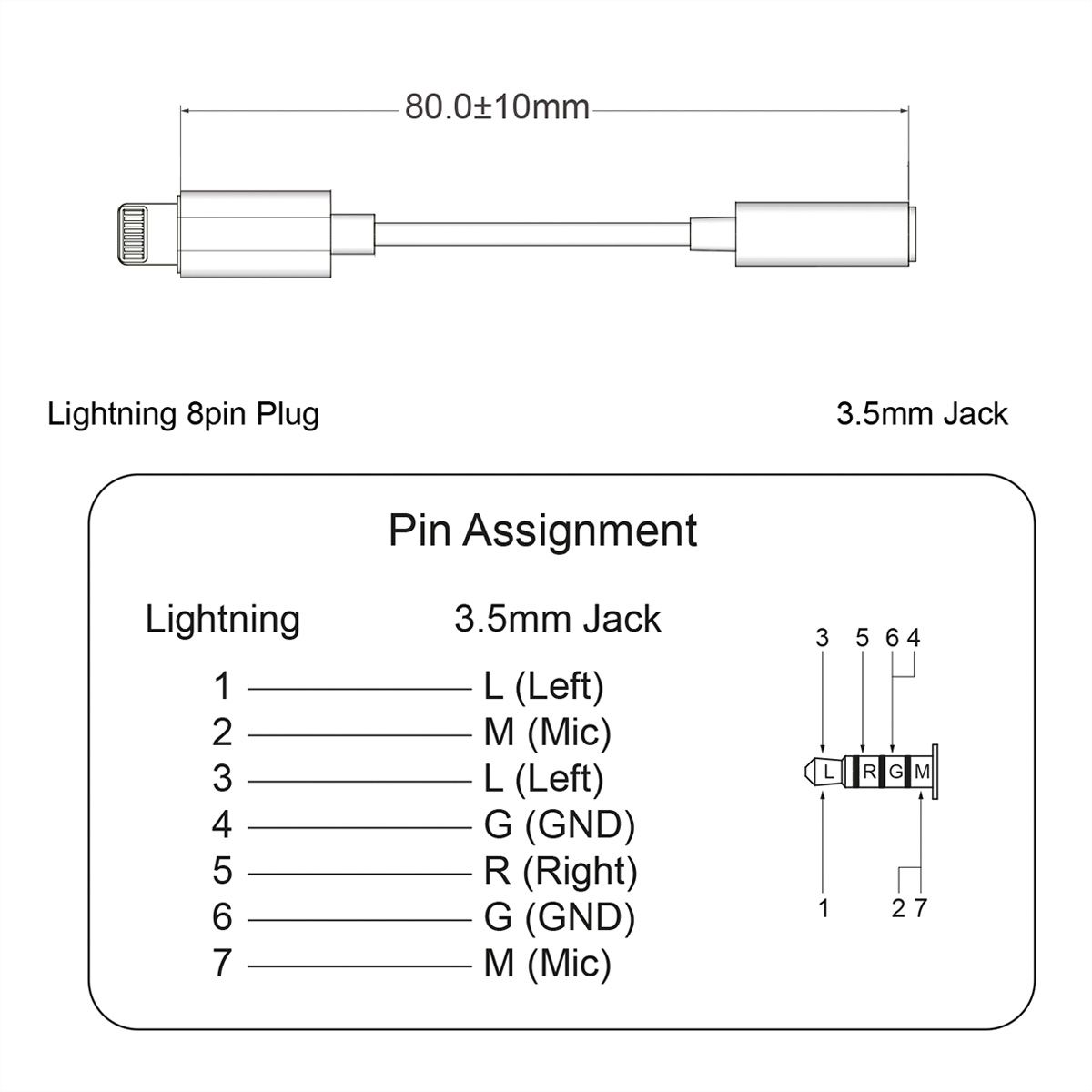

So. This is what I think is happening.
The lightning to 3.5mm adapter is probably using a hardware DAC that the device would be using for phone calls and audio output via the Lightning Port. When you attach this adapter, the phone or iPad actually takes over the data pins on the Lightning connector and outputs analog audio on them. The same happens for Apples wired earbuds. I think that DAC is the reason the analog output via the 3.5mm cannot do Lossless.
For the wirelessly connected devices it is an issue with wireless bandwidth for example with Bluetooth.
So how do you listen to lossless?
1. via the internal speakers of the iPad or iPhone since they are probably running of a different DAC.
2. Use a "digital out" connection such as HDMI, or optical fiber (on Apple TV) to connect to any device such as an Audio Receiver that has it's own DAC.
3. Wait for either headphones that have their own DAC and are recognized by the playing device as a "digital accessory" so the lightning or USB-C connection remains digital and is not taken over by the device's DAC to output analog audio. Of course another variant would be a small adapter that would house a Lossless capable DAC taking digital signals from the playing device to convert those to analog for the headphones etc.
Maybe in the future Apple's devices would use Lossless capable DACs on board, but I assume that's not the case now. I'm sure those DACs are a lot more power hungry that the ones currently used and hence the tradeoff makes sense.
In essence I think what Apple meant with the announcement was to tell people that the files being provided by Apple Music will include Lossless versions for those people that have a need for it and the equipment to play it. For everyone else, things will pretty much stay the same with the exception of Spatial Audio which will manipulate the files digitally to create the sense of space before sending them to the onboard DAC for conversion and output.
Hope this helps
