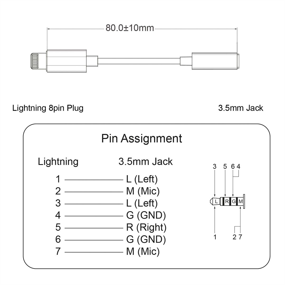

Weird. Because here is the pinout for the Lightning to 3.5mm.
That pinout is wrong. See .https://forums.macrumors.com/thread...-newly-published-patent-applications.1580549/ (also lots of other sites; anything more official requires being a signed-up MFi. From what various say, the lane 0 and 1 connectors are the same immediately above and below the two sides (i.e. swapped order on the other side), and the device (socket) side switches to accommodate.
I haven't read it exhaustively, but it seems likely that both lane 0 and lane 1 are bidirectional, so it's not as if one is left and the other right (for audio), nor one audio out (samples interlaced) and the other audio in. Indeed, there are stereo microphone adapters for Lightning connector iPhones.
So AFAIK, no analog signal goes out the Lightning socket. In the case of the 30-pin to Lightning adapter (30 pin does have analog outputs), the adapter has a DAC that converts them to digital. Probably every Lightning cable or dongle has one or more chips in it.

Earlier today, we confirmed that AirPods, AirPods Pro, and AirPods Max will not support lossless audio over Bluetooth because of Bluetooth limitations, and it turns out there's no direct wired lossless option for the AirPods Max either.
Apple's AirPods Max headphones are equipped with a Lightning port, but it is limited to analog sources and will not natively support digital audio formats in wired mode.
Apple told The Verge that when a 24-bit/48 kHz Apple Music lossless track is played to an iPhone into the AirPods Max using a Lightning cable and a Lightning-to-3.5mm dongle, the audio is converted to analog and then re-digitized to 24-bit/48 kHz. The re-digitization is not an identical match to the source and Apple is not able to say that it's lossless audio.
