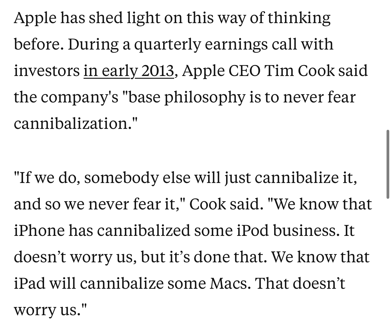

No. Because then you wouldn't need an iPad / MacBook.
Apple are not going to let the iPhone cannibalize those sales.
From https://www.businessinsider.com/apple-on-cannibalization-2015-12
