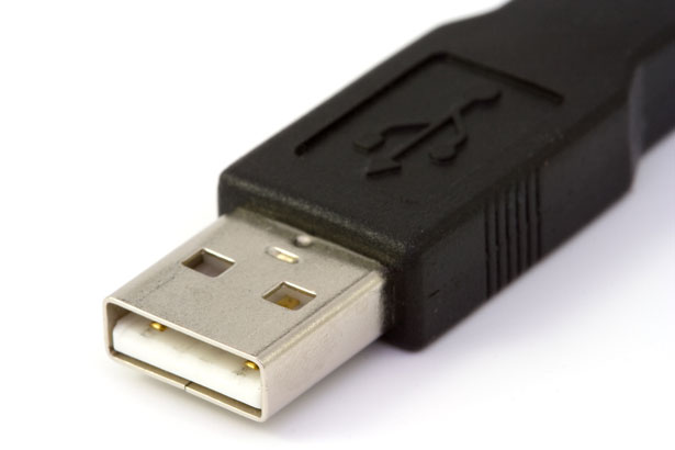

Cambrookpro's pic:
vs original usb connector below:
It's obvious that the piece with the contacts is much thinner, leaving a gap on both sides, with contacts on both sides. If you have any proof of this design failing, as they have been around, then please post it. Since I have never actually used one I make no claims either way.
PS: It's not hard to get this info by looking around.

The center tongue is thin and can deflect slightly, the shield is the same as any USB Type-A plug. There are 18 Apple employees listed as contributors to the Type-C specification. They helped make it, and they will certainly use it. That will in no way cause the billions of Type-A receptacles in use to suddenly change form. Type-A will be around and supported for at least another 10 years.

It was said that this is probably USB 3.1. It isn't, it's normal USB, it has nothing to do with USB 3.0 or 3.1. The middle part was thinned out and the connectors were brought onto both sides of the white plastic plate so it's reversible. It will be compatible with all USB sockets. USB 3.1 looks very different and is smaller and flatter, and rounded.

This is not a Type-C connector. Neither USB 3.0 "SuperSpeed" or USB 3.1 "SuperSpeedPlus" require a Type-C connector. Those specs were originally designed to use several plug and receptacle styles including Type-A with 9 contacts, which is the most common for host port connections on PCs.
On a Type-A plug, the 5 additional contacts used for SuperSpeed / SuperSpeedPlus signaling are located on the tongue behind the four contacts used for legacy USB 2.0 signals and VBUS. Annoyingly, all of the photos made public thus far of this new Apple connector fail to show the area where the SS contacts would be. However, judging by Apple's recently filed patent application, I'd be willing to wager this is a USB 2.0 only connector.
No, it isn't. In a display of utter incompetence, the USB forum has decided that for reversible connections, a completely new connector must be used that looks a bit like a symmetric version of micro-usb and is just as incompetently designed as such.
This is simply a reversible version of the current USB 2.0 A connector, which is possible because the tongue in a USB-A receptacle is specced to be just above the mid-point of the connector. (Look at the drawings and you'll see). At the same time, the contacts on USB connector tongues are slightly raised, leaving room between the two tongues. So if you make a tongue in the connector part that's thin enough to leave enough room for the receptacle-tongue, you have a reversible connector. You can then utilise the room between the two parts that would normally be there to slightly thicken (and thus strengthen) the tongue on the connector while using completely flat pads instead.

The middle part has metal connectors on both sides, and it bends. If the USB socket has the hole at the top, the white part bends upwards, if the hole is at the bottom, it bends down.

If it's thin enough it should be good. It won't have to bend very much at all. Here's a USB 2.0 drive I have:
The alignment is not perfect, but it gives an idea. It was harder to get the dead center shot with minimal shadow casting than I thought.
