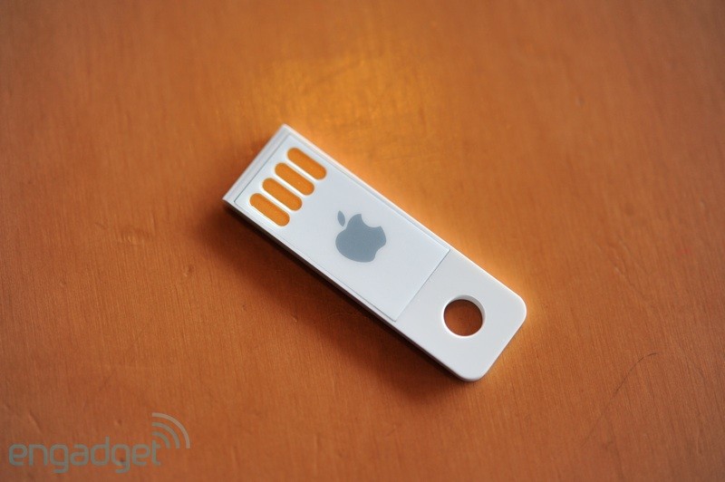

Cambrookpro's pic:
vs original usb connector below:
It's obvious that the piece with the contacts is much thinner, leaving a gap on both sides, with contacts on both sides. If you have any proof of this design failing, as they have been around, then please post it. Since I have never actually used one I make no claims either way.
PS: It's not hard to get this info by looking around.
I totally agree with you with the pic you have posted, but this is different to the pic in the article, may just be the angle of the news shot, see above comments just posted...
Look closely folks - it will fit ALL USB sockets ever made - bear in mind that the current plug design has a cavity which is 50% solid plastic housing pins, and the socket is just the exact inverse of that. All that has changed...
Ahh... I'll wait for someone else to explain this with better articulation 🙂
I did and they look symmetrical to me in those links.
The news article here, and I've zoomed in on the pic has a smaller gap on top and a larger one on the bottom thats why I don't think its symmetrical.
Perhaps its just the angle the pic was taken at that I don't see it.

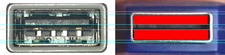

If it's thin enough it should be good. It won't have to bend very much at all. Here's a USB 2.0 drive I have:
The alignment is not perfect, but it gives an idea. It was harder to get the dead center shot with minimal shadow casting than I thought.
I wonder why they just hadn't designed the A connector this way in the first place.
Unfortunately, that image outlines the problem, not the solution. If the tongue on the male end is less than 50% of the width of the plug, then the tongue on the female end must be more than 50% of the width of the plug, in order for the contacts to connect.
As far as I can tell, you've shown that the female port could be easily redesigned for reversibility, but that still doesn't explain the OP image, which is clearly a redesigned male plug.
I think I understand what you mean so I had a look. I don't think there is a problem though; this has been overcome already as people have already posted.
The female plug has a gap and then the tongue, which mates at approx 50% with the male connector. The tongue and the gap do not occupy more than 50% without a forgivable margin - there is always bit of play on devices that are plugged in. A thin PCB would have more than enough flex to do this and there will be empty cavities on either side to let it.
This is a USB 2.0 female port added to the same plug image I posted earlier (no yellow this time) Does it not look like a thinner double-sided tongue in the middle of the male port with flush leads which filled the gap between the rectangles couldn't accommodate existing female ports without a redesign? It does to me. I'd be interested in your opinion on that as well as anyone else's.
Again, not perfect angles and I did resize the port by superimposing it over the existing image to make sure the boundaries fit while maintaining aspect ratio; I didn't bust out the calipers or rulers for this I'm expecting a degree of error; if it's too much then that's fair. If someone wants to measure or dig up some nice spec diagrams (or can tell me how to open the s12p files I got from the USB Implementer's forums) that would be great.
One thing I was surprised with by doing this was the gap between the housing on the female port and the tongue - bigger than I realized.
