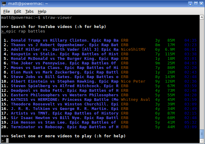

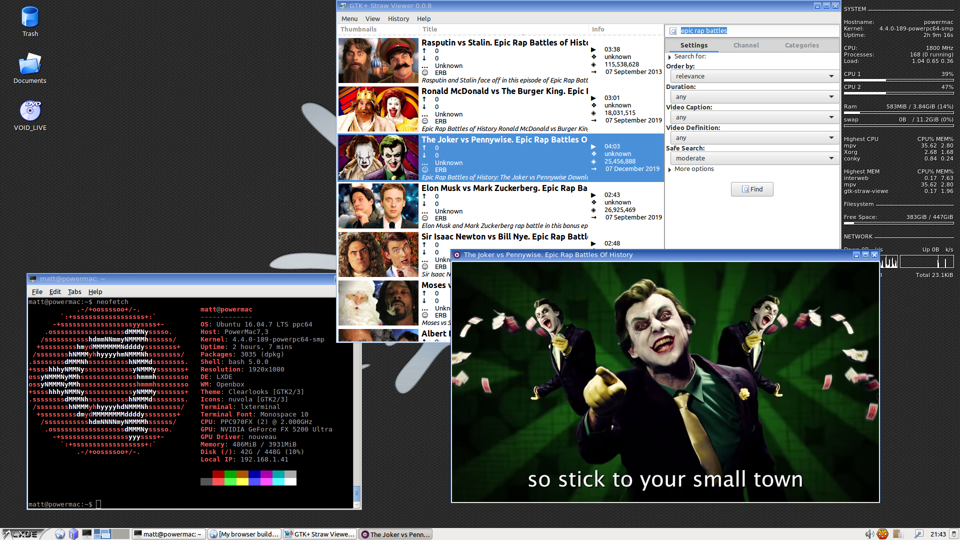

I came across this, and decided to give it a shot on Ubuntu 16.04.7 (remix). I'd assume it'd be possible to build the CLI version on 10.4/10.5 as well with macports perl, but i haven't tried that yet. It works very well. Fast too.
Download the 0.0.8 release found here.
Now you'll need to install some perl packages to be able to build this. (I installed these which might be overkill, but it worked)
Code:
sudo apt-get install libapt-pkg-perl libarchive-zip-perl libauthen-sasl-perl libcairo-perl libcapture-tiny-perl libcgi-pm-perl libglib-perl libgtk3-perl libhtml-parser-perl libhttp-message-perl libjson-perl liblwp-protocol-https-perl liblwp-mediatypes-perl libmodule-build-perl libnet-smtp-ssl-perl libperl-dev libperl5.22 libwww-perl perl perl-base perl-depends perl-modules-5.22 perl-tk perlbrew
Extract the straw-viewer archive and cd in to its directory. Now run:
Code:
    perl Build.PL --gtk
    sudo ./Build installdeps
(you may get missing deps when running ./Build installdeps. That's fine, let it automatically find and install them for you. Choose "sudo" install when it asks for local or sudo.)
With any luck you'll end up with both a gtk and cli interface like these.
Cheers

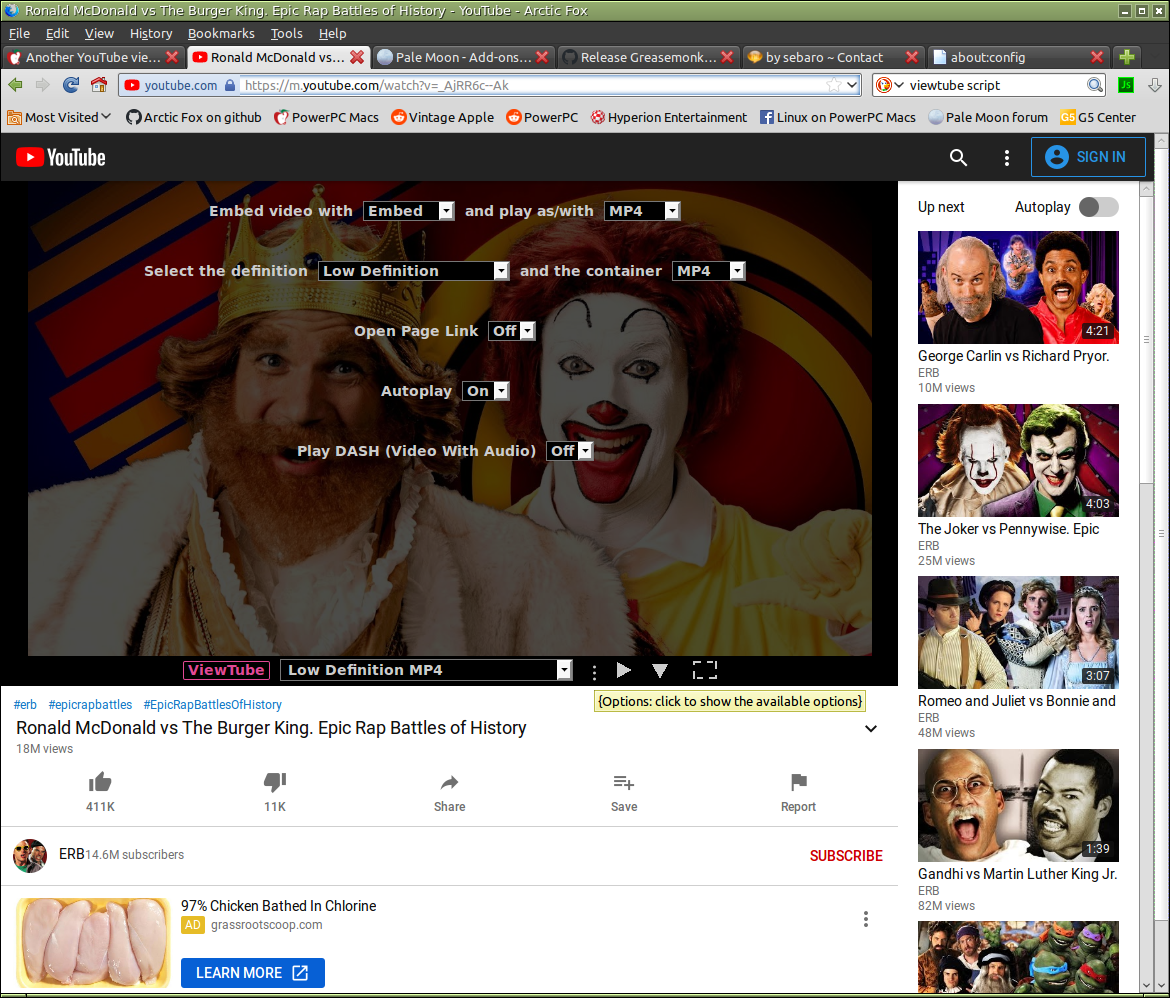

Here's a quick guide for in browser youtube playback with arcticfox or interweb for ppc linux.
Make sure you have mozplugger installed. Verify with
Code:
sudo apt-get install mozplugger
and make sure it's enabled in the browsers plugins. (about:addons). Be sure to disable vlc, gecko media player etc. Just enable mozplugger.
1) Install GreaseMonkey
2) Restart browser
3) Install ViewTube
4) Open about:config and in the search box type: useragent
5) Look for the youtube override and double-click on it and erase the old user agent string
6) Enter this in its place: Mozilla/5.0 (Android 7.0; Mobile; rv:54.0) Gecko/54 Firefox/54.0
7) Restart browser
8) Navigate to youtube.com (This will give you the mobile version of the site. This is much quicker and easier on these old machines than the new desktop layout)

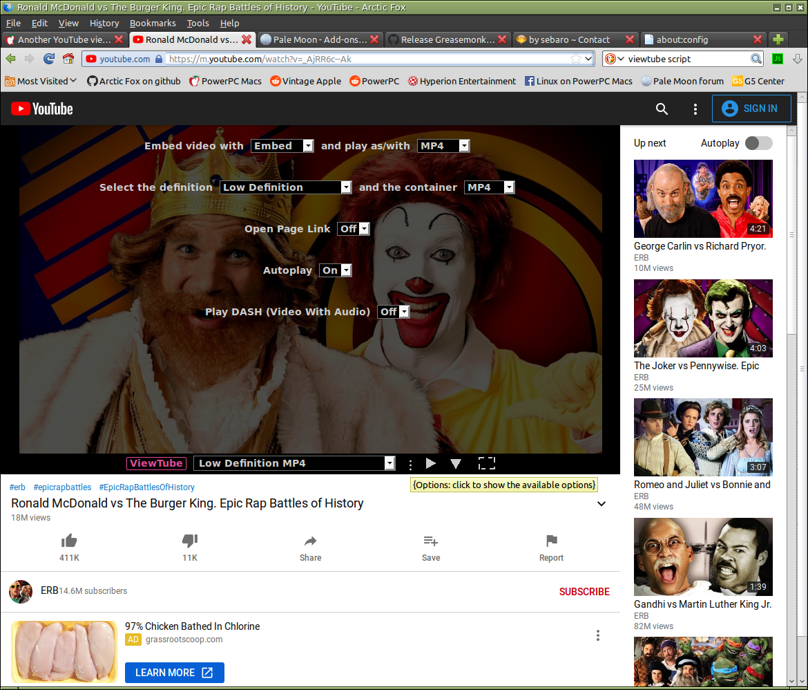

9) Click the middle 3 dots on the viewtube player to set up viewtube to look like this:
10) Enjoy
Cheers
