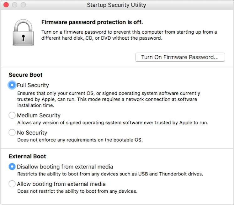

No issues so far with my new Mac Mini.
I should mention that I have set Secure Boot to 'Medium Security' and 'Allow booting from external media'.
Reactions: iZeljko
I'm also going to allow booting from external media, but why'd you choose medium security?
In my understanding medium security allows 'older' macOS to boot, while full security allows only the latest revision of macOS.
The next macOS 10.15 will eliminate 32 Bit support, and I have plenty of 32 Bit apps.
Quote: https://www.idownloadblog.com/2018/01/09/how-to-imac-pro-secure-boot/
  • Full Security—The default setting that brings the highest level of security. An active Internet connection may be required at software installation time so that your iMac Pro can confirm that it’s booting up a macOS or Windows version that hasn’t been tampered with in any way. Leave this setting enabled to run a macOS or Windows version that’s currently installed on your iMac Pro, or any cryptographically signed operating system trusted by Apple.
  • Medium Security—This setting verifies the macOS or Windows version on the startup disk only to see if it’s been properly signed by Apple or Microsoft, but doesn’t require an Internet connection or updated integrity information from Apple. It does not prevent the machine from running an operating system that’s no longer trusted by Apple. Use this setting to boot into older versions of macOS regardless of Apple’s level of trust.
  • No Security—This is the lowest security setting which doesn’t enforce any security requirements for the bootable operating system on your startup disk. Use it to boot into Linux or any other operating system supported on your hardware, no signing or verification with Apple required. This is the way all other Macs currently start up.
Once the older OS is signed, if you don't modify it then it shouldn't need a T2 instance unique signature again. The signage here here is this specific Mac equipped with a T2. If there is another machine need to boot from then may need to drop down to medium.
Apple tends to stop signing previous iOS versions ( even at 'dot' level increments), but I'm not sure macOS has the same issue. Especially since a reasonable number of Macs has access to more than one drive. And if Apple is shipping out security patches. As long as folks are running it and there are new security patches coming out they can't 'turn off' the signing completely for a specific major version.
After Apple stops all patching then perhaps Medium may be necessary if have some 'floating' boot drive that hook up to different Macs, but the older system, now stable that was matched to the T2 wouldn't have that specific signature rovoked over time and really shouldn't need a new one ( unless hacking around in Apple's code).
