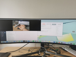

I recently bought a Samsung 49 inch (Samsung C49HG90DMU) monitor for my new Macbook Air M1. I have read about the multiple resolution issues when connecting.
I just connected mine, and I cannot get the maximum 3840 x 1080 resolution the display has. I already installed the SwitchResX, and unfortunately, the resolution doesn't appear in the options. I don't know if it could be related to the adapter I'm using or a driver issue due for an update.
It seems there is anyone connecting to an Air but only MacBook pro and apparently higher resolution screens. Could you please recommend any solution to me or better to return the display? I feel a bit frustrated about this issue. The icons seem stretched.
Thank you for your help!
Tried your file, and unfortunately not working, the resolution it shows is 3840 x 2160, no 3840 x 1080. I bought a USB C to display the port cable to see if it can fix the issue.
USB c to Displayport cable and SwitchresX fixed the issue. Working perfectly now.
