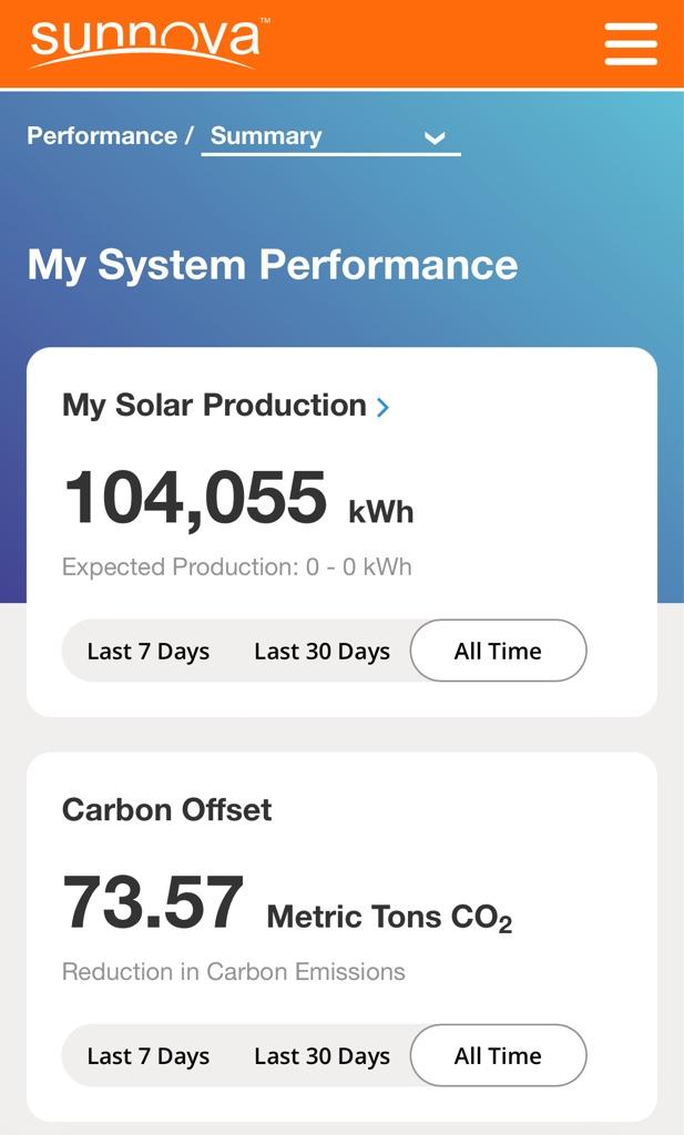

We’ve had our system for about 10 years. Ours are leased but we pay NO monthly payments. We paid $5k up front and that’s it. The company we leased from (originally Ad-Energy, now owned by Sunnova) gets tax credits and SRECs. We get the benefit of net metering. The system produces 10-11,000 kWh per year. We’ve got a total of 38 Mitsubishi panels, two SMA inverters. Typical utility bills range from $5-$17 per month but do jump up in the summer due to a/c and pool equipment. Additionally, when we’ve had bad winters, the panels can be covered in snow for a week at a time thus not producing.
FYI, we had just installed a new roof a few months before getting the panels.

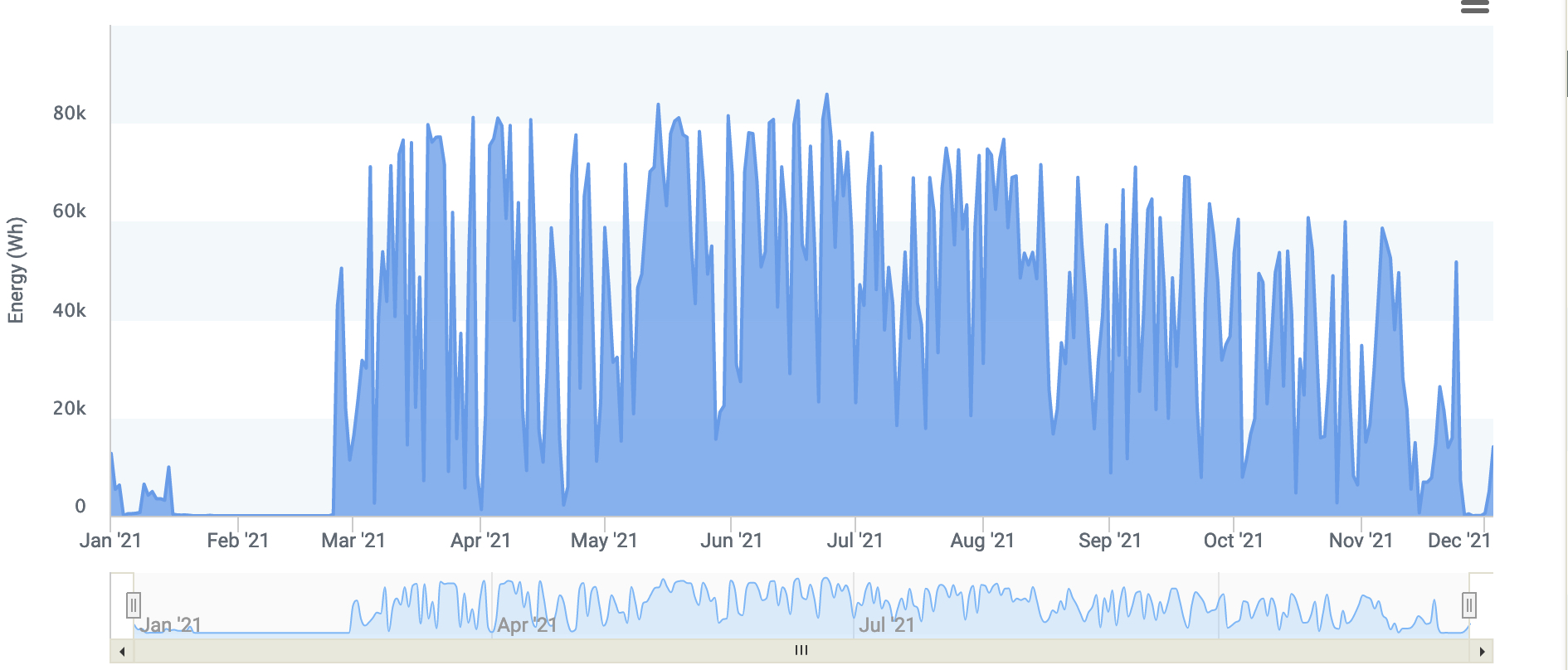

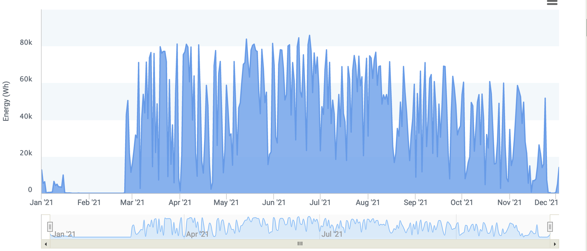

My advice is to move cautiously. When I lived in Hawai'i I had a 16 panel setup that I bought outright, for I think about $30K (this was in 2012) but I had tax credits that I think brought it down into the $15k range. Grid-tied but no battery. Electricity rates were very high there ($0.47/kw) so the pay off was rapid in that sense. $20/month to the utility if I made all my own power. The utility was fond of messing with their solar customers (most are, I believe) and so at one point I wanted to upgrade the microinverters but that would have made the system a new install (from their POV) and I'd have been shoved into the new net metering scheme, which was unfavorable.
Then I moved to near Ithaca NY. The house I bought has a 53 panel system, grid-tied, and it was leased and so I inherited the lease (no other option, except a ridiculously-high buyout option). It's not very favorable: $120/month with many years to go. The utility (NYSEG) grid tying agreement is a good one. I pay $18/month when I don't use any of their power, and when I run through all the excess power I've made during the sunny part of the year, I start to pay. Usually (see attached) this is December-February. This year, I ran through all my excess power in late November (the summer was unusually cloudy, but in any case I'd expect to run through my generation by mid-December).
The whole thing is marginal from a financial point of view -- I had no choice anyway -- but it works well. I have geothermal heating, which requires only electricity to run the pumps and compressors so there are plusses for the setup, but basically the lease and NYSEG are costing me somewhere north of $2k per year. Against that, of course, is that apart from a small expense for propane, that's it for my energy costs in a wintry environment.
I say "move cautiously" because there are bound to be a whole basket of gotchas. In Hawai'i the leasing companies were predatory (many said). "Free power!" except, not really.
I'd say you need to start with a careful audit of your electricity use, for a couple of years at least. You'll get nowhere without that. And remember -- as others have said -- "grid tied" doesn't mean that you'll have power when the grid isn't delivering it. It goes down, you go down, although it seems to me I've seen some clever (and safe) hacks that will let you use your own power during those times that don't involve a battery. Not sure. I have a propane backup generator for those times.
I wouldn't worry about your age. I'm pushing 80; I may or may not see the end of this lease, but what difference does that make? When I'm gone, the house will be sold or the kids will inherit it -- either way, it makes no difference to me.
