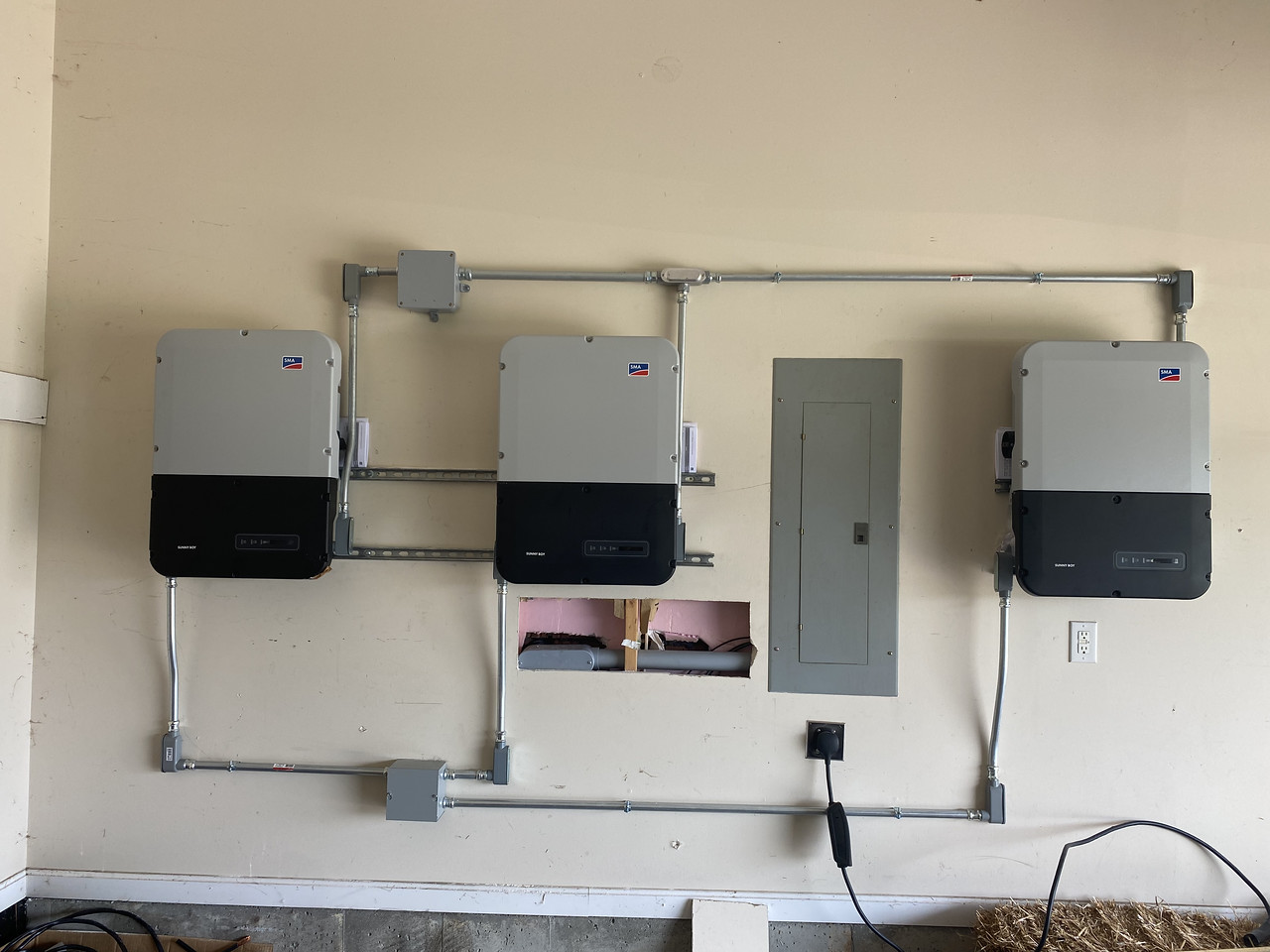

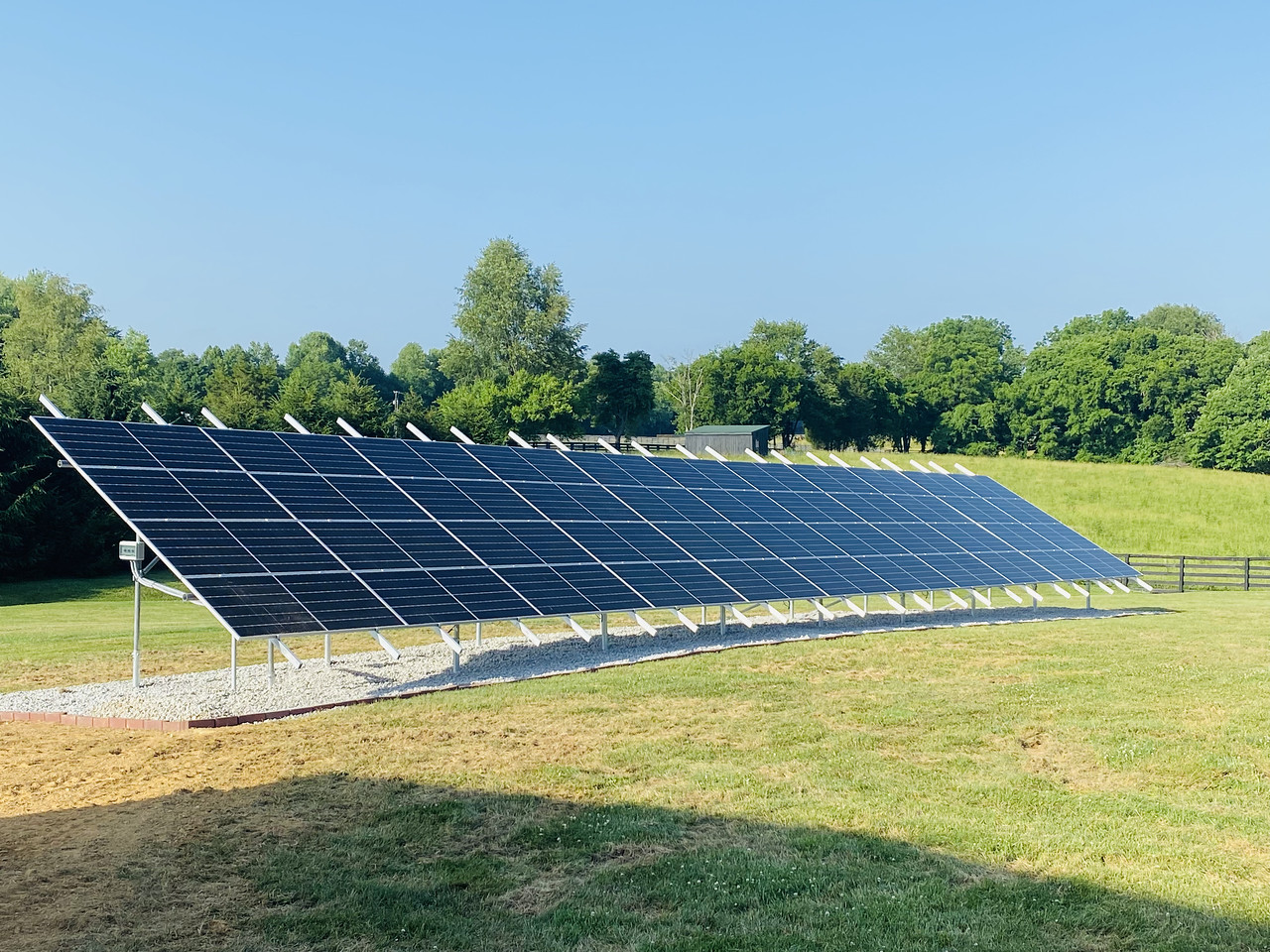

Just got these installed today. Inspection is Thursday, meter swap is Friday. No batteries as that was an added expense that we don't need. Plan on getting a smaller rechargeable one.
In keeping with the thread topic, we didn't have enough southerly facing roof to have it installed up there, which is fine with me. We have plenty of ground.
This array should cover 112% of our usage.

The extra 12% is sold to the power company or to keep the small battery charged?

If I were to have a solar set-up, I kind of like what John has above photoed with the in-ground set up, but when we move into our new house, I’m not sure if we have enough plot to have that installed. That’s definitely something for a contractor to take a look at.
