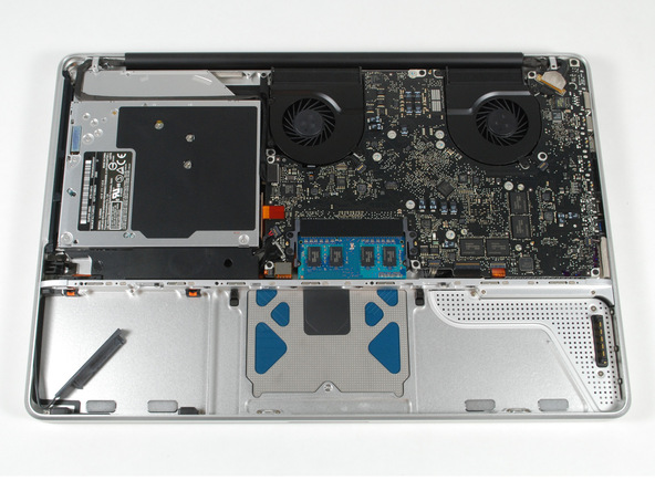

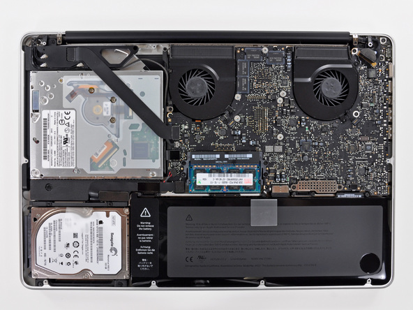

They are not, unfortunately. In the Late 2008 and Mid 2009 models, the AirPort card is housed inside the display (inside the black plastic housing where the hinges are), and as such have connectors that run there for antenna, iSight etc. In the 2010 however, the AirPort card has been moved to the internals of the computer itself, and there is a new type of connection on the logic board.
2008/2009 (the internals are pretty similar)
RJNdtkvPDvpTymoX.medium
2010
dMvHZpKm1hGbxbIC.medium
