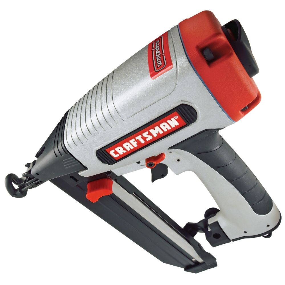

I bought the prior version of this 2-1 nail gun, works fine for staples and brad nails.
I've lent it to 3-4 guys at work and they all had good comments on using it.
http://www.craftsman.com/craftsman-2-in-1-finishing-tool-kit/p-00918176000P?vName=Power+Tools+%26+Equipment&cName=Equipment&sName=Compressors+%26+Air+Tools&prdNo=30

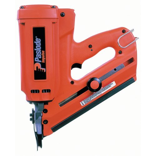

Yea - I've also got a Paslode Framing gun, the cordless no air is great.
I borrowed a air framing gun from a contractor friend initially, but he needed it back in 2 weeks so the Paslode was also a long term investment.
When I lend it out, people always buy me a extra cartridge and nails...I've got a good back-up supply that way 😉
That easily paid for itself many times over as I used it to completely finish my basement in 2008, among other projects...
