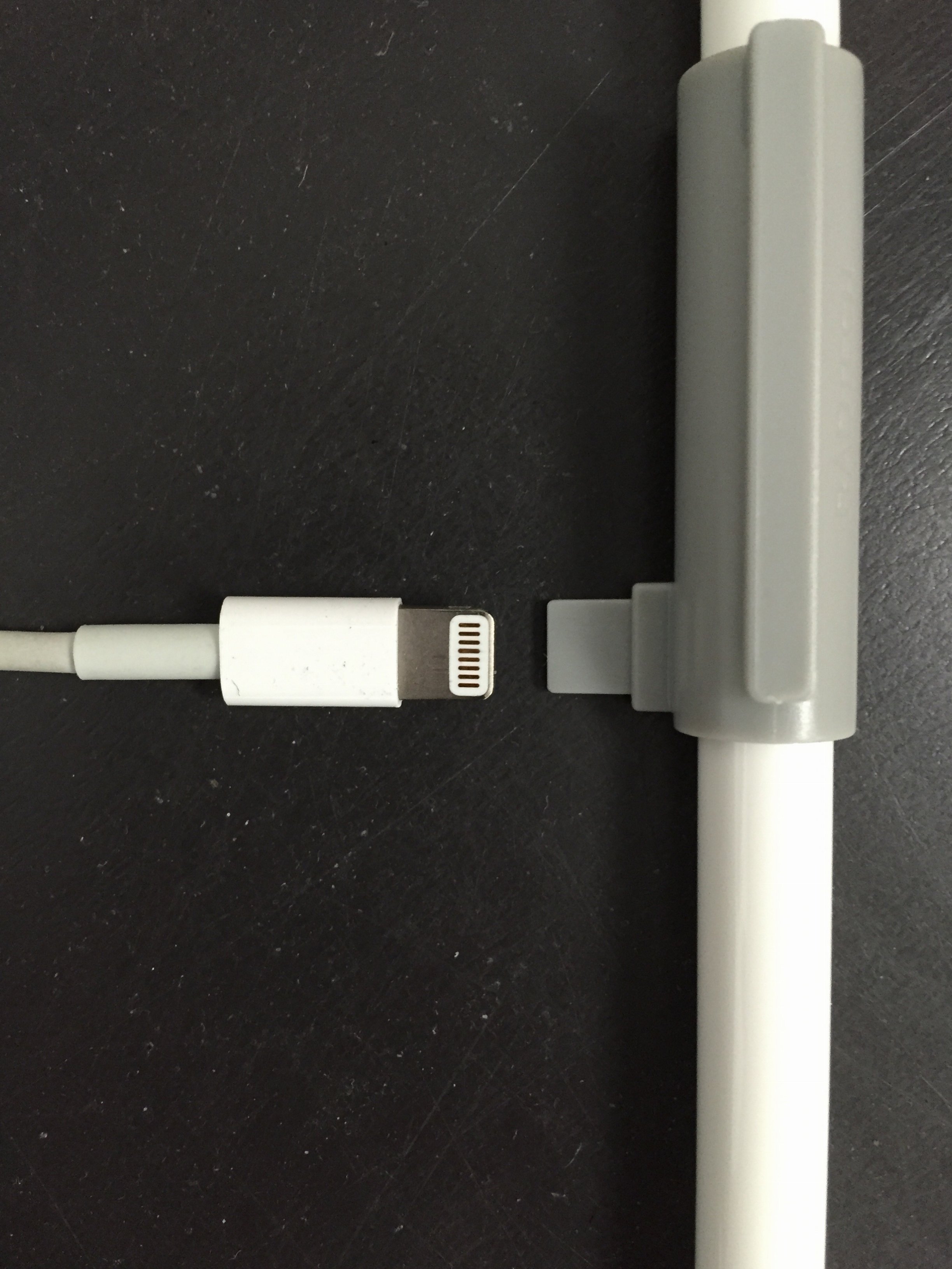

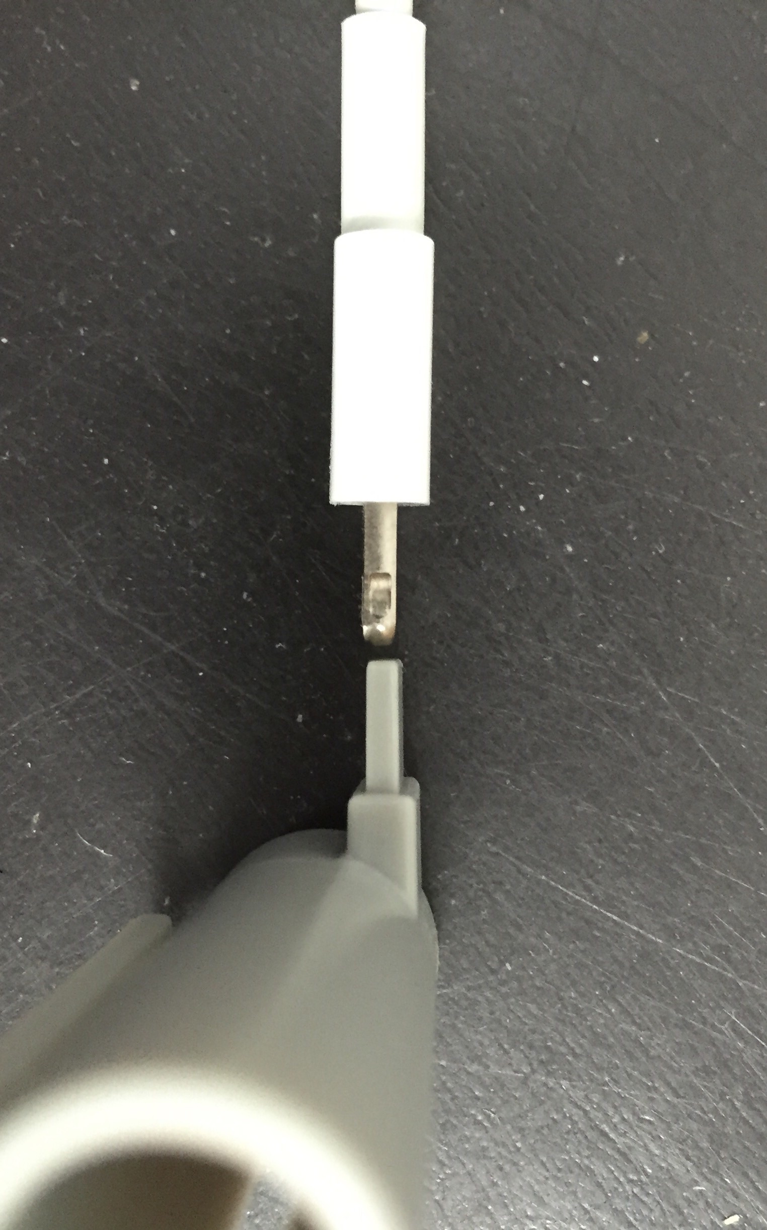

Hey guys, I'm the designer of the PencilClipz accessory and happy to address any concerns about the product.
I used polycarbonate for this item so that it would absolutely not fracture, nor break easily. the two elements that extend from the main body; pocket clip and the tab that inserts into a Lightning port, can be flexed to their extremes dozens of times before the material will weaken to the point where it could be physically pulled apart (like the cap/pocket clip of the disposable Bic ballpoint pens - the ones you can literally gnaw on for months and never break).
And just to add an even greater margin of safety, I designed the Lightning port tab so that even if it were flexed to its extreme numerous times, the shear line will develop well past the Lightning port that it's inserted into, thereby making it easy to remove.
Rest assured, PencilClipz is as well designed as the rest of our line. And if by some freakish chance anything would become 'stuck' in your Lightning port, we'll remove it at zero cost to you.

Hello npolly0212,
I believe the 'others' had their Lightning port conductors bent/mangled while having a broken piece of some material extracted from deep within the port, not from normal insertion and removal - the port is, after all, designed to accept a mating male connector of similar size. This simply cannot occur with the Lightning tab on PencilClipz.
Additionally, we've subjected several female Lightning ports to thousands of insertion and removal cycles prior to release with no damage noted of any kind, and we've continued to ratchet up the cycle count post release.
And if anyone is truly worried, don't insert the tab - use the device for it's other benefits; pocket clip, enhanced grip when doing detailed drawing and the elimination of the pencil rolling when placed on an inclined surface. And if you don't love it, we'll take it back - just as we've done for the last 14 years.
Regards - John G

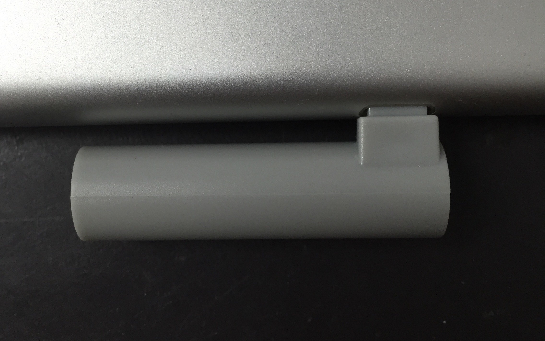

Ok so I got my clip from Radtech yesterday. I was reluctant to put it into my lightning port but after reading the company's response here and comparing the size to my Apple lightning cable I went ahead and did it. It's a nice fit, feels about the same as a lightning cable. The plastic is strong and doesn't appear it would be able to break inside the port, so I'm much more confident now. Check out my pics to see a comparison to lightning port and how it fits in the port.
