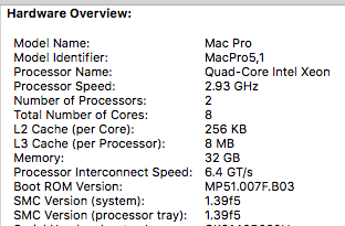

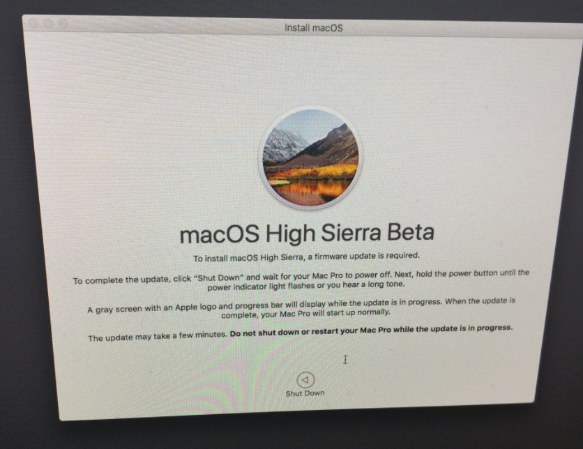

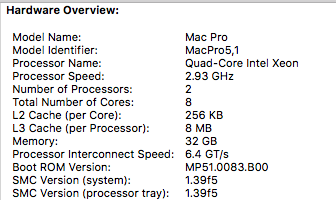

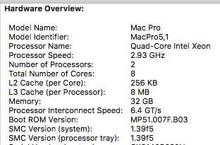

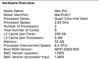

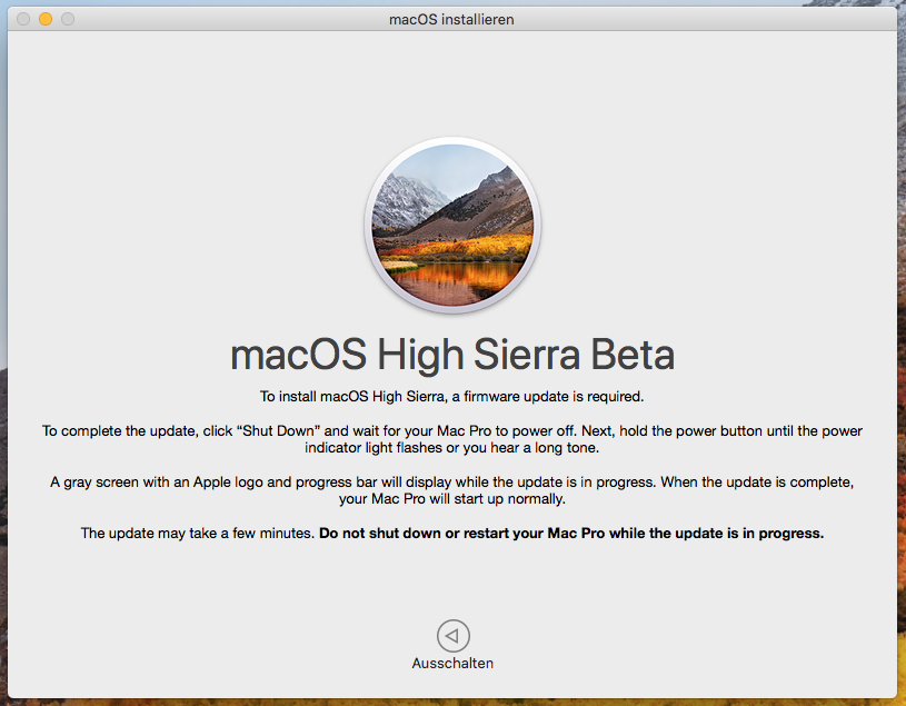

Yeah you get a firmware update! 😱 first time the 5,1 has gotten a firmware update in ages! I did not get it when updating from DP1 to DP5 but if you make a DP5 installer, it says you must update your boot rom before you can install and it tells you how, the shut down button did not work for me but going to the apple menu and hitting shut down worked for me 🙂 then i followed the normal hold power button until flashing power light and bam it did the firmware update! and im using a flashed 4,1 to 5,1 Mac Pro! so yeah looks like flashed 4,1s are so identicial they happily take the High sierra boot rom update! 😀
this is the old boot rom
and this is the new boot rom!

yeah im not sure what the change are would be nice if apple gave us a change log for this stuff 😀 , im going to guess APFS support is one LOL but i wonder if anything else changed, I did notice that instead of it going say from MP51.007F.B03 to say B05 like what macs normally do when they get a firmware update, it went to MP51.0083.B00 so yeah... make of that what you will (interestingly the MacBookPro9,1 also did the same reset to B00 thing with its firmware update included in B5 where as in other firmware updates its just gone up from say B17 to B22)
BTW I just checked in CPU Z and the BIOS date is the 27th of the 7th 2017 🙂 ...

BTW here is the Firmware update thingy i mentioned earlier

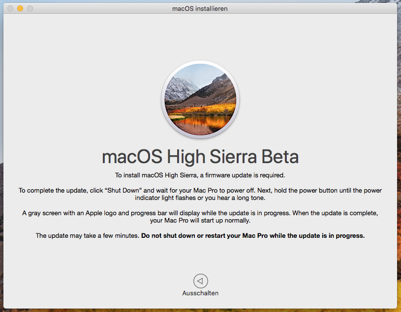

I failed to upgrade the firmware on my Mac Pro 2009 (flashed to MacPro5,1). After the regular firmware update procedure (flickering light, beep, 5 minute wait, automatic reboot), the firmware is still MP51.007F.B03.
Since I'm using a Radeon RX 580, I don't have a bootscreen and can't tell if the progress bar is actually displayed and/or if a kernel panic occurs somewhere along the way.
What I've tried (unsuccessfully):
  • Removing external devices
  • Removing PCIe SSD
  • Removing PCIe USB 3 Adapter
How long did the firmware upgrade take for you?
PS: No need to peek at the EFI partition. The firmware files are also found in the installer package in
/Contents/Resources/Firmware.
Reactions: LightBulbFun

Just a heads up to update the firmware on a Mac Pro 4,1 or 5,1 you have to install an EFI video card (this is true also if your flashing a 4,1 to a 5,1) if you dont have a EFI video card then it wont update

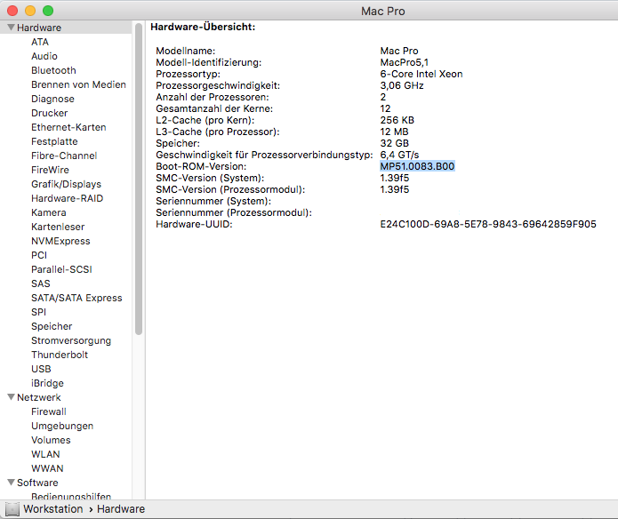

I have a Mid 2010 5,1 with upgraded processors (3.06GHz 6 cores), GPU, and WiFi board. The update did not touch the firmware. Looks like that will need hacking.
Boot ROM Version: MP51.007F.B03 - before and after update.

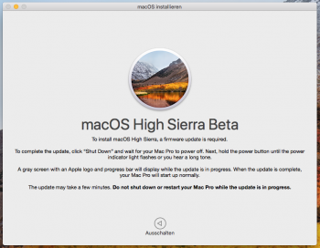

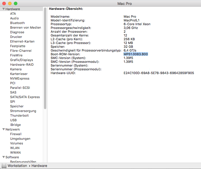

Can confirm the firmware upgrade works with 4,1/5,1 and a flashed EFI card (280X).
Had already updated to 17A330h. I've then downloaded the full installer from the Appstore, and when it started I was greeted with the same instructions as shown by LBF. Performed the firmware upgrade, automatic reboot, and now have MP51.0083.B00.
View attachment 712003 this is the old boot rom
View attachment 712005and this is the new boot rom!
Had already updated to 17A330h. I've then downloaded the full installer from the Appstore, and when it started I was greeted with the same instructions as shown by LBT. Performed the firmware upgrade, automatic reboot, and now have MP51.0083.B00.
