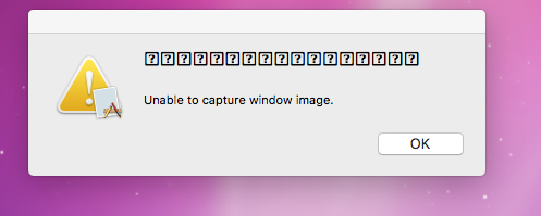

im curious where did you find that dump, do you have a path to where i might find it on my own system? also what does "show report" show? do you have a screen shot? 🙂
I also noticed that the picture, shows firmware of a MBP9,1 (2012 non retina MacBook Pro 15 inch), not a Mac Pro 5,1...
