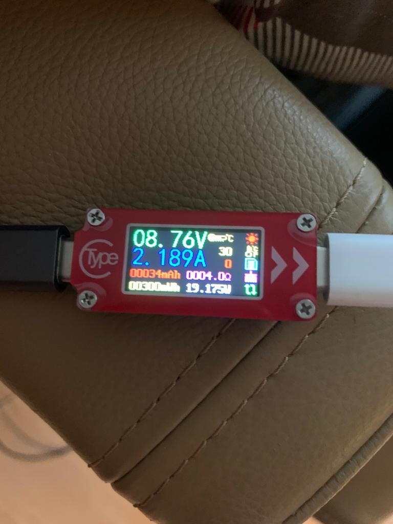

So i did a test myself my charger (Baseus 65W) with a 9V 3 A profile delivers 20 W to the Puck but after a while it throttles down. This could be due to my soc > 50% and heat. So other chargers work if they support a 9 V profile > 2 A .
That was my experience, initially 15W then throttles down in less than 5 mins

Thats normal i guess. If there is an PD profile problem it wouldnt request initially the 20 W. Will di a test with a cooling pad but i think the behavior is the same with the apple charger.
