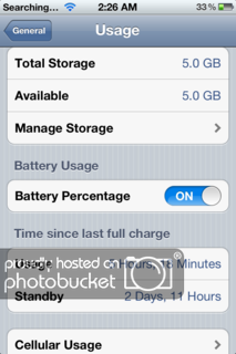

The phantom usage is driving me crazy. My 4S keeps registering a usage that's 80% of standby, even when I have it on lock. I've tried everything (restore, reset, drain and charge to 100%) and it's still going on.
I even restored the phone without any apps and data, with location, siri, wifi and all other settings off, and the phone still registers phantom usage.
Anyone else having this issue?
