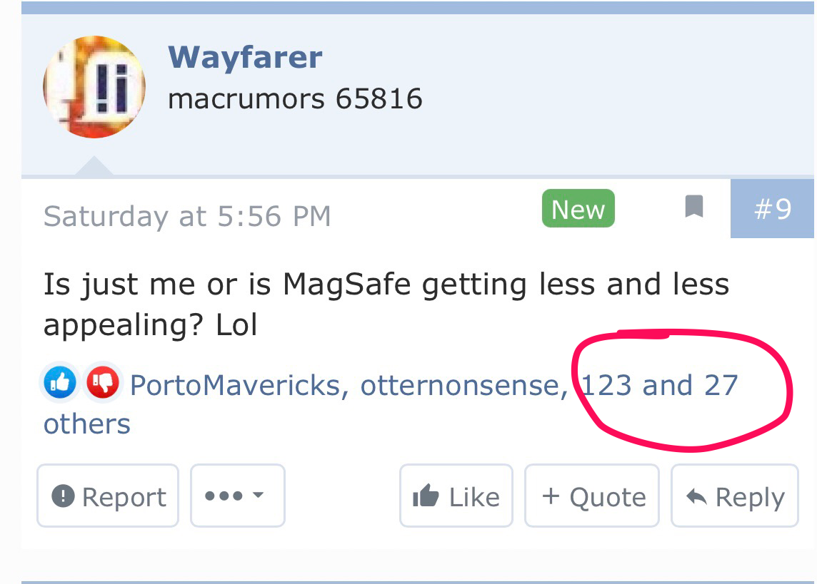

Is just me or is MagSafe getting less and less appealing? Lol
