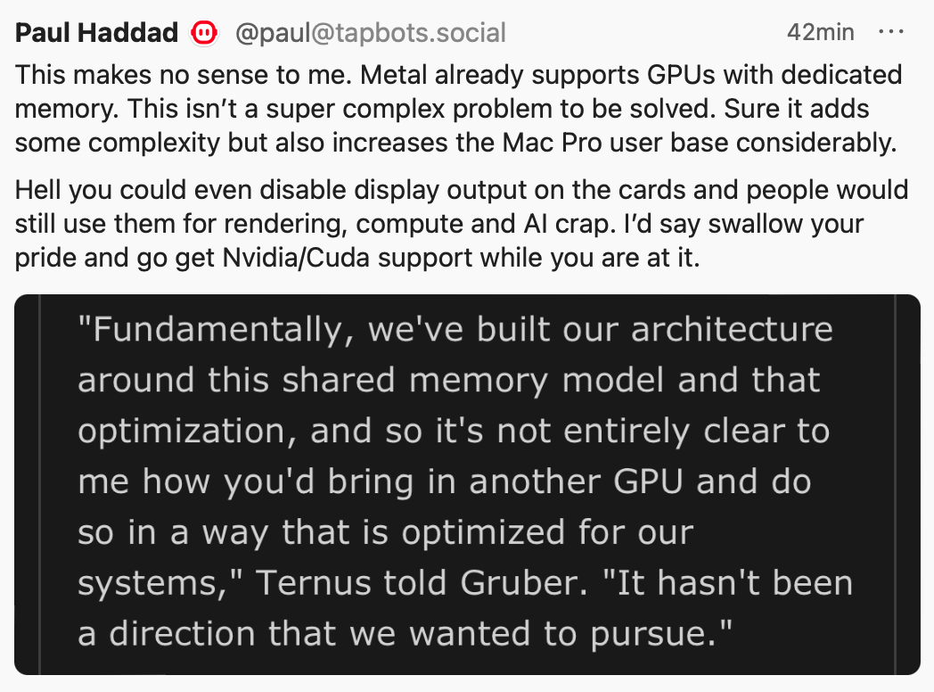

80/20 split is likely an order of magnitude off. This is mainly more about software than hardware. Apple has eliminated dGPUs for all product models from iMac through upper end MBP. By volume shipped, Intel was the dominate mac GPU vendor by far. If you sit in these macrumors forums you'd think there was a vast AMD vs Nvidia war going on. That really wan't the 'world war' at all if take two steps back and look at the whole 'forest' rather than just one 'tree'.
If loop in the iPad (**) with plain M-series now the 'experience' is more like 99.96% vs 0.04% even if Apple had looped only the Mac Pro (plus some odd ball eGPUs that were left) in. If round that to one digit after the decimal point its 100.0% to 0.0%
I think Apple's primary objective was to wipe out dGPUs entirely from the laptop line up. They did a n extremely good job of that. The collateral damage on that though turned out to be wiping out dGPUs on the iMac performance class of Macs also. Three years ago if told folks that Apple was going to match on some benchmarks the 4070 with an iGPU , you would have gotta lots of "what are smoking" looks.
** Point at the iPad saying those a iPadOS apps and mac has macOS apps completely misses the point here. If you drop down to just the graphics programming level of those apps and put aside the relatively narrow UIKit, File storage libraries, and a few other orthogonal library differences of those apps, it is going to be mainly the same optimization changes need to make from the legacy ( 10 years ago) graphics structures where had to copy data to/from the GPU and several other baroque issues that Apple GPUs don't have. That GPU programming subset if what Apple is trying to put "all the wood behind one arrow" . Extremely optimized apps in this specific area should work better all the way up and down that hardware stack. That shared 'experience' is what they are managing to.
It is mainly software ( and the assumptions built in that hinder/help performance ) that is the primary issue.

Unified memory access is preferable, though it can be done with external GPUs as AMD did with EPYC Trento and MI250X for supercomputers; AMD simply modified the IO die to include dGPUs in the unified memory space via Infinity Fabric. Apple simply isn’t interested. AMD’s next MI300 is more akin to a very large GPU with a CPU on-package with a ton of HBM3. Should also be noted that Apple still refuses to do business with Nvidia.
AMD really didn't do "Unifed Uniform" memory with the MX250X. The two dies on the 250X present to the end user app as two GPUs; not one.
It is 'less painful' to do copying on the MI250X but the memory pools are not really unified. The applications have to explicitly finish off the 'unification' with explicit code.
Apple's solution is for the most part transparent. [ there are a narrow set of cases where if kind of 'sloppy' assignment of work to cores where memory is far away can re-surface the distance issues that Apple tries very hard to automatically hide. But apps with bad assumptions and work allocation just work slower with no explicit memory 'unifying' calls. On MI250X that just doesn't scale ( you just get one GPU out of the two).
( Yes there are tools like MPI on top to paper over NUMA memory access that are used on supercomputers/clusters , but those are custom apps. Those calls are all basically explicitly present in the code and how the data is segmented has to be very carefully thought about in advance. )
Same think with NUMA Infinity Fabric connection. If get multiple node hop memory references ... at some distances that have to be explicitly mitigated in some apps.
I think Apple's 'war' on anything Khronos ( OpenCL/Vulkan/OpenGL ) or anything other than Metal is a bit limiting. Short to intermediate term, it probably won't hurt them as long as iPhone and iPad and lower half of Mac market keep growing. But long term, if better , more widely adopted portabel standards appear , Apple will likely get let i the dust trailing to catch up.
If MI300 presents as just one GPU then they would have turned the same 'corner' that Apple has. I'm kind of skeptical that they are done that. The info presented so far is that they are going from two GPU compute ties to six. If they had trouble doing two (admitted bigger ones) how is six going to get easier? Some recent rumors have stated there are 4 base memory/cache tiles in the package. Each base tile is coupled to one base tile and then persumable the base tiles are cobbled together. tile X on base tile A that needs to get to tile Y on a base tile three position away is going to take as much time as pulled memory from the base tile it is on? Probably not.
We'll see tomorrow (6/13). But good chance the MI300 does more to shrink a two MI250X+AMD CPU whole logic board for a supercomputer node into one very large, expensive package than it does for unifying the GPUs into one presented uniform larger GPU. It is going to take apps that are built to scale across multiple components in a supercomputer node and run them faster with huge decreases in power wasted on making them overly discrete. those apps already have the explicit remote, NUMA access juggling assumptions already built into them.
Anyway, tl:dr - Dedicated external GPUs are possible within unified memory space, but Apple wants you to use its silicon instead of wasting all of the die space they dedicated for M2’s iGPU.

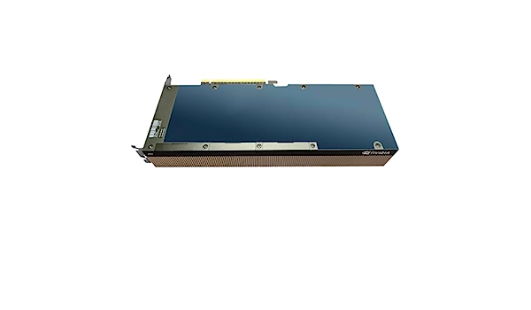

Yes. The model has to fit in the vram. In the ML universe, the A100 GPU is the most common GPU you will come across. The new one has either 40 or 80 GB or VRAM. This is Apple's competition. The gamer GPUs are for gamers.
To get better performance they place multiple A100 cards in the same computer. So that way you really can have an effective 128+ GB
You can buy the GPU here on Amazon
How many of the people complaining about the fact that you can not place a high-end GPU card in a Mac Pro would actually do so if they could. It would be silly. Most of us lit Amazon or Google buy these cards and place them in data-center servers then we rent time of the servers. Why would anyone buy their own? Google rents time on the servers for $0.87 per hour per A100 card.
But the Mac Studio lets you have all this VRAM and a very fast GPU for 1/2 the price of one A100 card.
