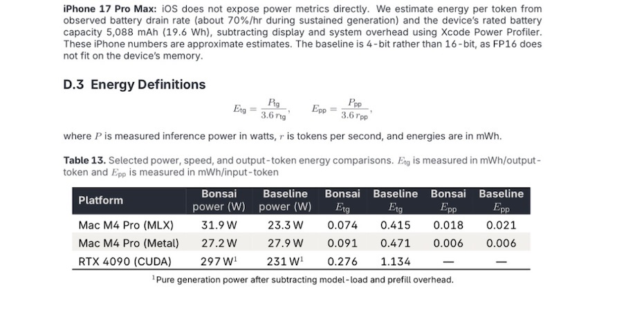

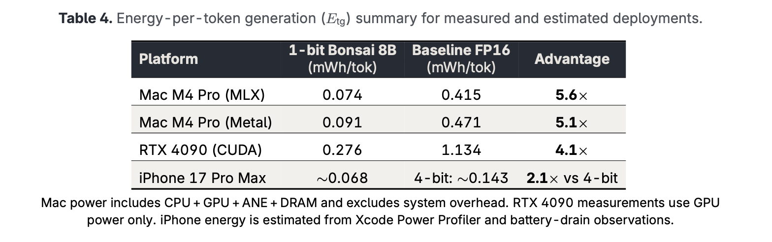

Neither do they require more power. Their white papers in fact give the required energy per token, and it's not at all bad (as common sense would suggest, given that moving data requires so much more energy than computation).

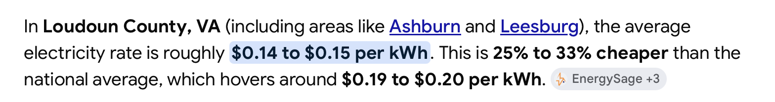

One county in Virginia has 37 data centers. I'm sure they didn't consider the implications of all those data centers when it came to their electricity bills. There is short term gain in jobs building the data centers.
And yet reality disagrees with your theory...
Want to try again, this time maybe telling us about some awful drought that has been killing people all across Loudoun county as they desperately struggle for unavailable water?

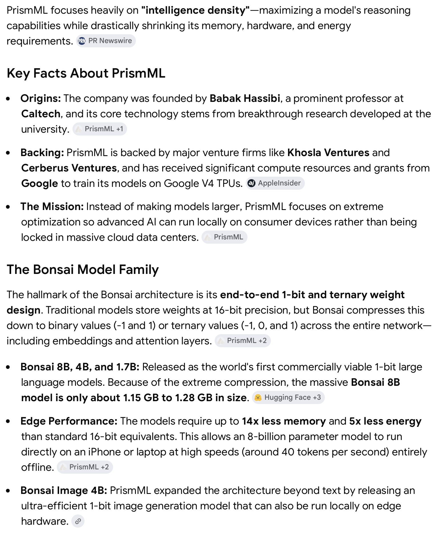

Incredible the degree of extreme comments being made here by people who have no FSCKING CLUE what PrismML does, how the tech works, or why this is interesting and significant...
Here's a quick summary:
The point is not ONLY the intelligence density, though obviously that's nice; it's also that binary and ternary models can be executed with much lighter weight MACs (ie you can pack many more of them into the same area, or alternatively run them with substantially lower energy) than the INT8 or FP16 HW.
And Apple likely already has the designs for such binary/ternary optimal HW in house (having acquired it via their purchase of xnor.ai). It's generally believed (though I haven't seen anything absolutely definitive) that they are already using such a 1bit DNN and associated HW on AirPods for various tasks.

I may have played it a little loose with "proof of concept," but I can't just have you dropping truth bombs on me without some sort of informed response. So I read the white paper. lol
Ok, first, I want to say that what they claim (along with various benchmarks) is quite impressive. Their 1-bit Bonsai 8B model results sit right in the middle of the standard suite of benchmark test but use only 1/14th of the memory footprint. That's pretty impressive. But Intelligence Density is off the charts compared to equivalent parameter models. I will likely give them a spin when I have some time.
I think it still remains to be seen if this 1-bit inference acceleration approach scales. They are clear at the start of the white paper that their proprietary intellectual property is based on "mathematically grounded advances designed to preserve those properties [reasoning quality, behavioral stability] under aggressive compression." It will be interesting to see if their approach truly scales and reaches production with Apple. Their focus is on 8B and smaller models, but I'm curious if their approach will sale with large models as well given this approach is all about efficiency without sacrificing accuracy. For now I'll take their word for it, "Taken together, the Bonsai family illustrates that 1-bit design is not merely a compression technique, but a scalable approach to building practical, high-performance models across a range of deployment regimes. From the 1.7B model through the 8B model, Bonsai demonstrates that strong capability, efficient execution, and a smaller memory footprint can be achieved simultaneously rather than traded against each other."
And I did find on page 22 what probably caught my eye regarding my comment about power consumption. On an iPhone 17 Pro Max they observed 70% battery drain in 1 hour during sustained workloads. But given it's unlikely Apple or anyone with an iPhone would purposely run a sustained workload, this shouldn't be an issue. The fact is 1-bit Bonsai 8B model token generation far surpasses a 4-bit model on iPhone which results in much lower power consumption for practical inferencing purposes.
All in all, I can see why Apple is interested. This is really a game-changer in terms of on-device/edge-device inferencing and should go a long way in easing local LLM memory requirements. The only thing that remains to be seen is if the performance and benchmark results truly and accurately deliver real-world results for tasks Apple expects Siri AI to execute.
