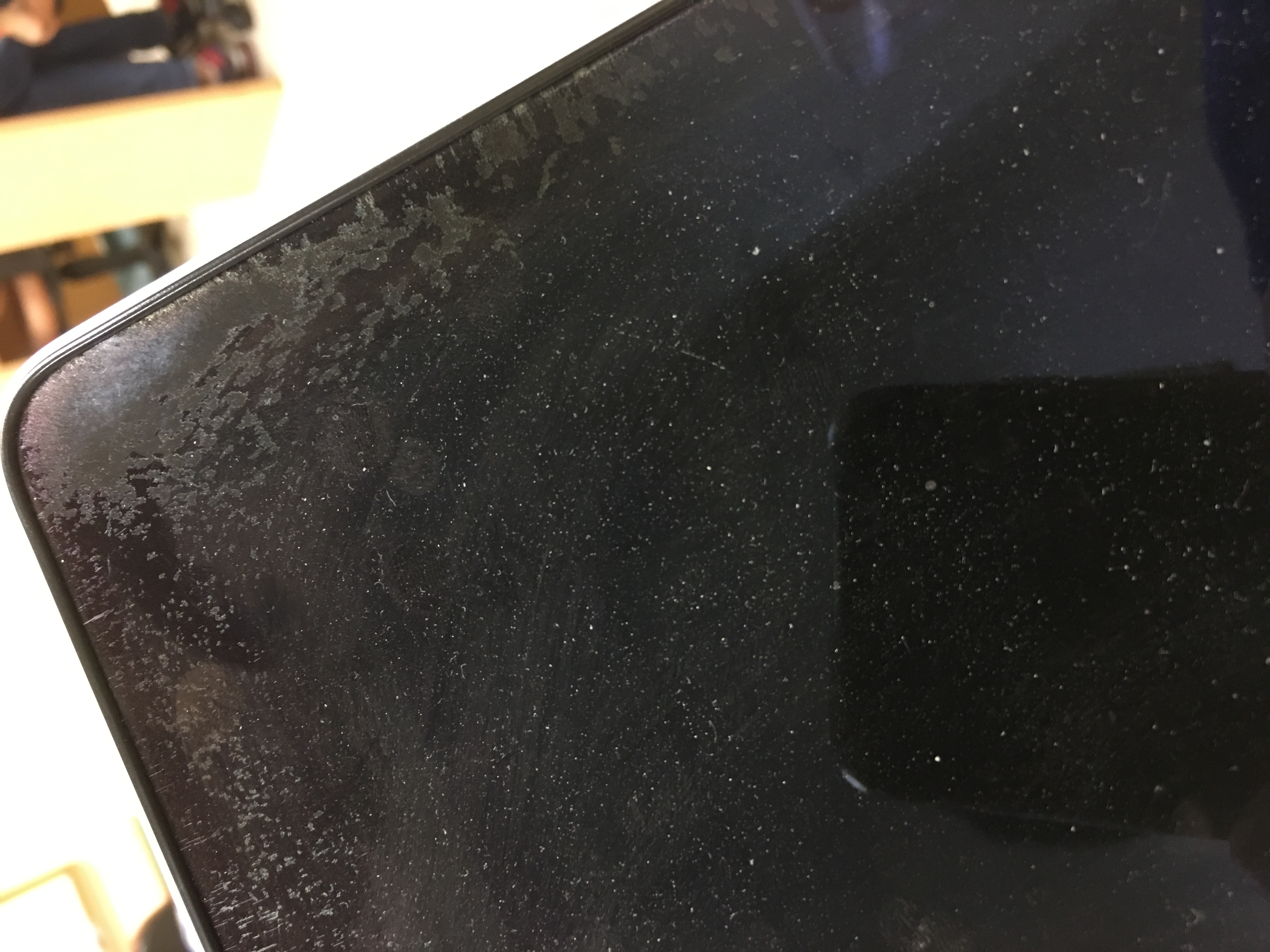

Just wondering is the corner considered as coating problem?

Absolutely should be, mine was a tiny bit around the webcam and yours is a bit worse than that.
Yes, that is the more serious portion of the screen.

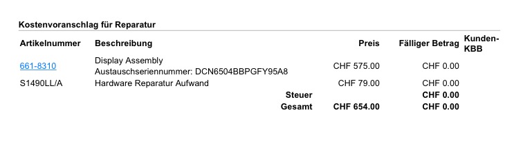

Just booked a Saturday morning appointment for the Genius Bar at Apple Store, Basel, Switzerland for my late 2013 15" MBPr it all started either side of the camera within a few months of purchase.. be nice if its repaired..wonder how long this will take?

After 2 cancelled appointments took my late 2013 15" Pro in to the Basel Store to show them Saturday morning, agreed the screen needed changing, checked had 3 in stock..by 10:30am Mail to say ready to collect.. fantastic service :apple:

I'd say I had patch the size of yours on either side of the camera. It wasn't big, but I knew right away what it was, as I had it about year earlier on 13" macbook pro... Worse come to worse you can on the spot show them how the damage gets larger - just take cloth and start wiping around existing damage like there's no tomorrow ;p

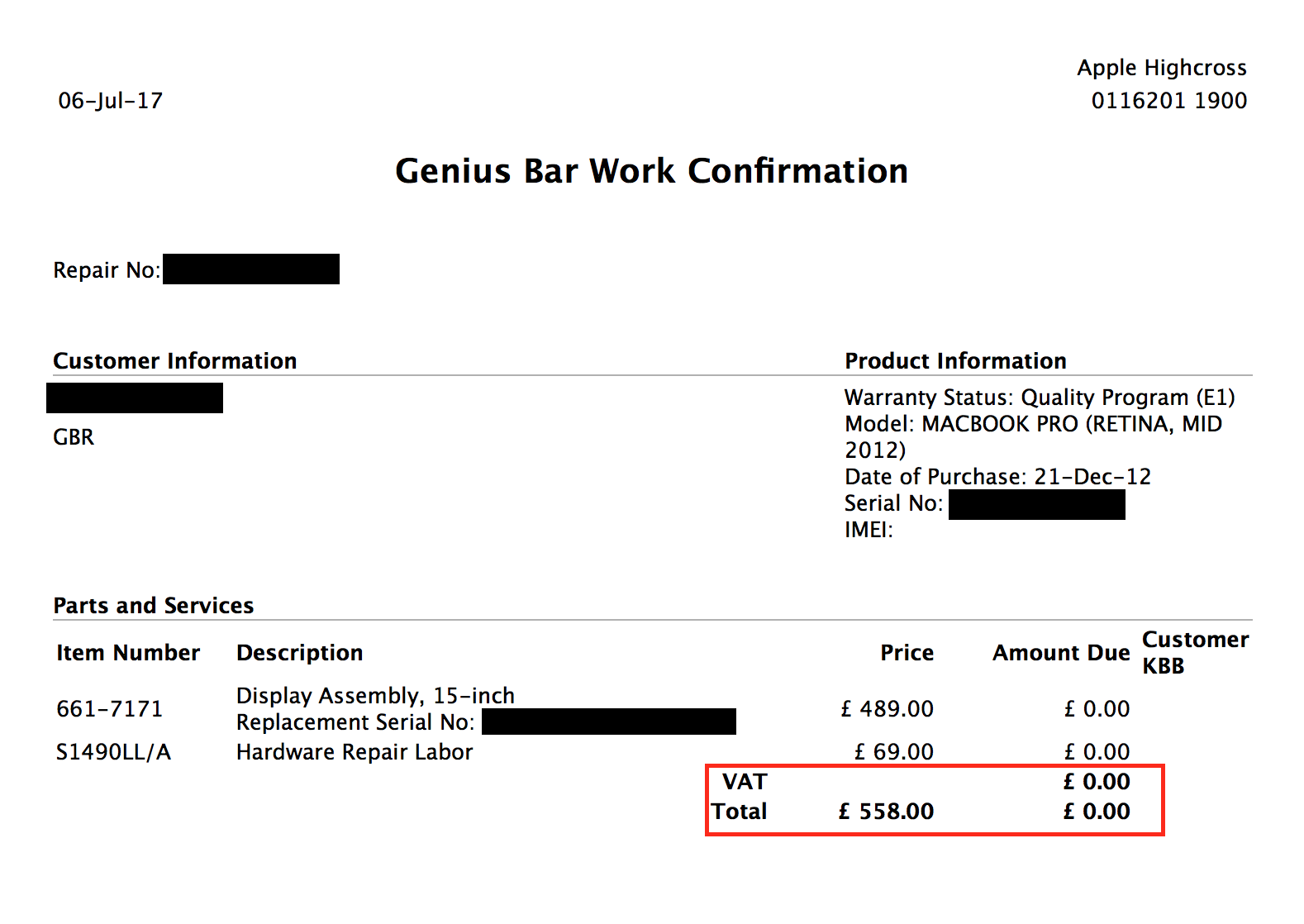

Took my 2012 15" Retina MacBook Pro into apple today at 4:30pm (Leicester - Highcross Apple store, England).
Within 30 seconds the Genius guy knew the problem and issued a free screen replacement worth £558, total cost to me £0.
Was ready for collection by 6pm same day.
My machine is 5 years old, no questions asked, no apple care cover needed, as soon as he saw it was the coating he knew what to do.
My friend also took his 2015 13" retina MacBook pro in at the same time and it was ready for 6pm same day as well, at no cost to him.
Well worth it, my 5 year old MBP feels new.
Oddly I asked what would stop this problem coming back again, in not so many words they said nothing... clearly there is a fault with the manufacturing process and they don't know what it is... hopefully be another 5 years till it goes - heres to wishful thinking.
