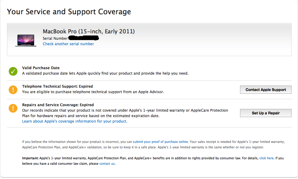

So mine isn't seem covered??
But according to the article it should be...?
I have had the issue and had it repaired under apple care but I've had all sorts of other issues...
What do others say??

The additional coverage doesn't show up there. The only reason Apple asks you to do that is to confirm that your laptop model is part of the program. Not very clear, I know. I too was expecting to see some indication on that page that I was eligible.

It's covered by the repair program, the relevant info on that page is that it's an early 2011 model.
