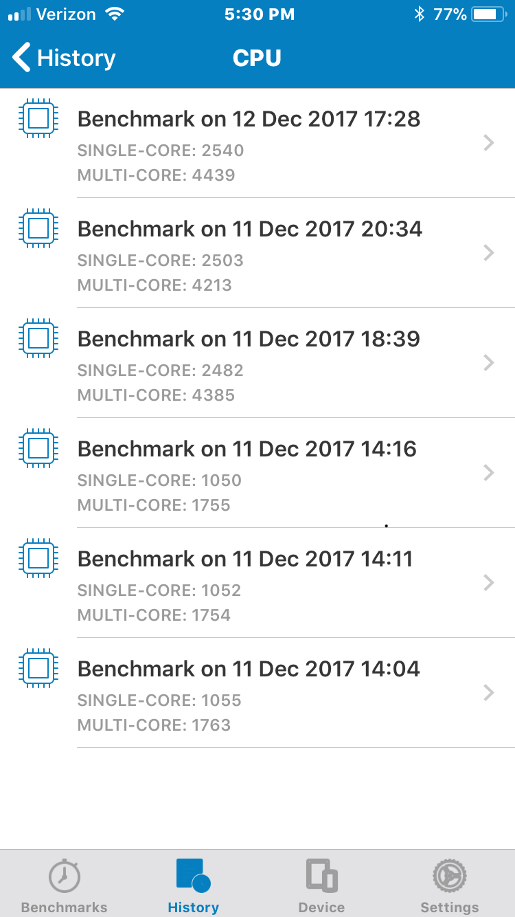

GeekBench has a history of your previous runs, perhaps you could post yesterdays speed test, and today's. I have a historic run in my history from my iphone 7+ I ran April 2017 at 12:52, even though I have an X now.

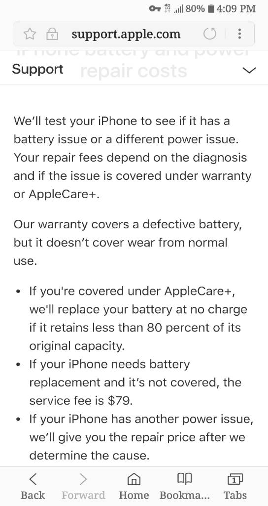

The wording here implies that they treat those with Applecare/Applecare+ the same as those without. If it retains less than 80%, they'll do it. If not, they won't.
They do not say anything about if you feel you need a replacement, you can pay for it. It says if it needs replacing, telling me they can dictate that without my input. They just indicate that you can change it if the test fails.

Even if you are out of warranty and their little test app indicates that the battery is within their "normal" parameters then even if you offer to pay they will not replace it.
So you would have to risk going to a 3rd party repair place or trying to do it yourself.

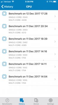

you mean this? lol Can you tell when I got my battery changed out?

Before I changed my battery yesterday, mine was benchmarking slower than a 5S
Did it feel slower? Mine didn’t. Nor did it feel faster after the swap.
yes it felt slower, laggy etc... the new battery made it feel like new phone to be absolutely honest.
