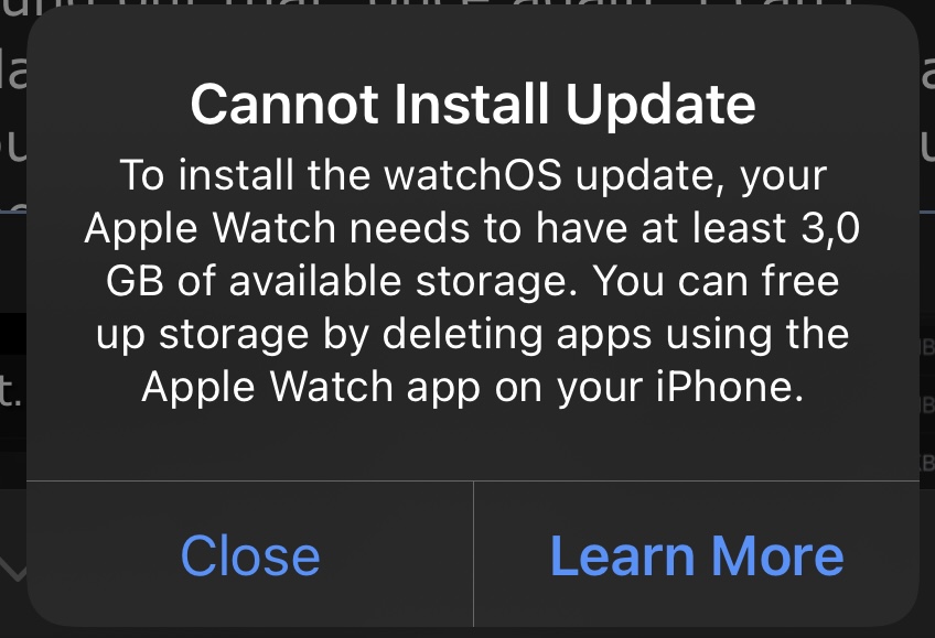

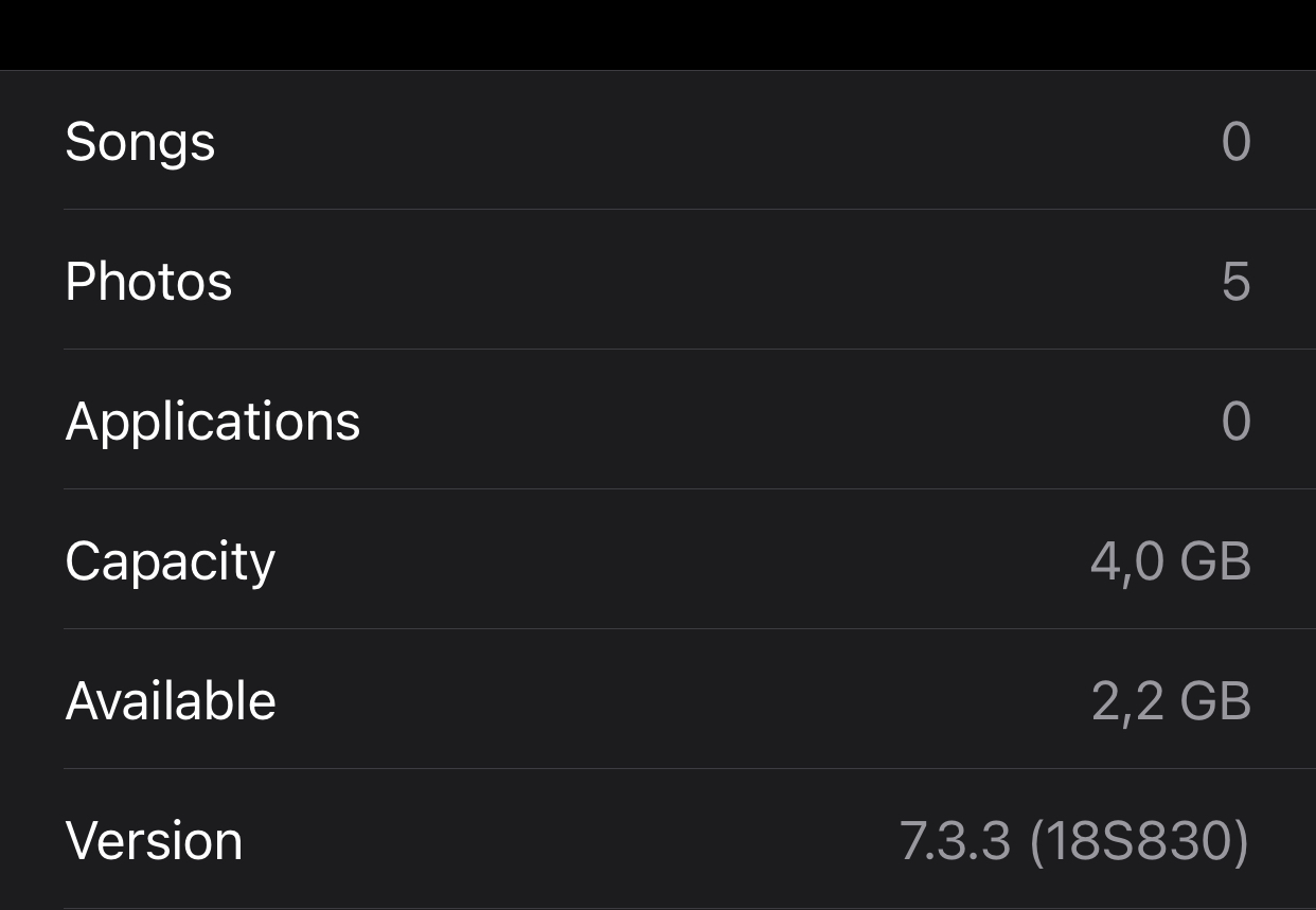

…I found out that, once again, I can’t update my watch because it doesn’t have enough space! What? How?! I’m seriously done with this thing. And at this point I’m not sure if erasing will help anymore.
Same here. Ridiculous that they can’t do better, again.
Apple is probably just trying to get the Series 3 through Watch OS7 and will drop support when Watch OS8 drops.. Series 4 would of been a much better choice for the base model as the S3 storage capacity obviously can't handle the size of each update and unpairing the watch and jumping through hoops just to get the update to load onto the device must be a very frustrating experience to deal with..
What the heck? Two months ago I was frustrated by the fact that I couldn’t do anything to update my Series 3 Watch. I had to erease everything and then it finally updated. Since then it spent all this time on the charger. I didn’t restore the backup, didn’t set anything up, it was just erased and updated because I knew new watchOS was coming and that I’d have to do that again.
Imagine how furious I am right now when I found out that, once again, I can’t update my watch because it doesn’t have enough space! What? How?! I’m seriously done with this thing. And at this point I’m not sure if erasing will help anymore.View attachment 1764468View attachment 1764469
The Apple site has a walkthrough. You have to unpair, re-pair and set up as new, update to new software. Then you have to unpair again and re-pair but this time use back up to restore it. It was a pain but I got mine updated.

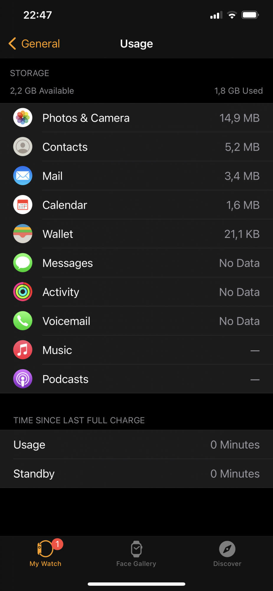

The fundamental issue is that the S3 barely has enough storage to accommodate the payload and the scratch space it needs to update, even when freshly reset. Each time the watch is reset, it has no more than about 3GB free, and oddly, says it has 15 phantom photos, even when never synced, or set to sync them.
