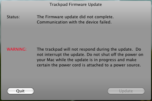

MMmm. weird..
Mine says:
The Firmware update did not complete.
Communication with the device failed.
This is a alu MBP, 2,4GHz..
When I try to install this firmware update it says "The Firmware update did not complete. Communication with the device failed."
I've tried installing 3 times. What am I doing wrong? The trackpad works. It seems to communicate enough for me to use it.
What's up?

MMmm. weird..
Mine says:
What's up?
Maybe try closing all open apps? I think that's what they advise you to do, but it didn't tell me to and mine installed perfectly. Haven't had one missed click since the install. 🙂
OK. I got it to work. I had an external Mouse and Keyboard attached with a USB hub. I unhooked everything except the power and it worked fine. Not sure what was causing the problem but it works if you remove all USB devices.
