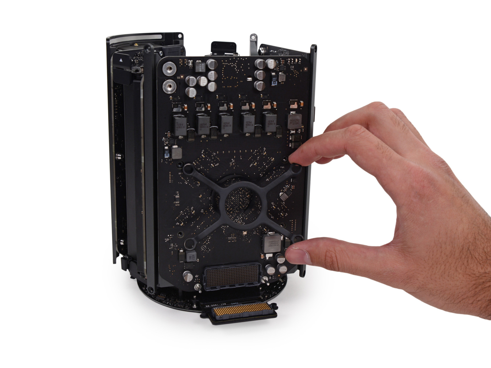

The video card isn't replaced by itself. The whole logic board (motherboard) is replaced because the GPU is soldered to it, and because it was fried by the tin whisker problem everyone's talking about.
Video cards on Mac Pro (Late 2013) are not soldered to logic boards, they are discrete cards connected to logic boards by flat cables.
TRRV1Ft1qnLGyX2X.huge
I sit corrected.
Okay, Apple can replace the card if it fries. But you can’t upgrade it yourself because it doesn’t use PCIe. So, one of the two problems remains (upgradability).
