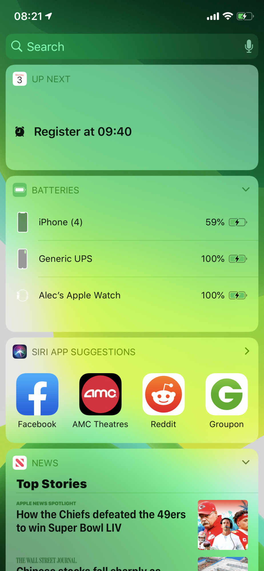

I have! It has been randomly not charging my iPhone. One time the replacement came up as "Generic UPS".

here’s a pic Btw of it happening;
Now it has done this multiple times since replacement and has on occasion at the same time drain my iPhone battery and the case will be 100% and it would be plugged in as well to my wall outlet.
It’s ridiculous..
It’s ridiculous..
