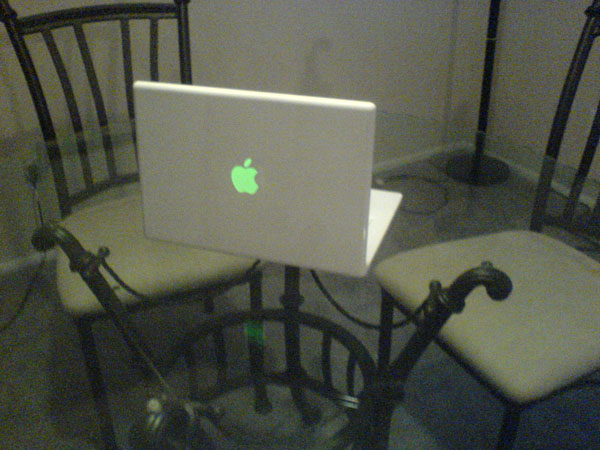

Well, I got it in today, and installed it. They say that the MacBook has the highest degree of difficulty, and while I haven't played around with the other models, this one wasn't too bad. I just took my time and was careful. The hardest part was cutting away the white area behind the screen. It took about 30 minutes or so for a complete n00b. I could likely do it in half that time now.
I decided that it looked better with the entire white part cut out (yielding a brighter green), but now there is a little bit of "light bleed" barely visible in the night pic. I may go back in sometime and fix it, but it's fine for now.
Sorry for the noisy phone cam pics.

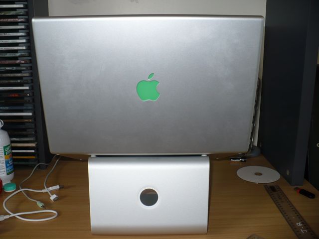

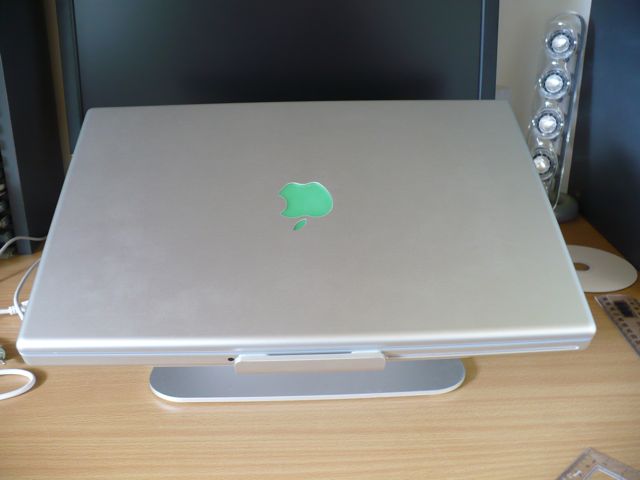

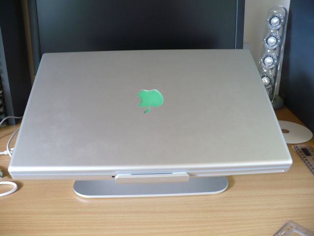

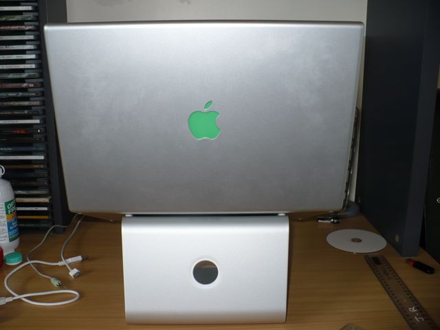

I've been wanting to do this ever since I got my SR MBP, & since it was outa Applecare in about July this year I decided now was a good time. I just hacked up a clear green plastic folder & taped it to the inside of the casing. I wanted to make it orange but I couldn't find any orange folders at the shop so bought green.
I kinda damaged my casing a bit in the process of removing the lid, & it took me more than half an hour- but I think it's worth it! 😀
