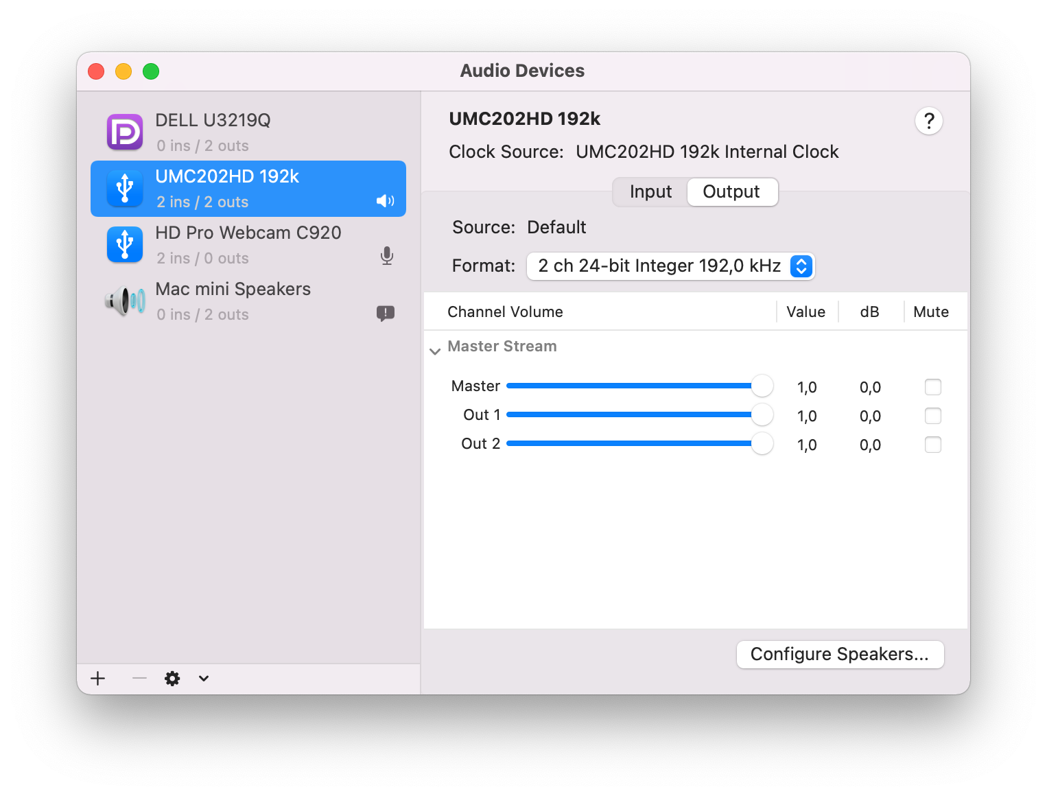

1) Check that macOS is sending max sample and bit rate that your DAC supports from Audio MIDI Setup:

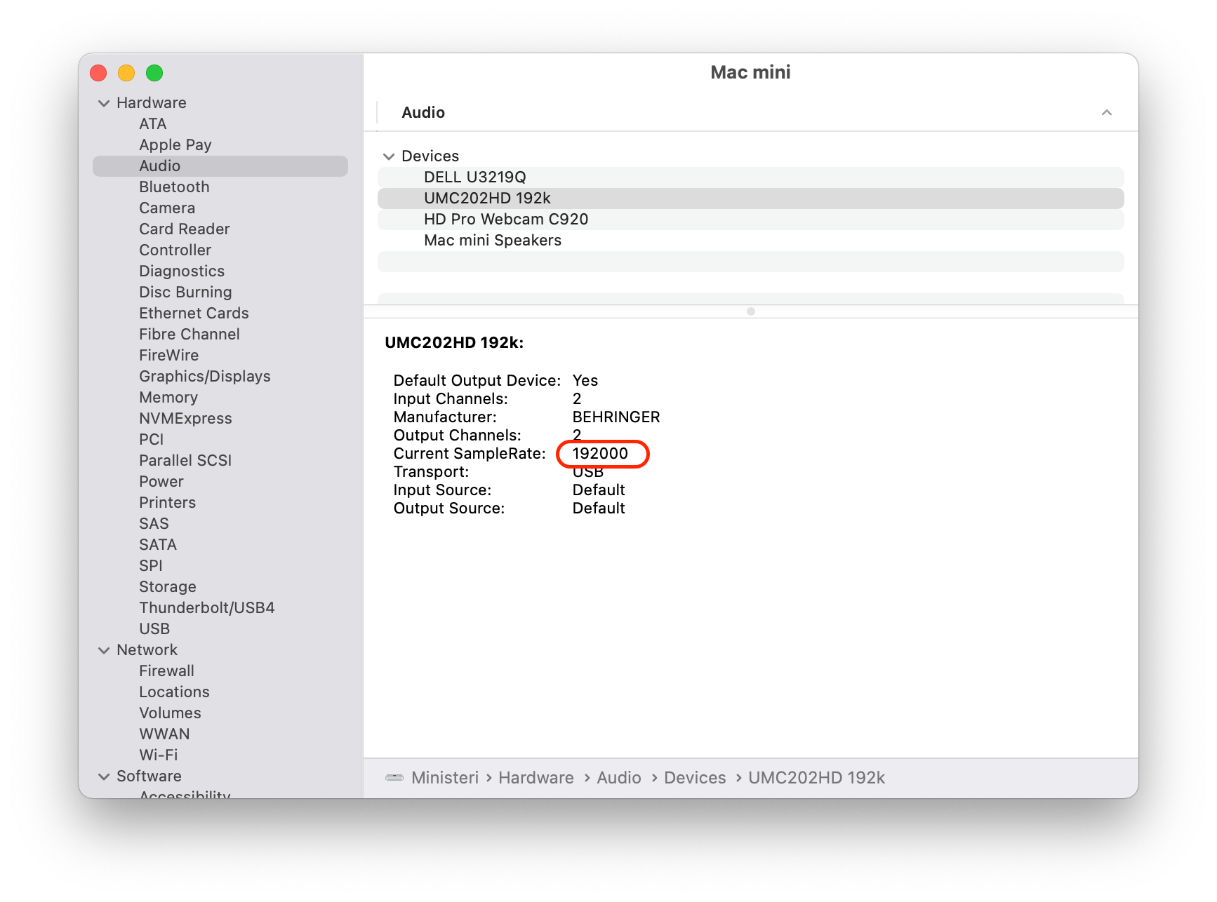

2) You can validate the result from System Information:

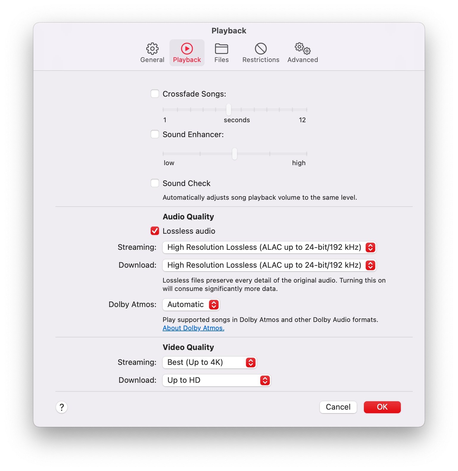

3) Enable lossless in Apple Music preferences:

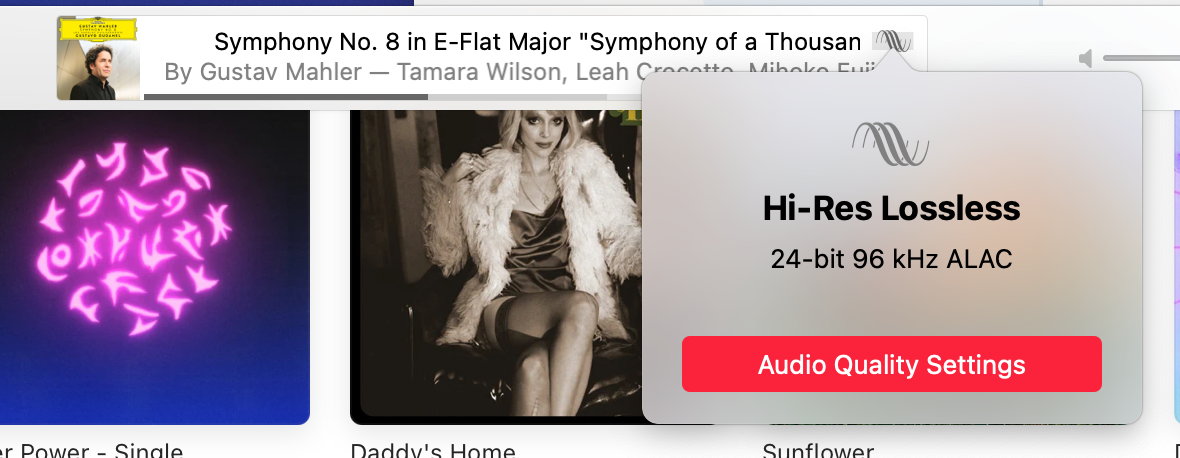

4) Verify that it is actually playing back lossless version:
Or by selecting track "Get Info":
