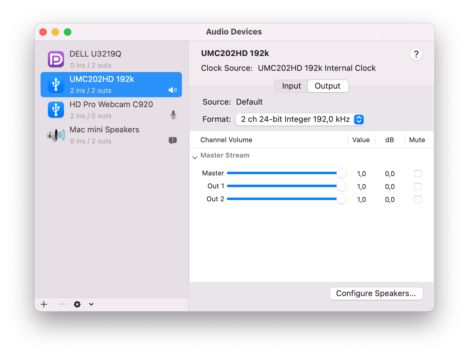

1) Check that macOS is sending max sample and bit rate that your DAC supports from Audio MIDI Setup:

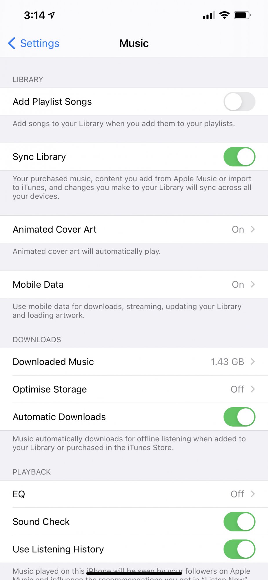

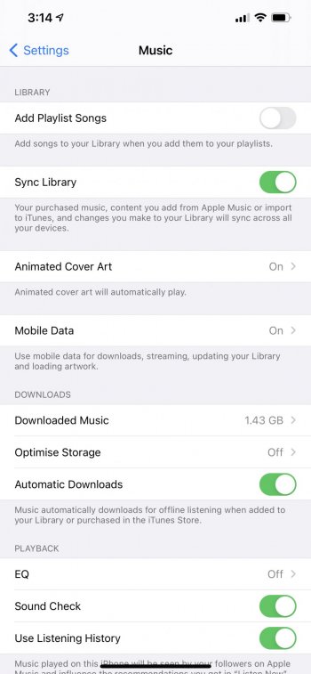

My menu for Music Settings on the iPhone looks different than the one in the main article
Is this normal?

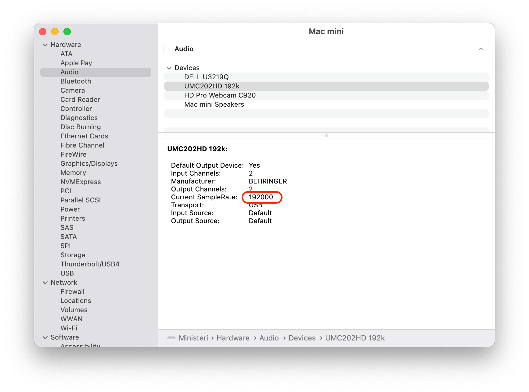

2) You can validate the result from System Information:

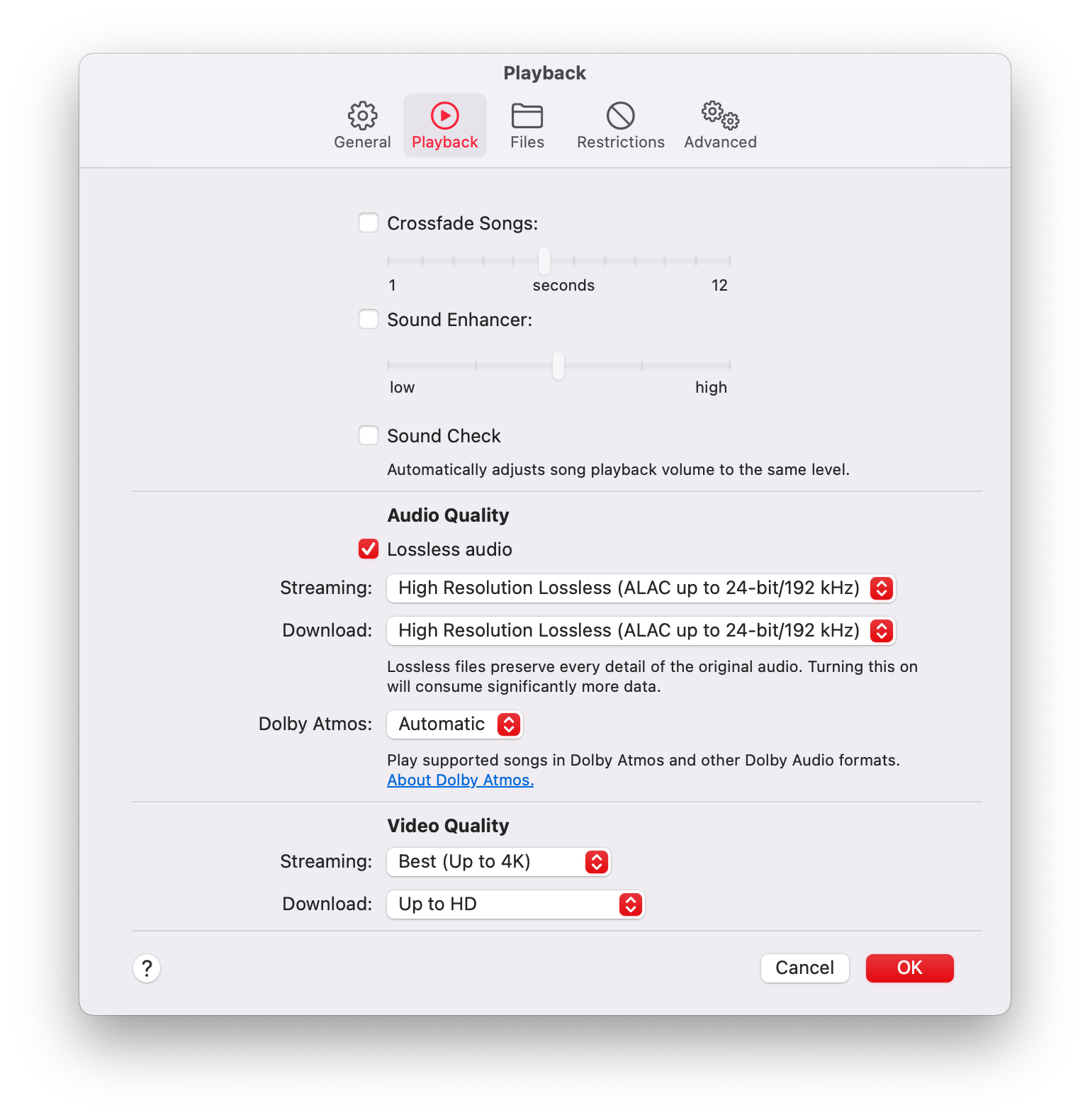

3) Enable lossless in Apple Music preferences:

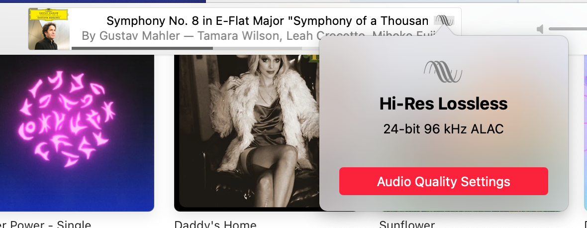

4) Verify that it is actually playing back lossless version:

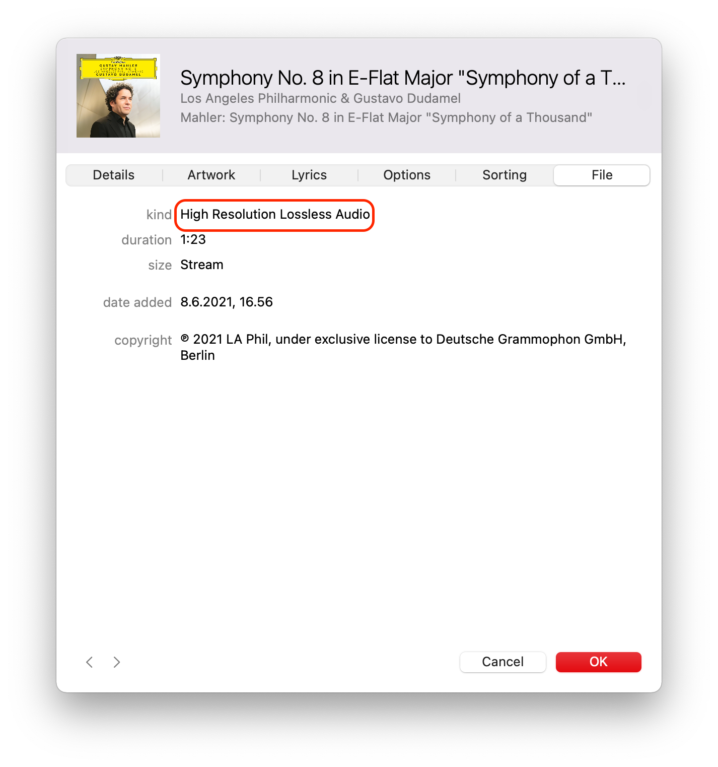

Or by selecting track "Get Info":

Thanks for posting this, but can I ask a question? What is your DAC showing when you play an "Apple Lossless" track (i.e. something that is not "Apple Hi-Res Lossless", and therefore no more than 44.1kHz or 48kHz)? Is it still showing an incoming stream of 192kHz/24bit? If so, you are not receiving a bit-perfect stream, and Apple's Audio MIDI is merely re-sampling - and you have no way of knowing the bit-rate or bit-depth of the song that is actually coming in to your Mac from the Internet.
Is this normal?
PS: I still don't have access to Dolby Atmos; based in the UK
Make sure you are on iOS 14.6 first, and try toggling the cellular data and automatic download switches on and off a bunch of times; that forced it for me.
Reactions: Chomp81
Is this normal?
I am in the UK and now have the option. I restarted my phone - nothing - went into Music and then back into settings and the option appeared.
