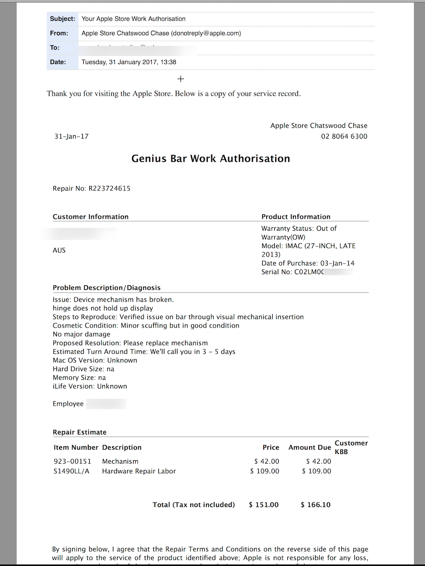

[doublepost=1485942404][/doublepost]Just a heads up if you live in Australia & have the hinge snap on your Imac Late 2013 27"
DON"T go to the Apple Store Chatswood Chase !!
Mine popped a few weeks ago ...heard a loud "snap" while in another room ..sounded like someone had thrown a stone @ my window!!
So I called Apple & my AppleCare had just expired and first appt available was on the 31st Jan.
When I brought up the fact that it is now common knowledge at Apple about this issue & Quoted the first post here:
In September, Apple extended its related iMac hinge repair program to cover late 2012 and late 2013 iMacs for up to five years from the date of their original purchase, compared to an original three-year period. Apple will replace the hinge mechanism on affected iMacs at no charge, regardless of warranty coverage.
Unlike some of Apple's other Exchange and Repair Extension Programs listed on its website, the details of this program have not been made publicly available. Apple has instead sent internal communication to Apple Authorized Service Providers with information about repairs and refunds.
The Genius went to consult the Store Manager/"Task Officer" [ whatever hipster title they bestow upon themselves ]
She returned to tell me basically his reply was it's Tough Luck mate ! Pony up or live with a floppy screen >:<
Having said that the staff [except the Store Manager] are very helpful & the repair was done within 24 hrs.
