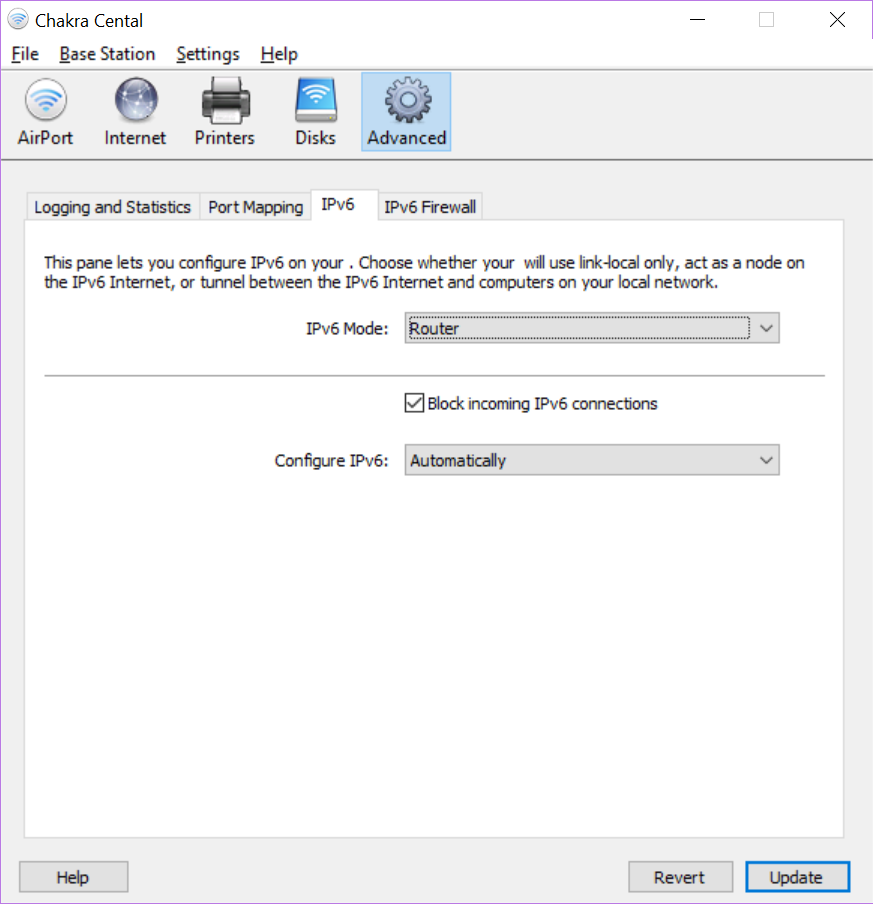

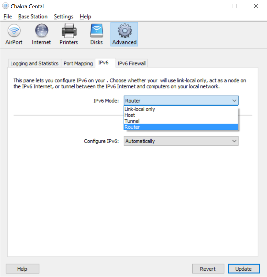

Hi guys/gals,
I just updated but I'm curious what settings should I select after using "link-local only" to by-pass the drop connections?The options I have are "Host", "Tunnel", and "Router for IPv6 Mode.
Also, there's a setting to "Block incoming IPv6 connections" should I leave it checked or unchecked?
Thanks

If you had it set to Link Local Only, you'll want to open AirPort Utility, select the base station, hit edit, select the Internet Tab, select Internet Options, and change Configure IPv6 to Automatically. Hit Save, Update, and Continue. You're all set!
It's odd, I don't have the option to select "automatic" just the options "Host", "Tunnel", and "Router". I'm running windows 10 with Airport Utility.
Oh ok. So that means you're running AirPort Utility 5. Do you have an iPhone or iPad by any chance (they can use AirPort Utility 6)? If you do, you can download AirPort Utility for free from the App Store. When you open the app, if there is a prompt that says Enter Password, select that and enter your password (likely your Wi-Fi password). You should then see an Edit button in the top right corner. Tap on that, select Advanced at the bottom, then select IPv6. Here you should have the selection that says Configure IPv6. Change that back to Automatically.
If you don't have an iPhone or iPad, I'll have to look up the settings for AirPort Utility 5 because I don't remember them off hand.
Here are my options:
And should I uncheck the "Block incoming IPv6 connections"?
