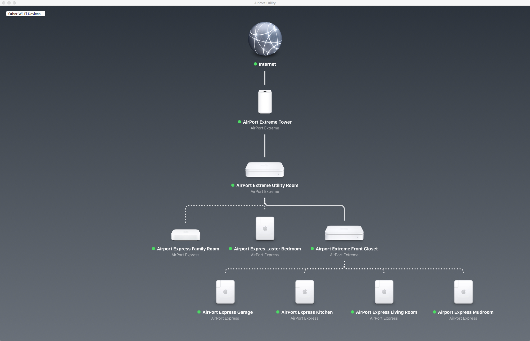

Just ran through and updated my network in about 45 minutes. I did it sequentially, starting with the AEXPs and finished with the tower. Everything seems to be working ok. I have been having a LOT of trouble with my network ever since I had to replace one of my earlier generation Airport Extremes with a Tower. Tons of instability in my network. So much so that I reset each and every device to default settings and re-built my network from scratch (I live in an ICF home with concrete walls/floors, in-floor heating tubes, no ethernet cabling, and Apple TVs in three different locations so my wireless coverage is complex to say the least). It worked great with the old Airport Extreme but it fried itself. The Tower has resulted in a need to reboot Airport Extremes, Expresses, and the Apple TVs multiple times a week. I'm hoping this will help address that. The update itself was easy peasy.
