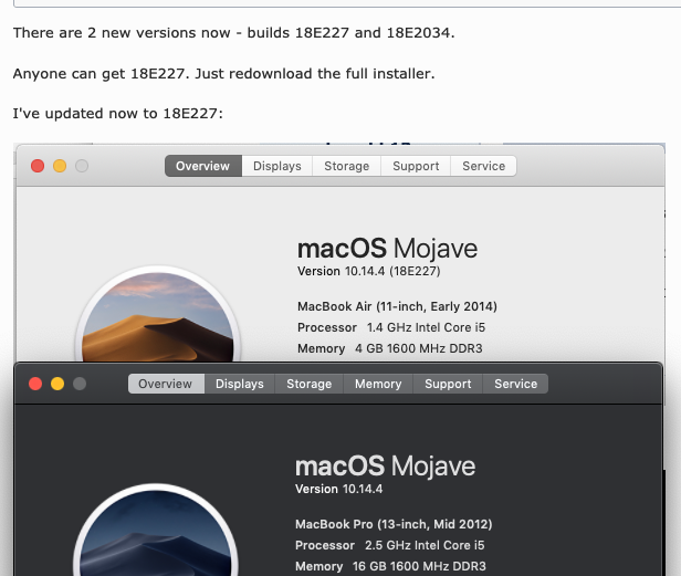

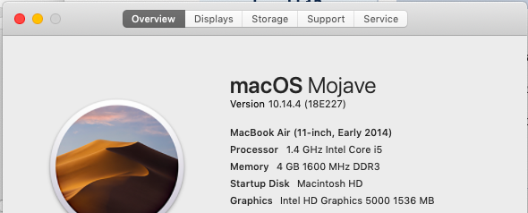

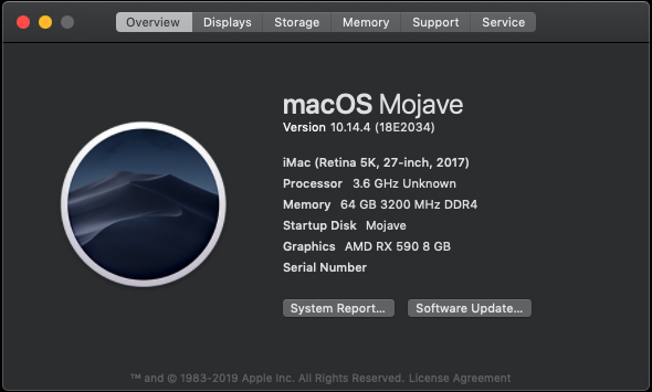

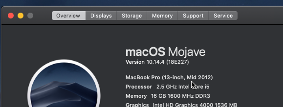

There are 2 new versions now - builds 18E227 and 18E2034.
Anyone can get 18E227. Just redownload the full installer.
I've updated now to 18E227:
You can only get 18E2034 however if you have a newer computer, eg., 2017 imac:
Reactions: camelia
