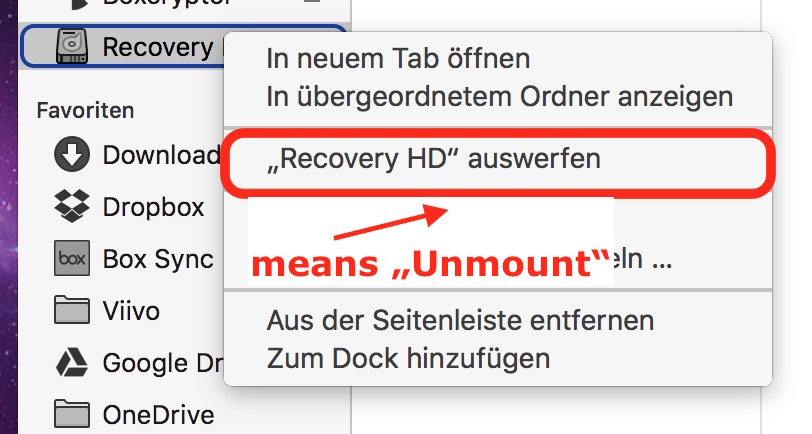

Could I use instead of diskutil unmount /dev/disk0s3
also the unmount in Finder or is the terminal better?

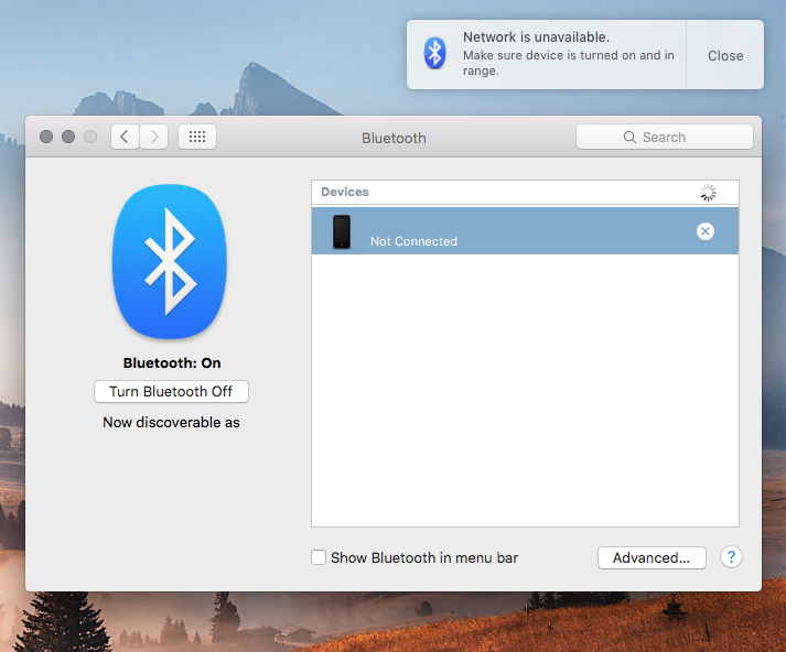

iPhone should be discoverable, for example, to mirror the screen, to use iPhone as controller, and in numerous other apps, such as Infuse https://itunes.apple.com/app/id577130046, which has Bluetooth sharing to iOS devices. The problem is, iPhone isn’t discoverable:
iPhone is on, Bluetooth enabled, with Mac on table
I hear you & had been trying to pair them myself ages ago & saw what you see. Initially it seems like they will pair but then don't. I still think its due to protocol support and you won't be able to make it work unless Apple changes the behaviour.
As for mirroring, its a paid app but these guys have a solution : http://www.airsquirrels.com/reflector/
