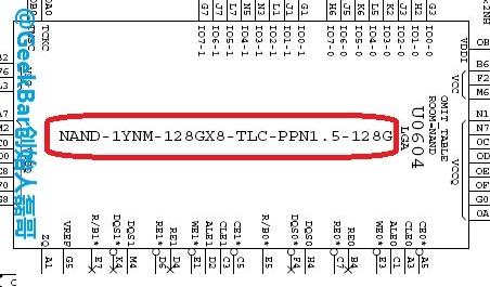

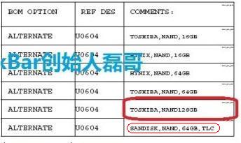

Actually, there is. Remember the circuit diagram leaks, such as the one that let us figure out the existence of the barometric sensor? There was also this leak, which showed various chip suppliers:
Notice that the 64GB model could be MLC or TLC.
The diagram also showed a 128GB TLC PPN (Apple's Perfect Page New) chip in place:
This jibes with other rumors that the problems can occur on 64GB models as well, if they contained Sandisk TLC NAND instead of Hynix MLC NAND. (Assuming that TLC is the reboot problem in the first place. It very well might not be.)

That's true if we assume that the TLC NAND is raw, without an error correcting controller. We do not know that, because we haven't seen the part numbers for the 128GB phones yet.
In other words, unless Apple had two versions of boards, there is no way to host different memory type in different models. For some obvious reason, it's ultimately stupid to maintain two versions of board.
Right, if it was raw memory, then there'd need to be two versions of boards. Which is not as "stupid" as it sounds. Apple has made up to eight versions of each iPhone now to accommodate various radio needs around the world. And that's without taking into consideration color and memory variations.
However, because of the schematic above, it seems most likely that any TLC chips being used are pin and interface compatible with the MLC chips.
