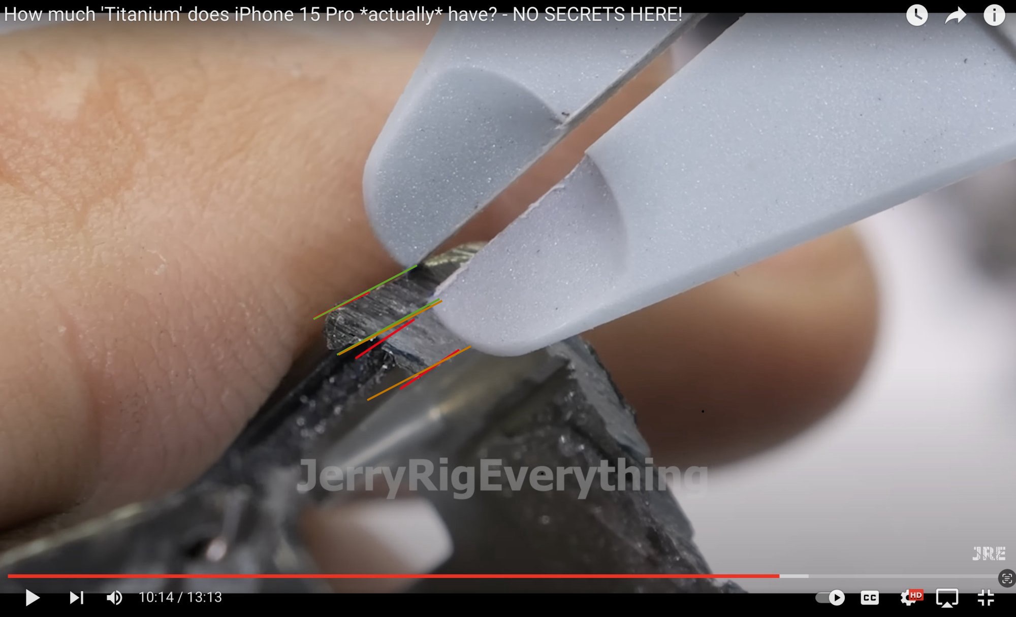

But somehow the cut didn't bend the aluminum to make it look thicker? Nice trick you've got there.
The cut wasn’t straight. If you notice in your screenshot, the entire bottom of the frame is missing from the left edge. So, yes, only the metal present, titanium, was bent at the edge.
I’ve corrected your screenshot with properly aligned, parallel lines (green and orange lines).
Yeah you changed the angle to be wrong. Whatever. Enjoy. 🤦‍♂️
Doesn't matter, the frame isn't touching the SoC, it isn't dissipating the heat (like a heatsink or vapour chamber).
