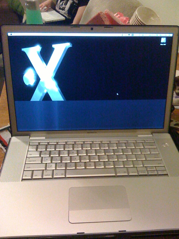

I am experiencing problems like whoa with what I am guessing is the GPU. Pretty much everytime I boot up from sleep or being off for a while the bottom fourth of my screen is absent as in the attached pic. I took it to an apple warranty repair shop in which case the dude reset the PRAM confident that would fix the issue, yea no. I guess I will go back tomorrow. I have had the scrambled screen like others but this is just insane, 1/4 of my screen is kind of important.😛
System Overview:
Model Name: MacBook Pro
Model Identifier: MacBookPro3,1
Processor Name: Intel Core 2 Duo
Processor Speed: 2.2 GHz
Number Of Processors: 1
Total Number Of Cores: 2
L2 Cache: 4 MB
Memory: 4 GB
Bus Speed: 800 MHz
Boot ROM Version: MBP31.0070.B07
SMC Version: 1.16f8
Serial Number: W8741DWMX91
Sudden Motion Sensor:
State: Enabled
Graphics:
GeForce 8600M GT:
Chipset Model: GeForce 8600M GT
Type: Display
Bus: PCIe
PCIe Lane Width: x16
VRAM (Total): 128 MB
Vendor: NVIDIA (0x10de)
Device ID: 0x0407
Revision ID: 0x00a1
ROM Revision: 3175
Displays:
Color LCD:
Display Type: LCD
Resolution: 1440 x 900
Depth: 32-bit Color
Built-In: Yes
Core Image: Hardware Accelerated
Main Display: Yes
Mirror: Off
Online: Yes
Quartz Extreme: Supported
Display Connector:
Status: No display connected

Does anyone know if the vertical striping problem is related to the faulty graphics chips or if it is a software issue?
The vertical stripes are another issue entirely, and there is little agreement on whether it's a software or hardware problem.
