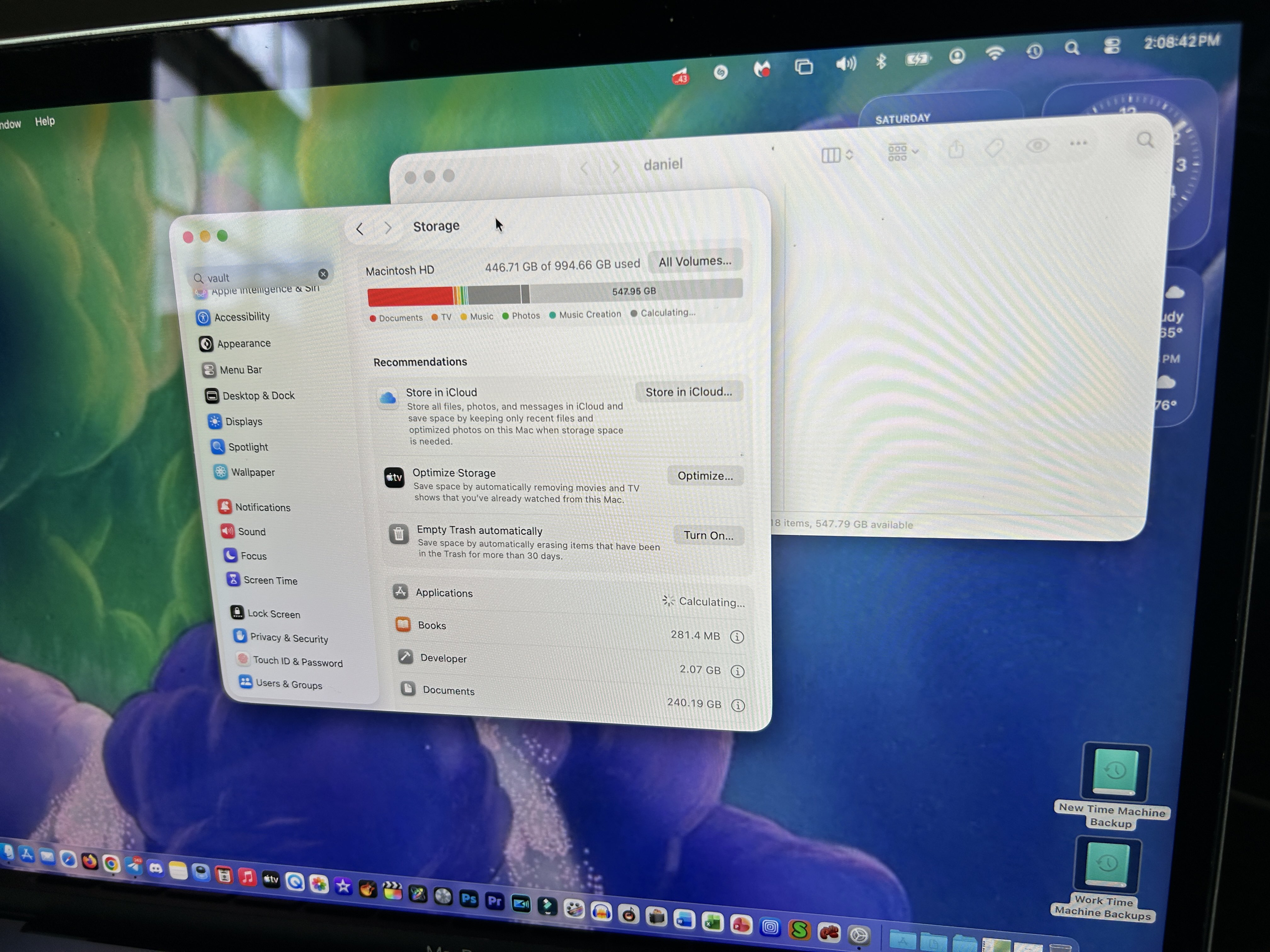

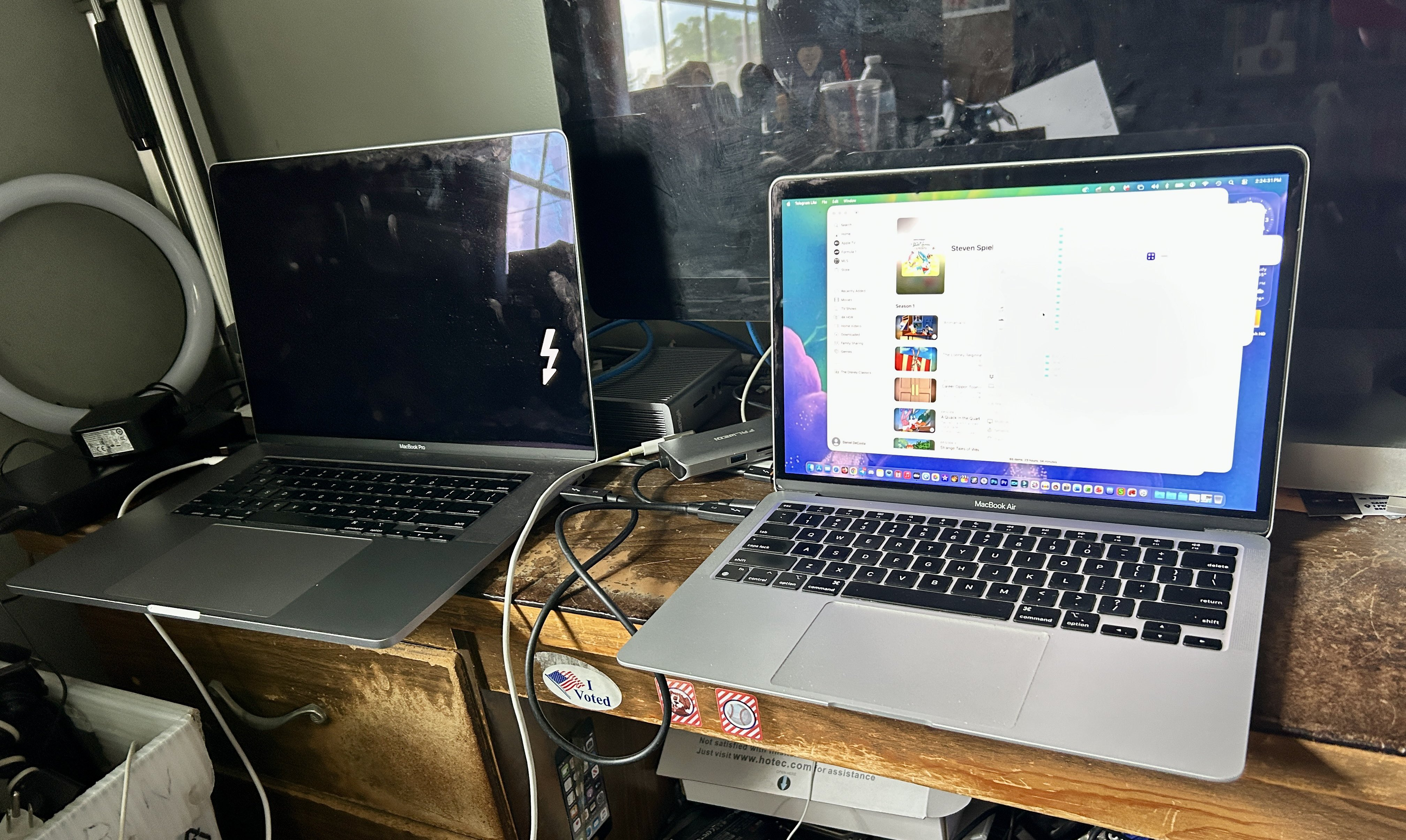

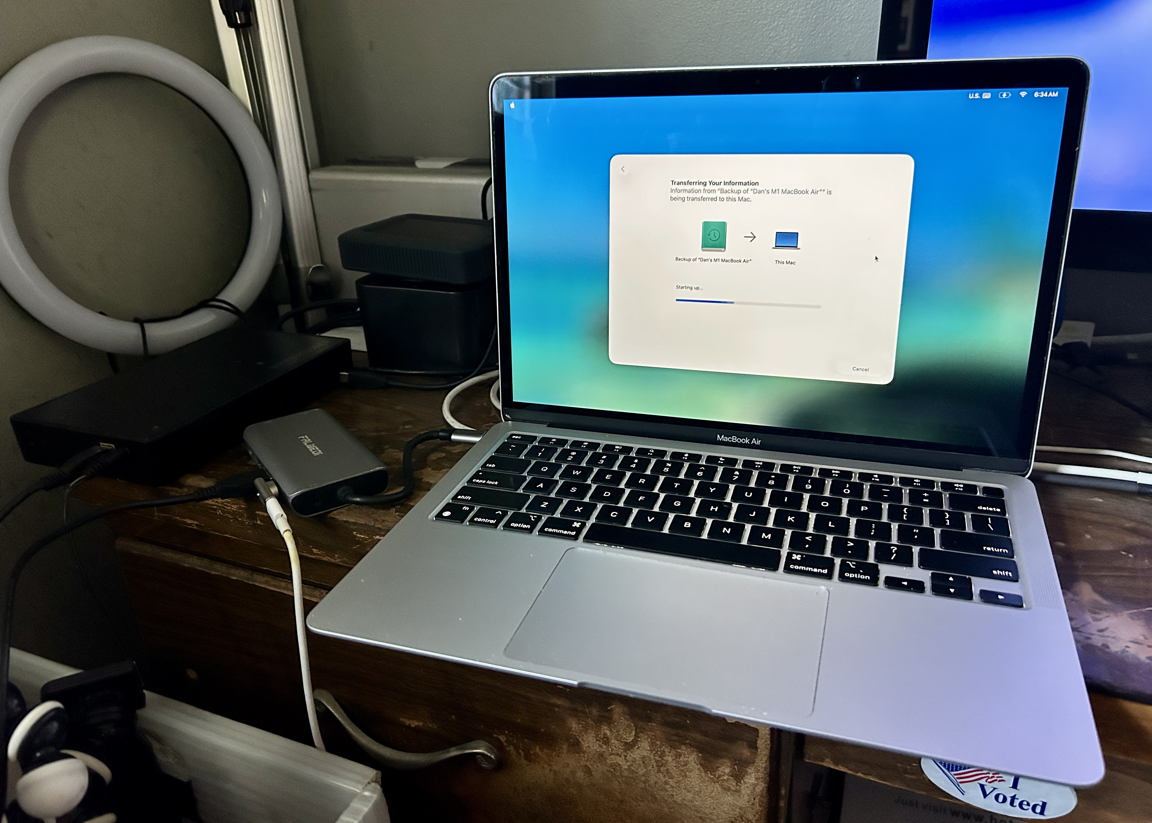

Well, last Friday I placed the order and had my M1 MacBook Air shipped to L2 Computer Inc. (but of course I did a Time Machine backup before packing the Air), and it came back today with a nice big 1 TB SSD!
Restoring the Time Machine backup, first things first. They even fixed the peeling bezel gasket for no extra charge!
I gotta say, including the shipping and tax costs, this was $400 well spent!
Now I'm copying over any new or modified files on my "backup" Mac (my 2019 Intel 16" MacBook Pro) to the M1 Air's new 1-TB SSD via Target Disk Mode! It'll be good to do productive audiovisual work on the MacBook Air again, as that 2019 MacBook Pro did feel noticeably slower in comparison (even with a 2.6 GHz 6-core i7 processor, 32 GB of RAM and an AMD Radeon Pro 5300M GPU with 4 GB dedicated VRAM, compared to the M1 Air having 8-core graphics and 16 GB of RAM).
