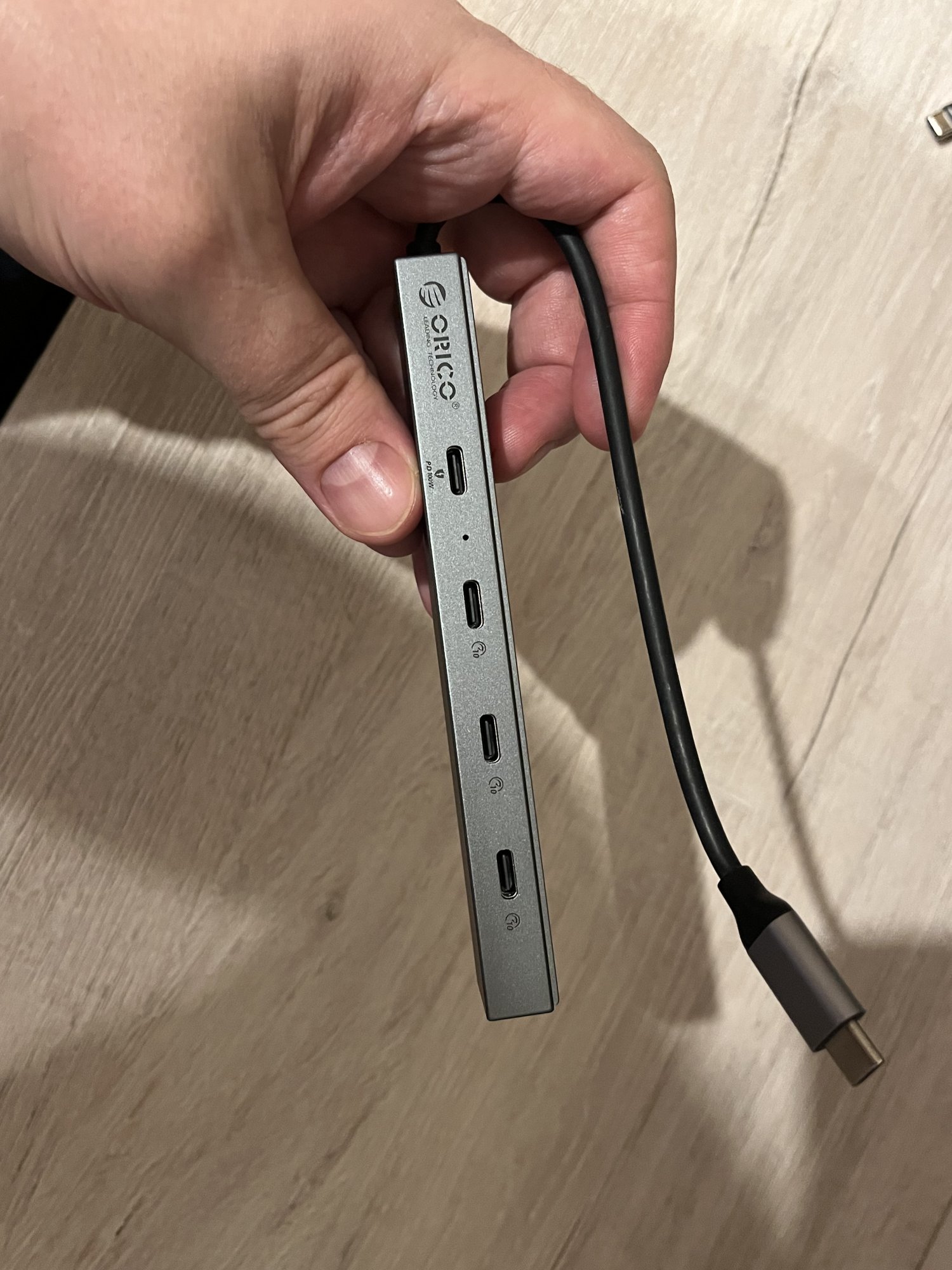

hello everyone!
I've just purchased ASD for my Macbook Air M1.
I have a not trivial question about PowerDelivery.
Before starting to use ASD i used alluminium Orico 4-1 10Gb USB Type-C Hub with PD port.
So i connected PD port of hub with Macbook Charger, connected all my devices to other ports of hub and then used 1 cable connection to one of the Macbook ports. My macbook was powered by this 1 cable connection.
Now with ASD i have connected Thunderbolt cable from ASD to Macbook and it also gives PowerDelivery.
I need to use all my devices and some of them need extra power supply.. One of the divices always disconnects without PD connected to the hub.
So the question.. If my macbook is already Powerdelivered, can i use 2nd Macbook Air port for the Hub which also will be powered from macbook charger in to PD port?
Is it safe? Will it work?
Won't my laptop overpowered?
2nd question is maybe even crazier, but....
can i connect this Orico Hub to Apple studio display USB-C port while the Orico Hub is connected with Macbook charger to PD port

i have one that have 3 usb-c inputs and one pd input.
when i used my mac without Apple Studio Display i used one cable connection to my mac.
this hub was charging my laptop
but now my laptop already gets power from the apple studio display
is it ok to use them simultaneously?
both of them transmit charging
my 2nd question was about...
i still charging my laptop from ASD, but i want to connect this hub to one of usb-c on ASD back..
is it ok if it hub will be powered by macbook charger?
i need this because one device connected to the hub don't getting enought of power supply

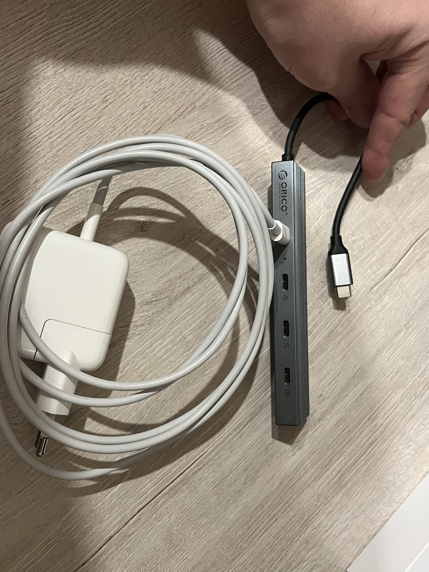

Have you tried it with only power from the ASD, so you know it does not work?
I am pretty confident you won’t have any problems using the power supply if the hub is from a reputable company. (I’ve bought a few Orico products, they have all been solid.)
One of these:
first link is broken
I am pretty sure I have even had them both connected at the same time as the ASD, as well as a hard drive enclosure that also provides power.
ok. thanks. so technically i can connect both ASD & my Orico Hub powered by apple 40w charger at the same time.
right? nothing will be damaged and macbook will take as much power as it need?

It might help if you post a photo of your setup. Are you using any USB-A to C adapter?
I had a look at the RME Babyface Pro specs, it looks like it has its own power source from DC so it shouldn't need any additional power from the USB port.
Reactions: Arctic Moose
i already posted photo of my hub here
my setup is Macbook Air M1 + Apple Studio Display + RME BabyFace Pro + 2 different midi controllers (Korg NanoKontrol + Sensel Morph)

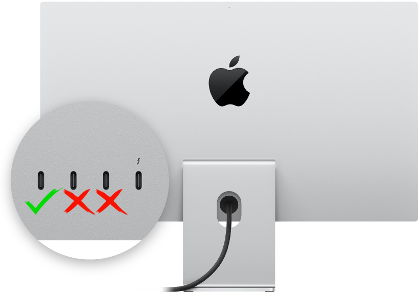

Looks like my question with soundcard disconnections was sorted..
I changed a USB-C port on ASD.
Looks like it has more priority, i don't know.. But for now no disconnects for a week, even if im using all ports and even with connected 10Gb/s SSD enclosure. Everything connected directly to ASD and i still can use one cable connection
